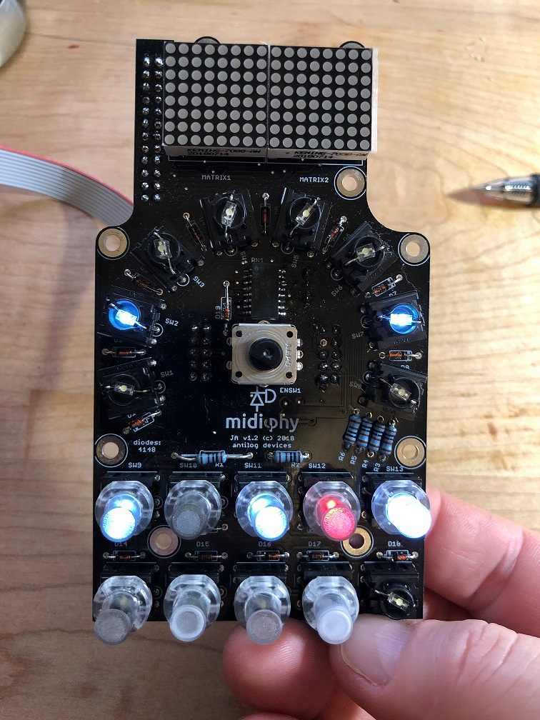

Well I replaced all the ICs on the JA board and the problem is less but still there.  Now if I hold my finger on some of the pads on the back, the leds light up. I tried my other waveshare board and it’s the same behavior. Attached a picture.  Maybe I just order a new PCB and the specialized parts. Fingers crossed I didn’t damage the main uCore board
this results in the picture above? It’s not too surprising if so, as the static from your hands can toggle the CMOS gates. That’s typically not the best way to control 74HC logic though – the static can also damage ICs.
A picture of the rear would also be helpful.

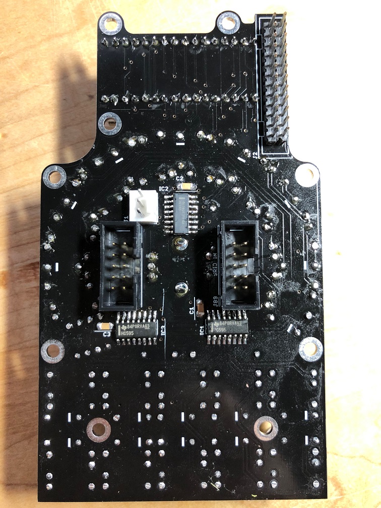

I usually solder THT components from the bottom out of habit. Attached a picture below of back.
To me, the board would benefit from reflowing all pads, maybe with a bit more heat, perhaps cleaning the flux off especially around the ICs.
