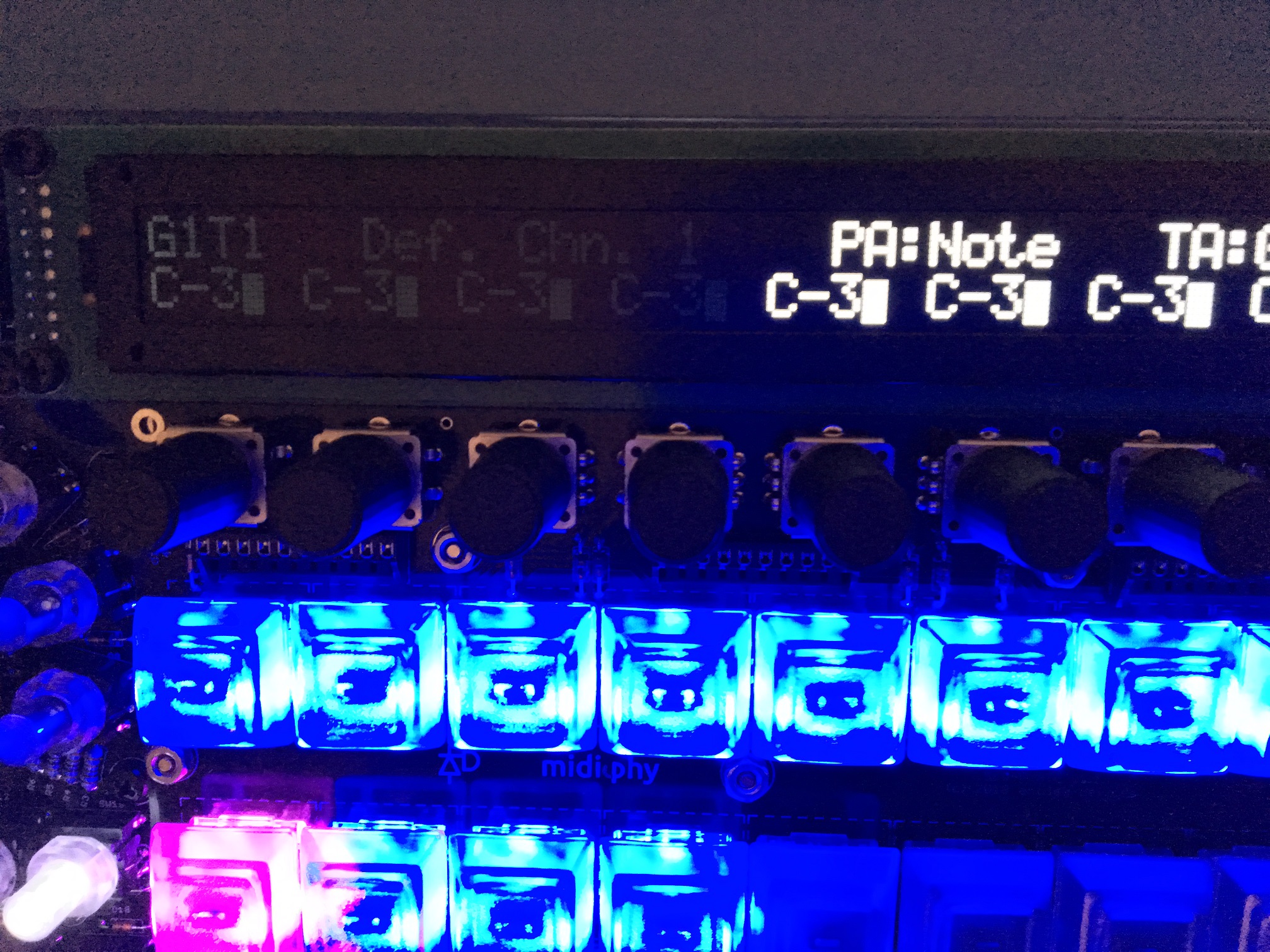

hi all,
finally i could go on with the build. after all the testing looks promising and i managed to upload the seq app i now have some strange behaviour when starting up. did a short video to demonstrate whats going on.
https://www.dropbox.com/s/me76qsg77vcayf4/VIDEO0148.mp4?dl=0
the app seems to work but there is something wrong with the oled-displays in conjunction with the buttons. i have tested the ja-board and the le-mec boards. all buttons, encoders and leds work properly.
i also interchanged the displays and corresponding cables with the same result.
could anybody please give me a hand?
thank you

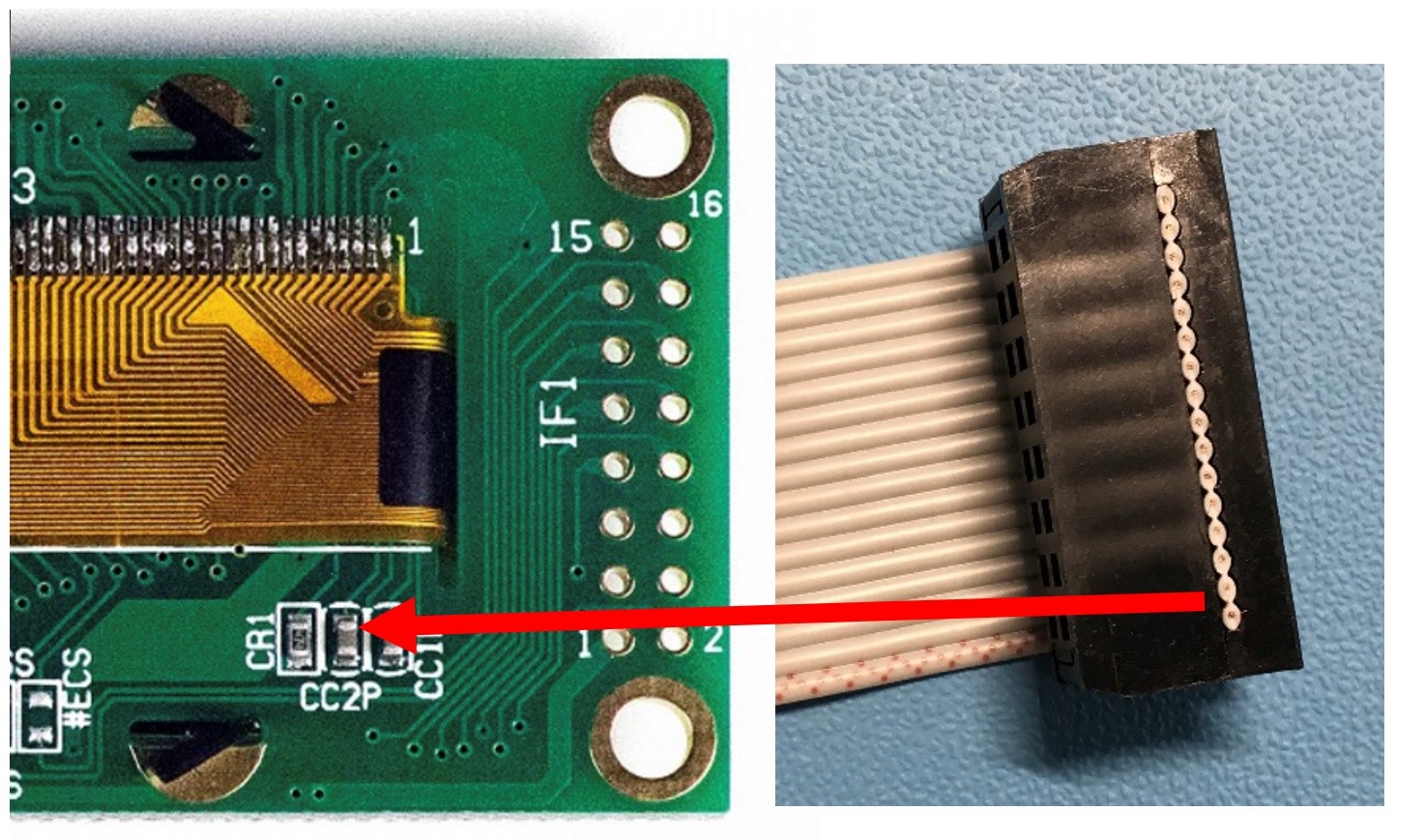

Here is the problem my OLED had:
It took some time to find out the real problem. First I thought it was a problem with the OLED PCB, because slightly twisting it on the left side got the display fully working. And of course I testet the header, connector and cable twice before.
So here is the problem:
The unisolated end of the flat cable had contact with a capacitor on the OLED PCB. I prepared a picture showing it a bit clearer:
I think this problem could happen to everyone and the solution is to use a bit of isolating tape between the connector and the PCB, especially the three components the arrow is pointing at in the picture above.
Great that you found the solution!
The mounting is very tight indeed, and insulation seems like a very good idea.

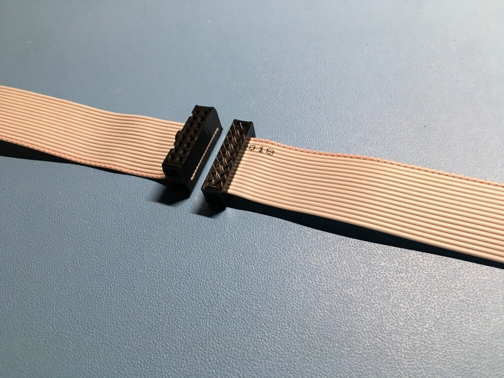

I wonder if it’s better to rather mount the IDC directly to the OLED, for instance using:
HIF2E-14D-2.54RB(20)
(only 14 pins, but it would work, as the backlight is not required. HIF2E-16D-2.54RB(20) is not in stock at Mouser, but could be ordered. There’s also the RA type (grey colour I think)
https://www.mouser.de/ProductDetail/Hirose-Connector/HIF2E-14D-254RB20?qs=sGAEpiMZZMs%252bGHln7q6pm7F1NlCFAzwf%2fz35lHmVYIJ7sqU4G2Cmfw%3d%3d
I had the same idea and wanted to use them. I have those connectors here but they do not work, because they will cover the mounting holes.
I had the same conclusion, I’ve got regular LCD(not OLED, they are higher(not low profile) this is not possible to use normal IDC, I was obliged to solder wire directly.
Andy,
For future case production, you can maybe open the metallic plates between the two left mounting hole and use this type of header:
Just an idea, cheers!
Bruno
