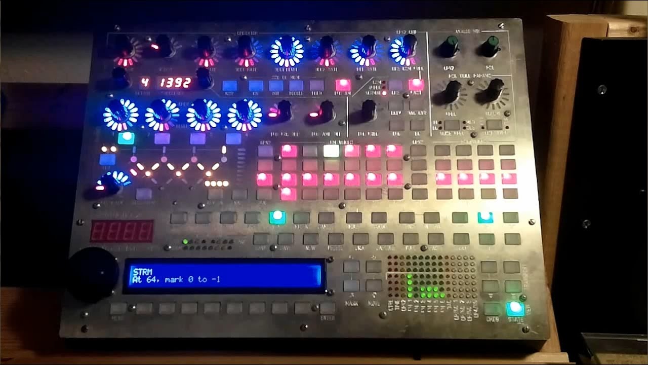

New video! Goes over the way instrument programs are structured and how everything is made out of VGM files.
Just amazing. This is brilliant, using the VGM file format as the patch struct. Still trying to wrap my head around this but on the fly ripping of instruments! Just amazing :slight_smile:
Yogi

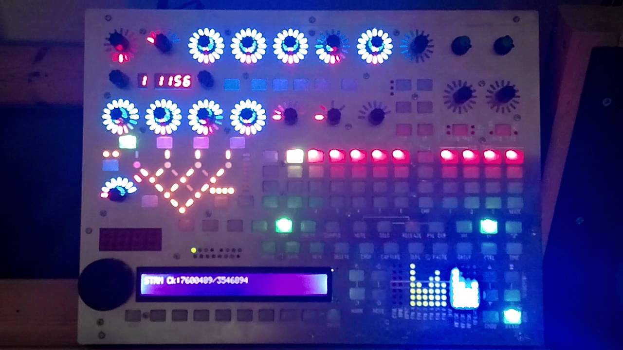

New video, though I didn’t take the time to record the sound the right way. It’s showing the VU meter feature, which uses undocumented test modes of the OPN2 to read back operator states while the VGM file is playing. Also show off the fabled SSG-EG mode which turns the EG into a glitchy LFO, and proves that the VU meters are not being emulated.
