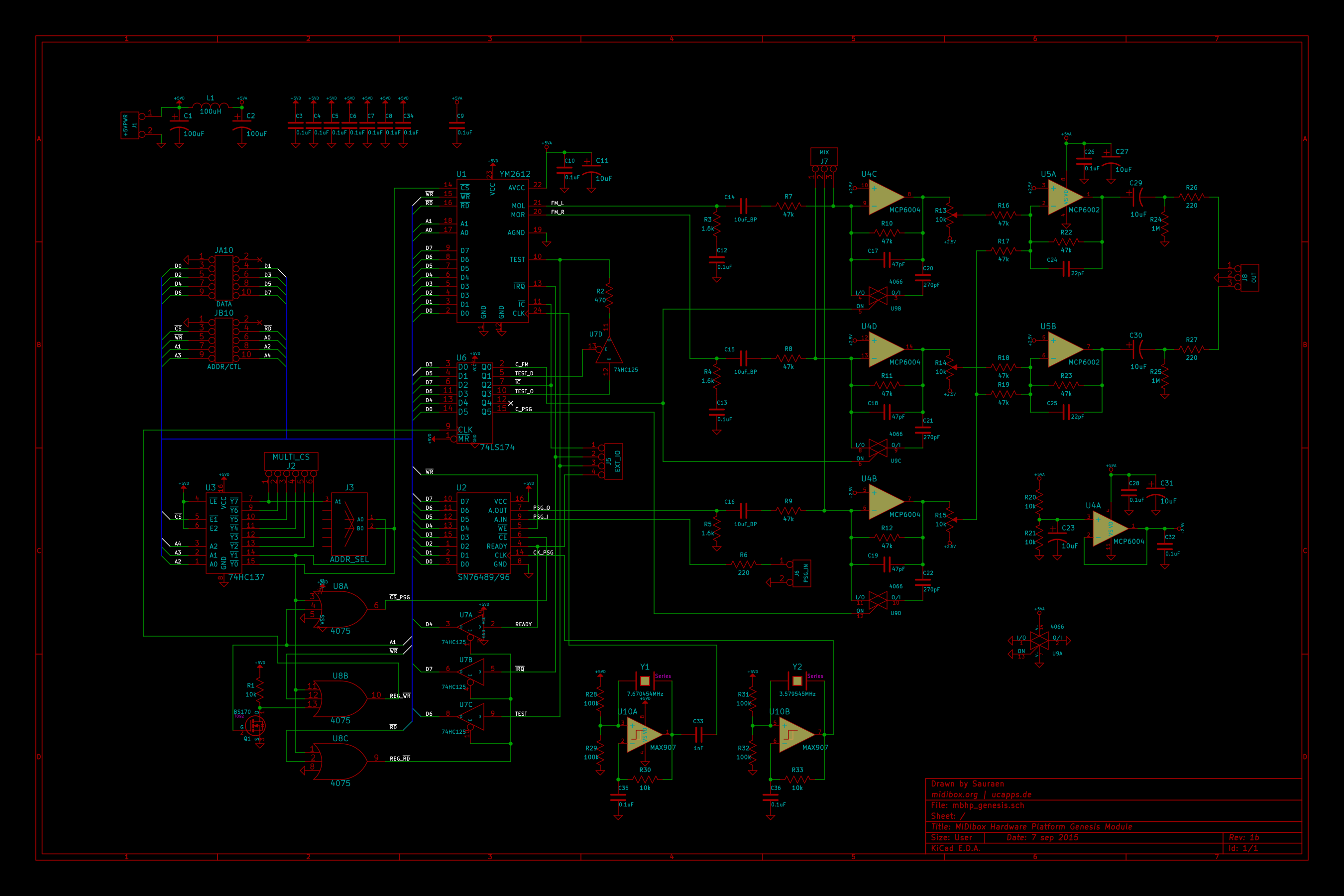

I have a draft of the MBHP_Genesis module mostly done (values off the top of my head, not checked). The board includes the YM2612 (OPN2), SN76489 or SN76496 (for SN76494, I couldn’t find a clock module that was 500kHz in this package, so you’ll have to supply an external clock somehow if you want to use that chip), analog mixer/filter with digitally selectable cutoff frequency, and glue logic to access all I/Os from the parallel interface with no additional wires. Four boards may be stacked together, with certain pin headers and sockets, and certain components stuffed or not stuffed on each board–but it does achieve the claim of running four boards without a mess of wires plugging into each of them. It will, however, need a custom bus driver board between the STM32F4 and this module–even if the sound chips could tolerate the +3V inputs (they should be able to), I can’t expect the MCU’s fanout to be able to drive 12+ chip inputs. Details will come later.
Here’s the schematic and board, though the forum software resized the schematic, so there’s a real full-size version attached to this post.
Please forgive the minor graphical issues with the 3D view, I didn’t feel like doing custom 3D modeling for the oscillators and the headers, or fixing the TO92.This is the full-size version schematic (click, then click Full Size in the bottom left):

The schematics above are not up to date, I should be able to put up better ones in a couple days. The big change I made was replacing the two discrete clock oscillators with a dual oscillator circuit using crystal resonators instead. This was because crystal resonators are available that very closely match the frequencies used in the Genesis, so that when VGM files are played on the synth they will be at the original pitch.

Updated board (ver. 1b) (as usual, right-click on the fourth image, the “smaller” schematic, and select Open in New Tab to see full resolution)
Sorry for the OT post. Feel free to remove it, or I will if you like.
 On another note, been modding my original prototype to be in line with your design. One point you may want to change, the READY output from the SN76489 is an OC so it will need a pull up. I would guess any value between 1K and 10K, depending on needed rise time and current draw.

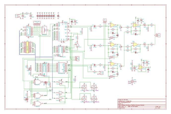

Here’s the rev. 1d pictures:
Low-res schematic if the one below does not work:

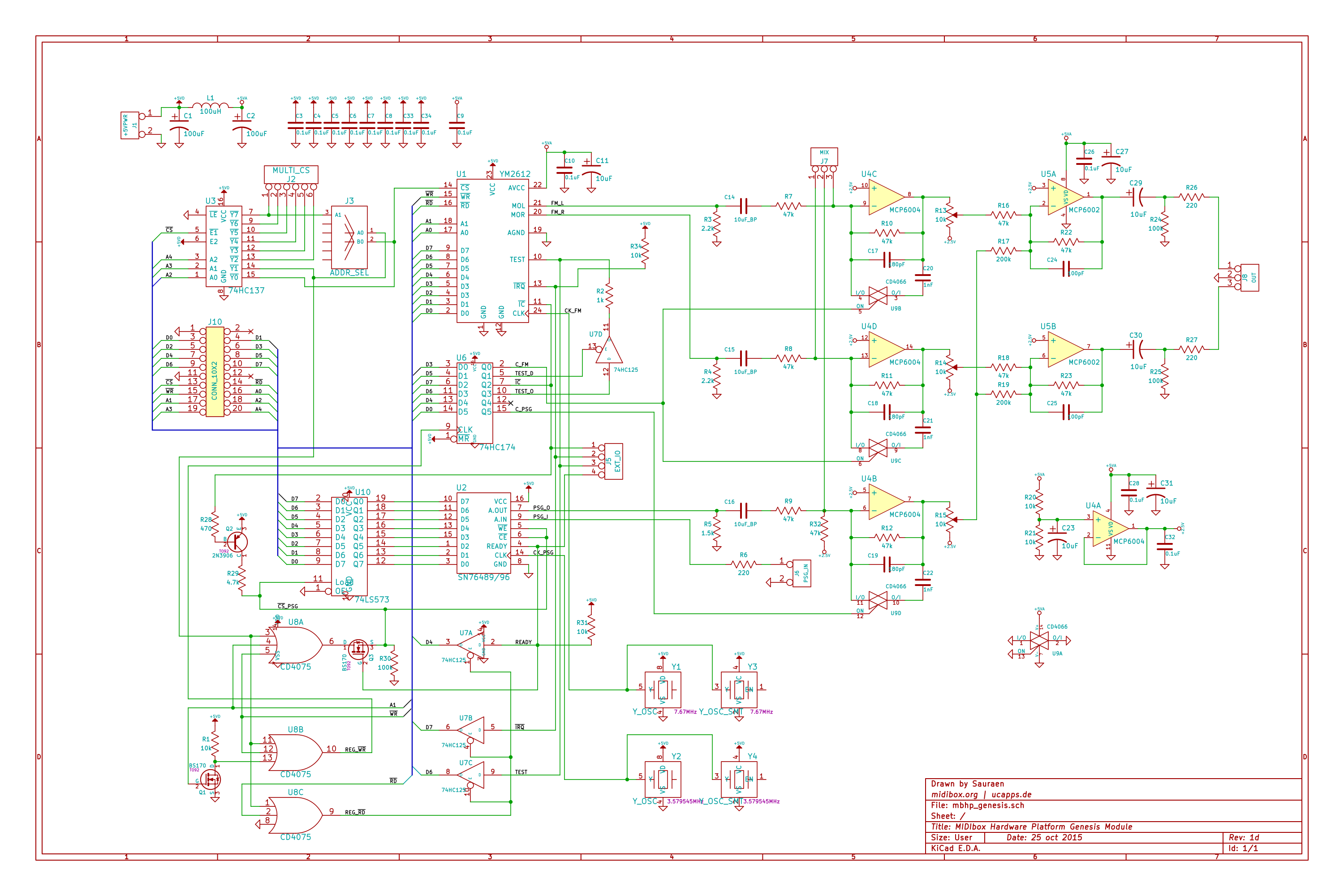

Revision 1e of the MBHP_Genesis boards have been ordered! The price for the bare boards will be $5 each. When they arrive, I will assemble and test one (with a similar AVR-based test program to the one I’ve been using, not the Core_STM32F4 that will be eventually used), and then begin taking orders for boards and parts kits.
Here are the production revision (1e) schematic and board images:
And the full-size version of the schematic (click image, then click Full Size, then click image to zoom to full size–it’s 3000x2000):
