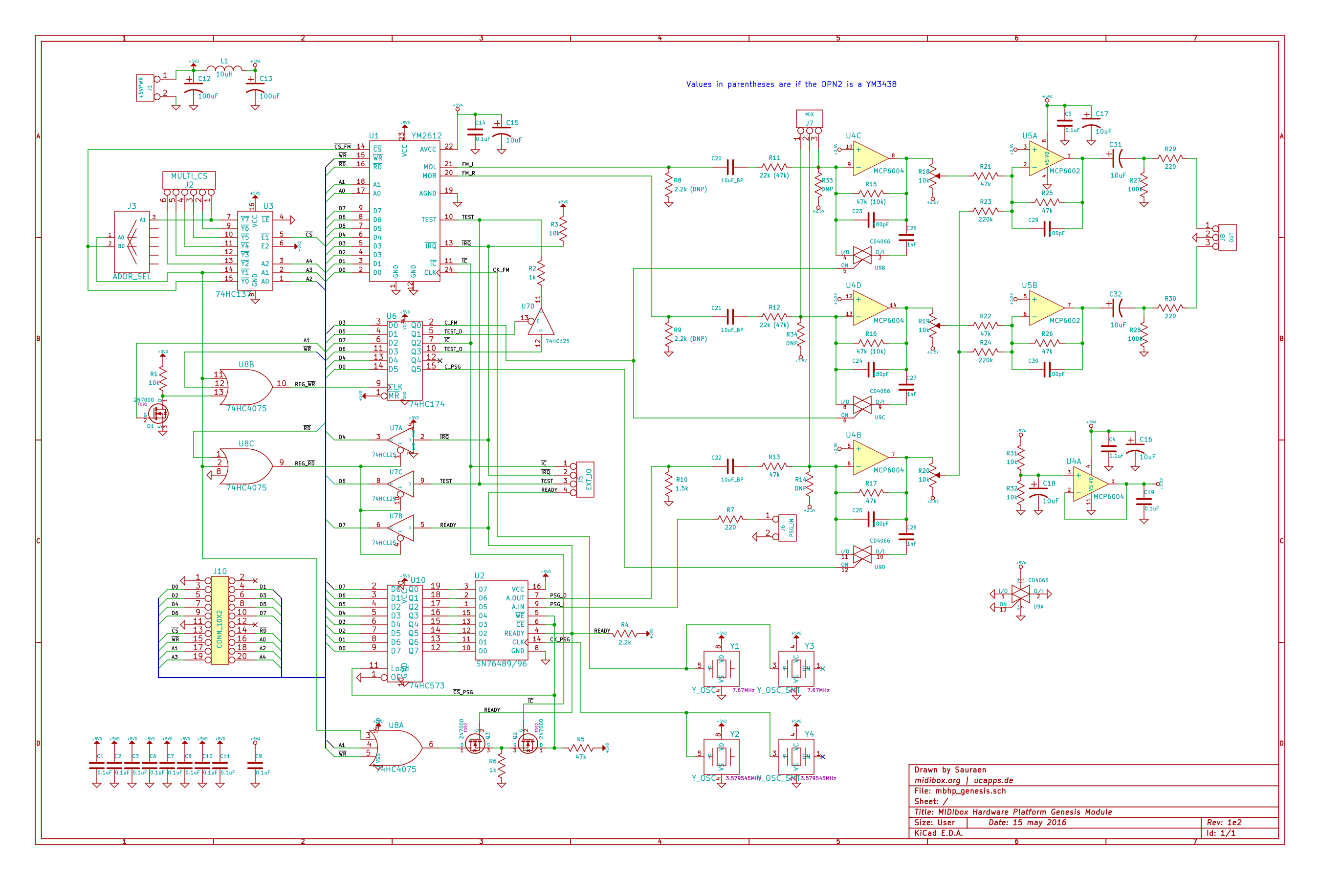

Updated schematic (rev. 1e2) for MBHP_Genesis (rev. 1e) boards:
