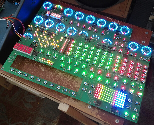

Here is the front panel PCB with all 600+ LEDs on. (Actually, they’re not quite all on, due to another part of the software I forgot to disable while running this test–but the other red and green LEDs in the central matrix do work).

Not sure if this will make you feel any better, but it only took me about 20 hours to assemble and bring up the front panel board.
If (when?) I sell these boards, I will also offer a matching aluminum front panel for about $300 and a matching set of 3D printed transparent buttons and LED pipes for about $30. But I will not sell them until the MIDIbox Quad Genesis firmware is significantly usable (won’t say “done”), which won’t be for a few months.

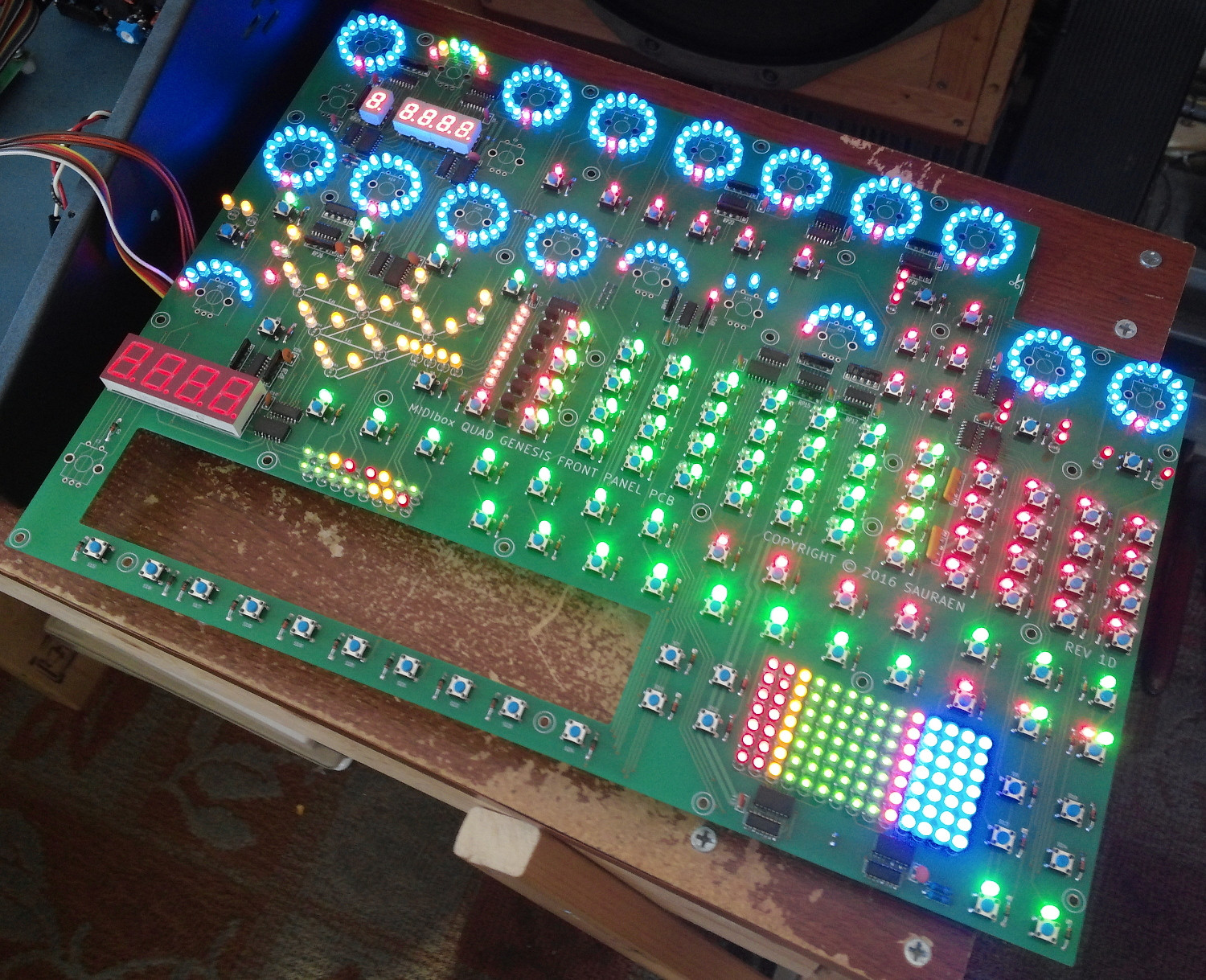

It’s much more impressive when the lights are off–it lights up the room quite nicely.  This was taken in a bright room (midday while it was snowy outside).
