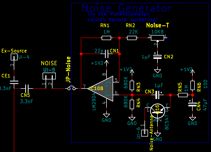

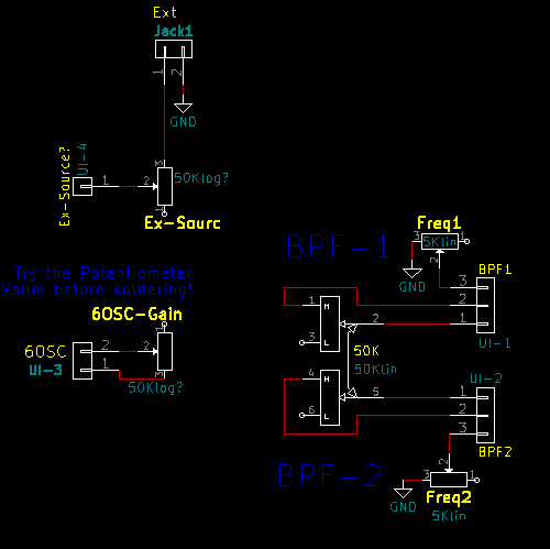

TR606 CY+HH Kicad Shematic (Capacitor labeling on old shematics)
yup,was just for concept.

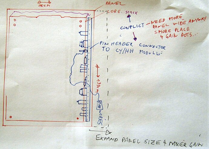

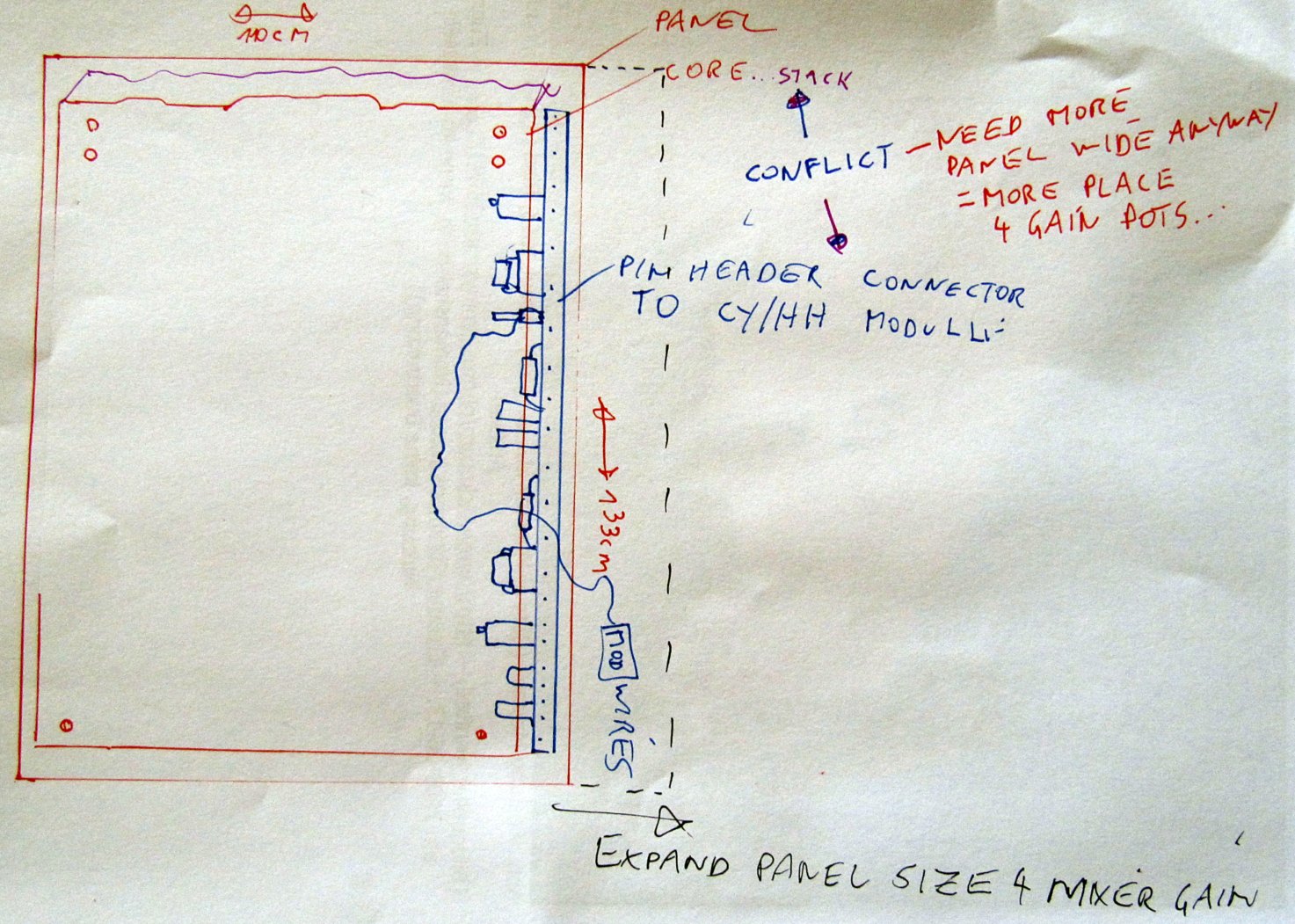

By the way I almost finished the frontpanel first design , i send it to you by pm very soon-
I had it divided in 3 : 2 widths for Cym/HH,one central width for mix and 1 width for BD/SD. You will see the potential =)

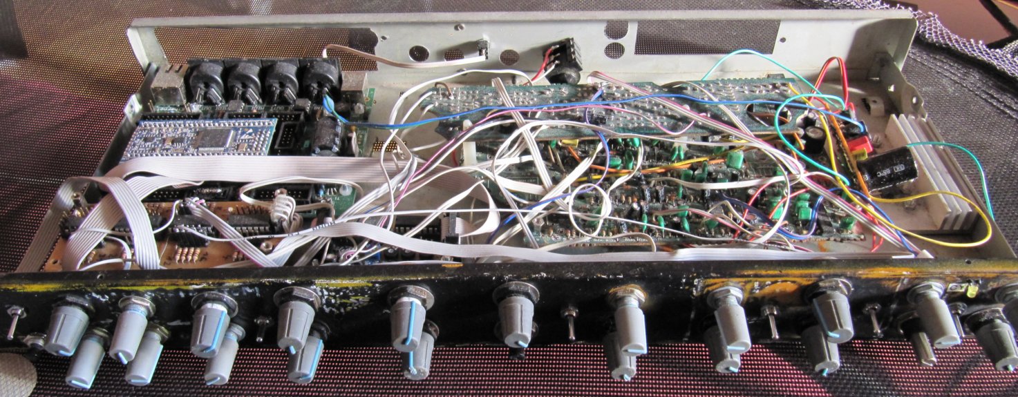

my heavy modet 606…
Core-Sandwitch-Conflicts
