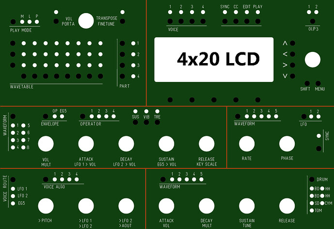

I want to Build a full featured, nice to look and easy to use MBFM synth.
I brainstormed a bit , and i thought that reusing Wilba design could be a start

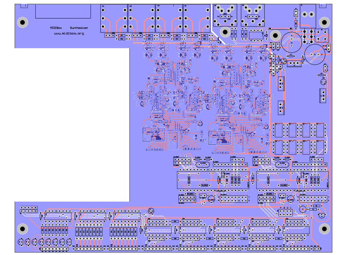

Based upon a screenshot of the frontpanel of the MB-6582 in frontpanel designer soft, i made a Control Surface Design “Step C” alike for the MBFM synth with some Photoshop copy/pastes.
Then i opened the MB-6582 Base PCB and incorported good-sized OPL3 modules instead of the SIDs. I let you see.
Some improvements could be made on the FrontPanel, like a shape for waveforms instead of numbers. But i think i didn’t forgot too much.
Waiting fo some advices before going further into that work =)

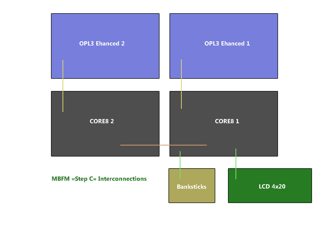

I am really into building an MB-6582-alike design, but MBFM adapted. Graphical representation for waveforms/routing could be done in engraving, even if i must admit graphical OLED  would be totally geek ^^
That is a choice (maybe not the best) , but i really think i’ll go with 2 CORE8 chained , each one driving an OLP3 modified (5V version). I prefer building a robust AIO design than a modular on this one (maybe with some options).Modular design sounds ok to me for experiments and prototyping, not for a “final” build.
Much work for the CS PCB and MIOS code expected (especially with this new UI), Maybe less for the Base PCB, as well as Wilba as even considered a lot of things into his design.
I already have a good base with the MB-6582 CS PCB design too.

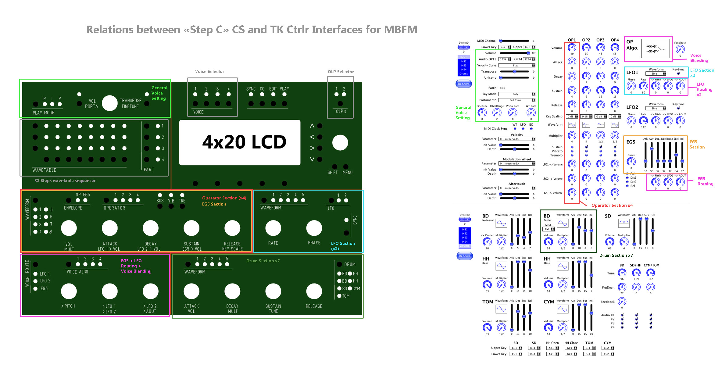

In order to make my “Step C” design easier to understand, i’ve made a parrallel with TK Ctrlr Interfaces for MBFM. I let you see.
By the way,may i open a wiki page for this project?
Any advices welcome,

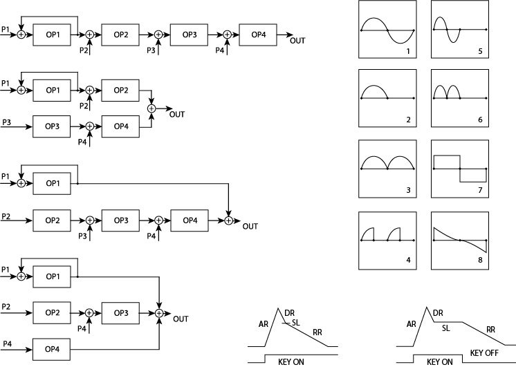

Where could i find the waveforms shapes or routing diagrams ?
YMF262 manual:
http://map.grauw.nl/resources/sound/yamaha_ymf262.pdf
Ok great thanks =)
I’ll import my photoshop layout in illustrator in order to make a good sized DWG/DXF : this will be my base for components placements in Eagle for CS PCB and source for HPGL engraving in FrontPanel Designer.
While in illustrator , I’ll import waveforms / routing algos and will shape the paths , this way it could be exported in DWG/DXF or in any graphical form.

  • Not related to MIOS, Is there any way i can access MB-6582 Eagle Files to take it as a start for my PCB design ?
I think the PCBs were designed in KiCAD, and the layouts aren’t publicly available. Did you decide to follow the MB-6582 form exactly? Are you using a PacTec case?

Just for some reasons  (that is a choice) i will stick with a 2xPIC design for my MBFM prototype / build .
Anyway, in order to be useful to everybody, I will try to make 2 Base PCB versions, one 2xPIC-based (my initial project), and one including the new core32 following Saurean work. This way it should fit to everybody ?
The CS would be intended to fit both of these PCB.

If MB-6582 PCBs not publicly available, i’ll start upon with eagle files already provided (core8 + ehanced 5V OLP3)

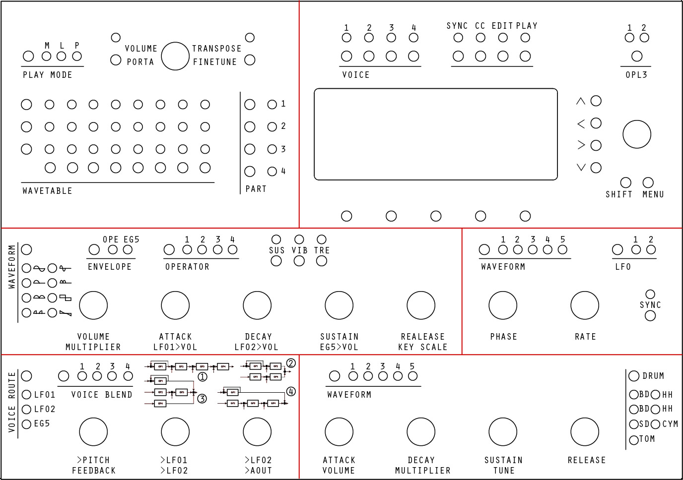

Ok , I’ve finished shaping Waveforms / Envelopes / Routing from the manual , i let you see.
Attached with the jpeg preview , the corresponding dxf file with 3 layers zipped.
I’m going for a sleep, see you tomorrow everybody =)
JK

I can see that you might want to start by modifying the existing PIC code so you don’t have to write everything from scratch, but I’m not sure if it would be worth the labor. I would definitely recommend starting with STM32F4: MIOS32 and the toolchain are well-developed and easy to use, and you won’t run out of CPU or RAM nearly as easily. You said this processor is overpowered and even “useless”, but I can tell you that I first built MIDIbox FM V2.0 with the LPC17 core, and it lagged when playing large (30+ voice) MIDI files; this went away with the STM32F4 core, so it was just powerful enough! I have to admit it was heavyweight code, running the entire MIDIbox NG underneath as well as 16 modulation connections per voice; but still, none of this would have been possible on the PIC core.
Hello all !
Thank for your advice Sauraen =) glad you answered, will probably need your advice on the synthesis part as well as you know very well the subject =)
Sounds like everybody telling me using the new core ^^ . I heard you guys ! and from yesterday i am really taking this seriously in my guidelines .
I often work like reverse-engineering , starting with the endpoint (Here the Control Surface) to go forward to the core (synthesis part) .
So i’ll summarize my roadmap in this project :
  • First , the Frontpanel : With the UI designed on ‘proportions’ , in know where to Place Control surface components on the PCB, distance between them etc. as well as i got a MB-6582 CS PCB stuffed near me, i can take dimensions on it.
  • From the Frontpanel , Count how much DIN and DOUT i would need , and how i would interconnect Control Surface to the Serial Registers .Would maybe need some pieces of advice on this part , as well as many of you experienced the thing much better more than me.
  • Then , when interconnections from Control Surface to DIN/DOUT would be designed , I will go to CS PCB design. DIN and DOUT will be placed on base PCB. Interconnections between base PCB and CS PCB with sandwich connectors.
  • After this , i will begin design Base PCB from 4 jacks output / MIDI I/O , and then add the 2x modified 5V OPL3 before . Will keep some place for a 5V power section for CORE and OPL3 modules near the power Switch.
  • Then , the first challenge is coming . 2 versions of the Base PCB : First One with PICs, like in MB-6582 , and the other one including a STM32F4 core.
  • The difference between the 2 base PCB will be only the “Core” section :
    On the first version,based upon existing MB-6582 design, the core will include 2xPIC18F4985 and 8 banksticks.
    On the second version, the banksticks and the PICs will be removed and include the STM32F4 CORE section / SD card etc…
  • Then I will go for Code with some modular design to go into the code before the PCB getting made.
This way i could stick to my “PIC challenge” and let other peoples make new crazy things with the new CORE32 with the second version Base PCB for example =)
And even if i don’t get out of PIC code i would be able to “change my mind” and go for the new core this way. But i want to try the PIC challenge,i’ve made my mind ^^ .
But want to be helpful too, that’s why i’ll design the second version Base PCB.
Sounds OK to you?

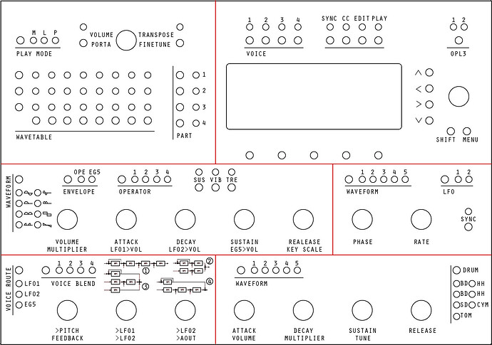

Ok, got the FrontPanel with real sizes on DXF.
I incorporated waveforms for the “Operator” section, sounds good . Left the numbers for LFO/Drums waveforms as well i am not sure of the good waveforms to incorporate.
Gave a try to incorporate routing diagrams on the routing section . But not sure it will give something good with the scale. And i do find that it overloads the routing section layout.
Maybe better to display this on 4x20 LCD? i understand that waveforms would be ugly on the CLCD, but it should fit for routing diagrams?
DXF file zipped attached with Jpeg preview.

When i’ll have made my mind about how working on the PCB thing (>mostly the soft to use) , following to your advices, i’ll start up CS PCB.
Regards,
JK
[MBFMX2_frontpanel.zip](< base_url >/applications/core/interface/file/attachment.php?id=12790)
 I was wondering if you knew some about the 32 steps wavetable sequencer?
this is still a dark thing to me in here. Any link welcome =)
regards,
JK
As far as i’ve seen from MB-6582 CS<>DIN/DOUT interconnections, I may need :
  • (8 DOUT registers * 11 DOUT registers) = 88 LEDs matrix
    - (8 DIN registers * 7 DINregisters)=56 switches Matrix (with 5 unallocated)
    Please tell me if not correct =)
How many shifts register may i need for encoders? i quite did not understood the interconnections to DIN.
Waiting for someone to confirm =)
Regards,
JK
