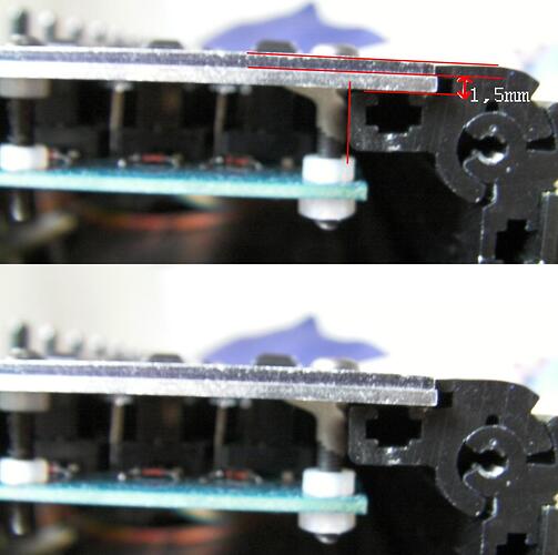

Now I understand what you mean. Well, the reason why I proposed rails is that your design is probably a 1,5mm one and now looks recessed. If you use a 3mm design and add rails, it would look flush mounted. But I guess it’s a matter of taste and budget.
Also be careful with altering the original design, the screw holes should have the original alignment. There’s probably only space left for a LED lead when you finally assemble case and panel.

for my own personal build, for which i could cut the panels however i wanted, where machine time, or metal cost would be largely irrelevant, i will use the design above, as i think it is a stronger, neater panel than the original design.  to re-iterate, i can cut my own panel however i choose, and i will cut it to this design (unless the hardware changes by the time i get around to it!)
