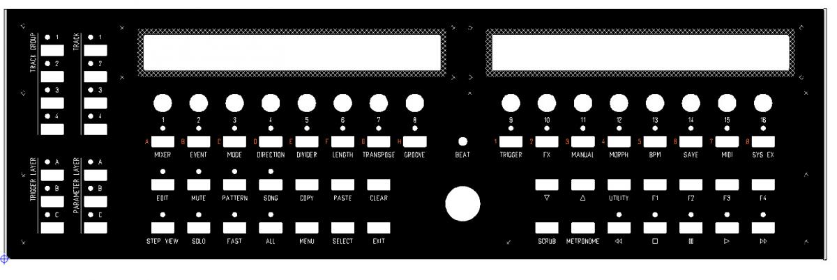

  • I received permission from Wilba to use his frontpanel design.

  • front panel costs: with 2 LCD windows at frontpanels.de (~ 170€, Roelli mentioned a 20-30% discount compared to Schaeffer)
  • front panel costs: with 2 LCD windows at Schaeffer (184€ + 2 x 20,42€ excl. shipping and verifying against the CS PCB)
  • uniform front panel design for reduced complexity (holes for screws, colored engraving, see pics)

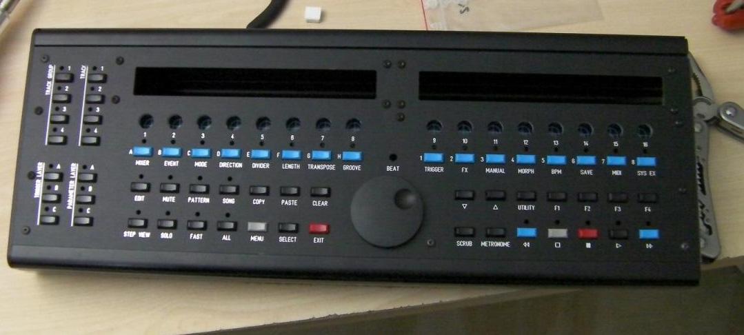

Stupid question: How is the front panel secured with the case?
I’m interested in getting one but I’m not quite sure about this. Also I wouldn’t know where to get the black screws needed here and which ones are needed.
See the pic. Plz excuse the dust.

170 euro sounds really steep for the front panel, front panel express charged $180 to do my whole case (front and back panels) so you might want to shop around a bit.  In single quantities, the FPD software has the front panel @ $115 usd which is 85 euro. Not sure why yours is twice as much
*edit
OK, I see where you went wrong.  DO NOT get CNC windows made, that’s where your problem is. Get them laser cut, I can get 16 windows for a SEQ on the formular/ponoko A size (the smallest) for $15, on a bigger size it would be even less. I have the template if you want it (I use the same size for my Ambika builds)
Schaeffer/Front panel express are premium services and there are MANY different options out there.  Your Frontpanels.de guys sound like they are competitive, but I still dont get where that price comes from it’s twice what it should be.  First person I would talk to is Julian (thebeast), he’s an insider here and I am sure with a big job, he could beat out commercial places price wise
Well, FPE wants $223 for the FP without tax and shipping, that’s 165EUR. Note that this is Wilba’s original FP without slides, if you don’t want your panel to fall off the case add 10EUR for slides.
Roelli/frontpanels.de is a Midibox member since 2003, his record speaks for himself: http://www.frontpanels.de/examples/
170EUR is the upper limit - we now have 5 potential buyers for the front panels. If the last 3 participants add 3 FP we see a considerable price drop.
My 1-off price on front panels for the Heidenreich is GBP 80 (which comes to 100 euro)
My 1-off price for the rear panels is GBP 35
Im very pleased to see someone organizing a group buy for the cases - indeed, i may be a customer for a few myself, as people ask me about them often, but both in my own interests, and those of potential purchasers of panels, i have to comment as above.
I hope my post does not offend.  I would wish any group buy luck, but, again, the group buy pricing on the panels is *way* above what i charge for even a single unit.
Oh, I see.  You’re using the panel with all the work on the back.. You do realize that almost triples the price?  You can do counter sunk through holes for the standoffs and and no counter bore for the displays and you’ll be back where I am price wise.
Here is what one of mine looked like with laser cut windows and through holes for the stand offs (same as what Julien is offering if I am not mistaken)

Okay, this is interesting. What I want:
  • minimal workload for me, collecting huge amounts of money means registering a business with the officials. If the participants would send their money for the FP directly to Julian or Roelli, I would be glad.
  • fair prices - I would like to see both Roelli & Julianf benefiting from this bulk. The goal is: will the participants will save money compared to Schaeffer, yet with the full quality experience?
If the pros (SmashTV & Altitude) could help out with designing a back panel and a breakout board for Ethernet, USB, power switch etc. it be much appreciated. I’m currently busy with the old STM32 option, the STM32F4 PCB isn’t in my focus right now. However, TK. mentioned the SEQ4 plus to be rolled out in the next time, therefore the STM32F4 will be necessary.
Find Roelli’s price quotation for 10 panels attached.

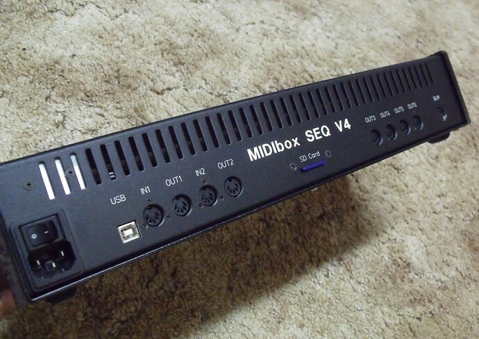

here is how I do my back panels.  I find it much easier to mount the board directly to the backpanel using the the midi sockets that have three holes as brackets.  Trying to use standoffs and align things on 3 different planes is a bit too fiddly IMHO.  I have the layouts for the STM32 and LPC but not the new one.  Also the SD card holder I like and the 4xIIC midi

I will post a screen grab of the rear panel i most often cut for people.  It is the same as Wilba’s but with the power switch changed to an SCI item (due to people finding the original hard to obtain) and the addition of one extra MIDI port (with the same spacing as the other ports).
The rear panel is easy enough to customise, but most people in the past seem to be happy with this configuration.  This does, however, not simplify the 3d alignment - as per Altitude’s comments above.

I will find photos of the back panel etc. when i am on the other computer.
Looking forward to see them.
