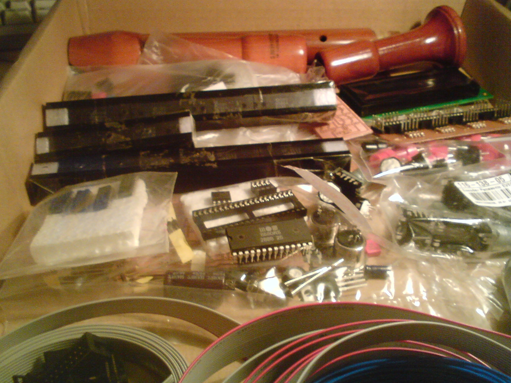

so at the moment i’m busy sorting out the material and as soon as there’s something to show i’ll upload some pics which i have to admit won’t be of good quality at all (cell phone)

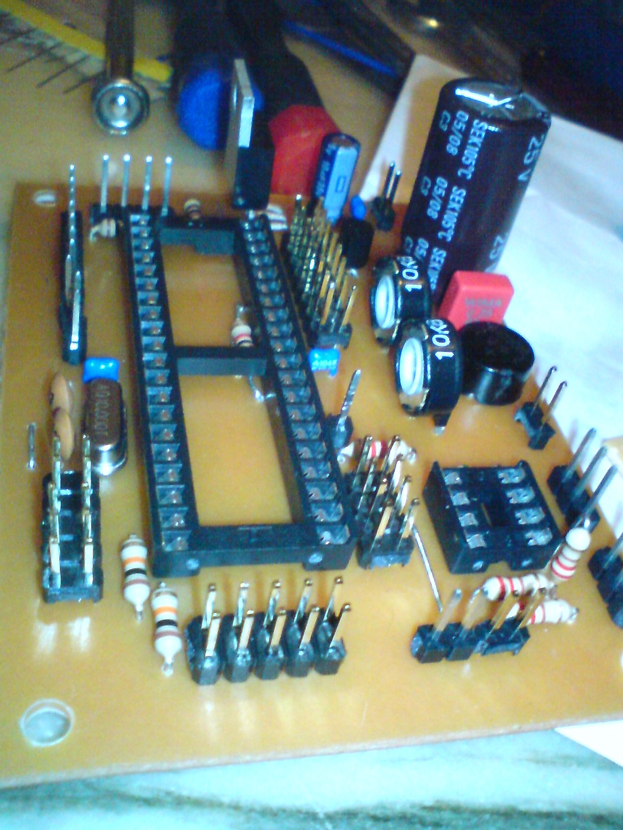

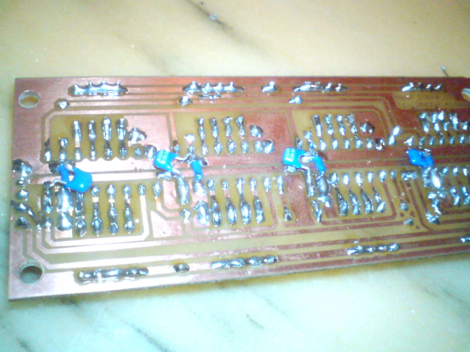

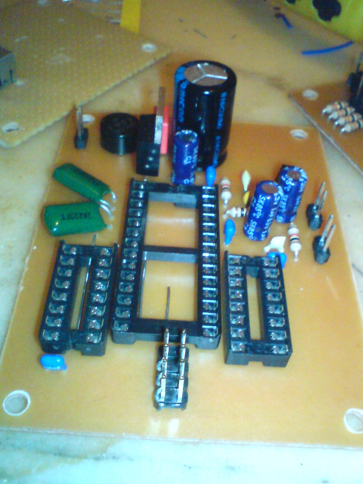

i’ve built a CORE, SID and DINX4 and here are the promised pics… in promised poor quality atm… meanwhile i’ve ordered one more SID kit at Mike’s to have at least a stereo SID. now i have some questions:
  1. does the 2nd SID make changes necessary? i read about buttons to switch from stereo to 2xmono and an additional LED to show the mode… so i think the buttons are no problem, i’ve built a DINX4, stuffed completely. but for the 1 LED i’d already need a DOUT i guess??
  2. is it ok to build a complete DINX4 while using only a part? but somehow silly not to make use of the possibilities, but i thought it’s better to build it in one run. so if it’s dangerous or likely to cause undesired effects, i’ll have to look for some more knobs etc to make use of the whole thing

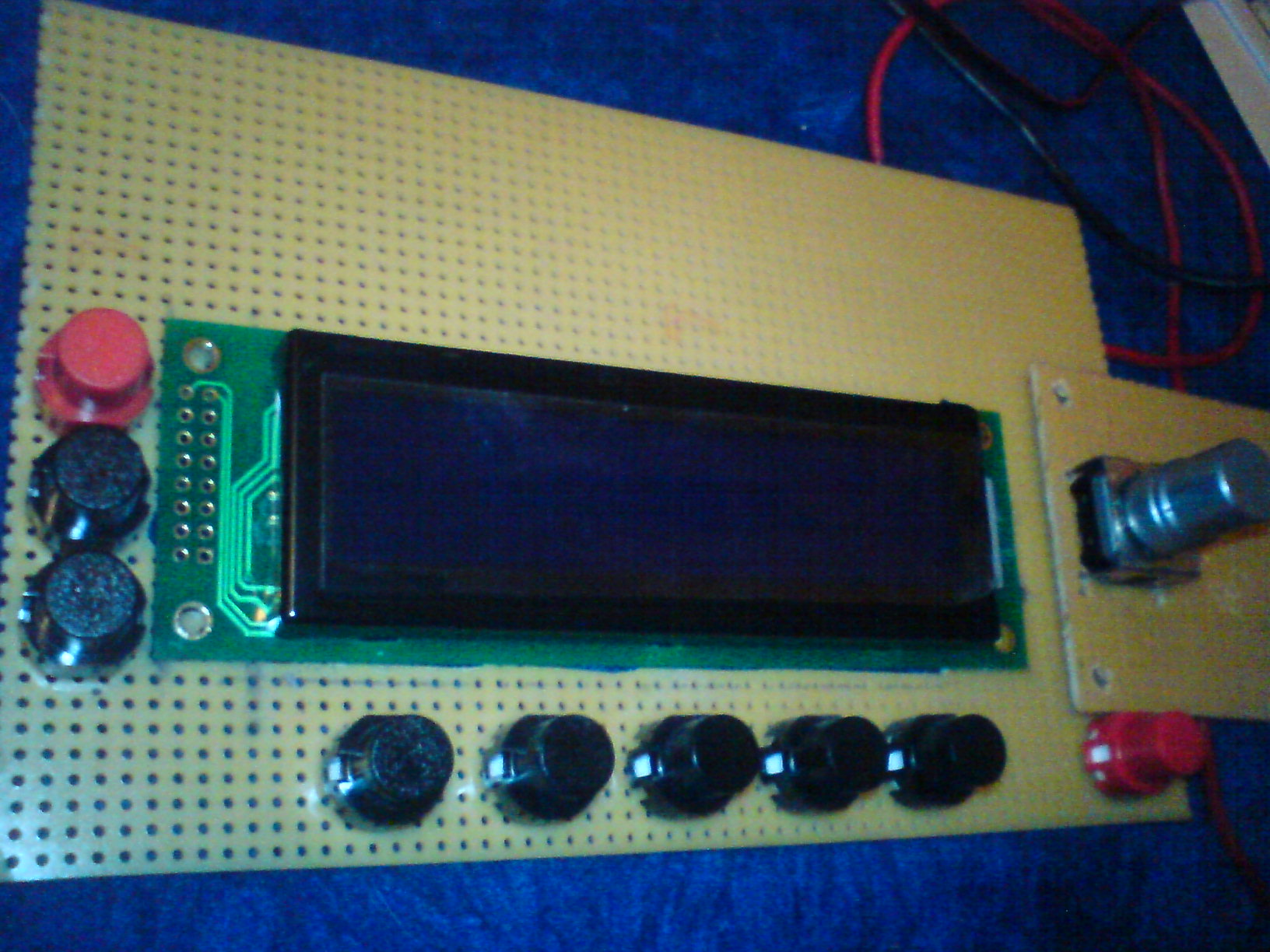

so let’s have a look at some pics! all without cables, but i’ll have to wait for my PIC anyway…
few more…

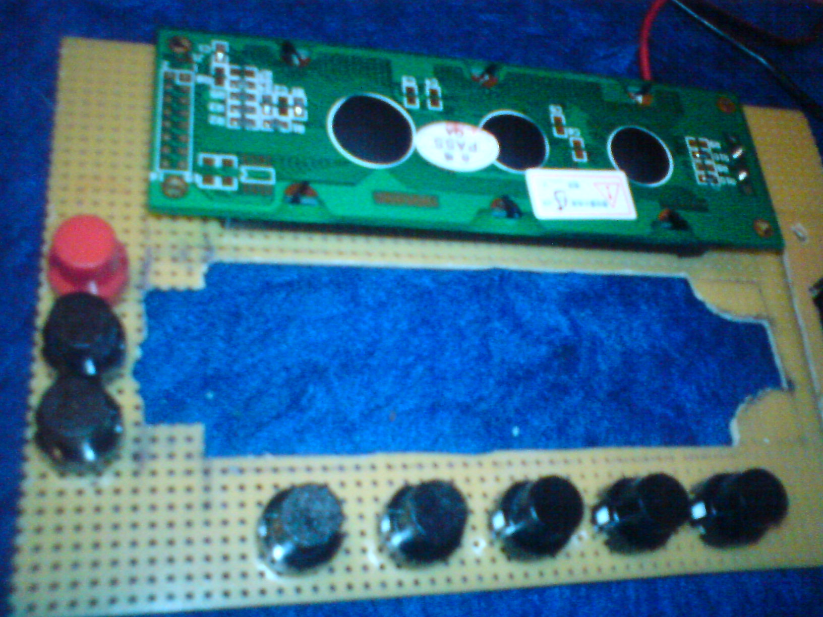

that’s the control surface pcb, i’m trying how to put the LCD between the buttons. don’t laugh, it’s my first try!
edit: also first try posting pictures, next time i’ll reduce them…
  1. Yes that’s fine, just don’t stuff the unused shift registers :slight_smile:
