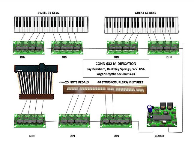

I have just uploaded a photo in the Gallery. under Jay Beckham of my proposed diagram.
Jay Beckham
[Organ.pdf](< base_url >/applications/core/interface/file/attachment.php?id=9156)

Corrected drawing. Graham Goode noticed I only had one Core8 but I need two Core8S.
Jay Beckham
[Organ.pdf](< base_url >/applications/core/interface/file/attachment.php?id=9159)

As I understand the new version of MIDIO128, it is still limited to 128 inputs unless you are using a switch matrix. Based on the drawing you’ve made, I think the PIC8 boards will be more cost effective.
BTW, the DIN chains should connect to J8/J9.
