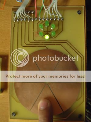

with this test board, i can make toms rolls or phat breakbeats
with only one finger, and a small circular movement !!  :o
BUT… :-\
when i touch two sensors in the same time, i heard one or the other sound randomly.
is there a way to have touchsensors acting like buttons ??? (polyphonic?)
I wish that it be possible by any means…  :cry:

i can share all things that you want…
but i have don’t understand some questions  ??? (i’m french)
all that i can say for the moment is,
I have simply use the touchesensor fonction of the DIN (with 47k & pin 14…)
and made a copper board, that including the led for the DOUT
(useful for the Toggle Mode)
and copper for the DIN.
Sensors & Leds works perfectly !! and it’s the fastest way to trigger sounds
that i know !!!  :o :o WOW!!
if i pressed two, three, four or more sensors at the same time, no problem
i received all the notes in Cubase, without any latency !!! great !!!
it’s definitively the heart of my future midibox, soon finished.
what exactly do you wanna know ? if i can help you…

i have made it.
simply draw the layout with Eagle.
and use the copper side for both components
& sensors.
it cost about 6 €uros, (it’s just my testing board)
Board, Leds, Resistors, that’s all
(if you already have the perchlorure, etc…)
it’s more clear ?

i want to know how u made the “buttons” = the things u touch = the 6 triangles = the sensors
… well, that’s what’s left over after etching… the copper
lets see if i understand :
what i see in the picture/video is only ONE (=1) one-sided board u etched ?!
can u post the picture for the etching ?
why does the “buttons” look as if they are convex and on-top of a separate board ?
… this comes from the camera lens. - Look at the PCB edges.
