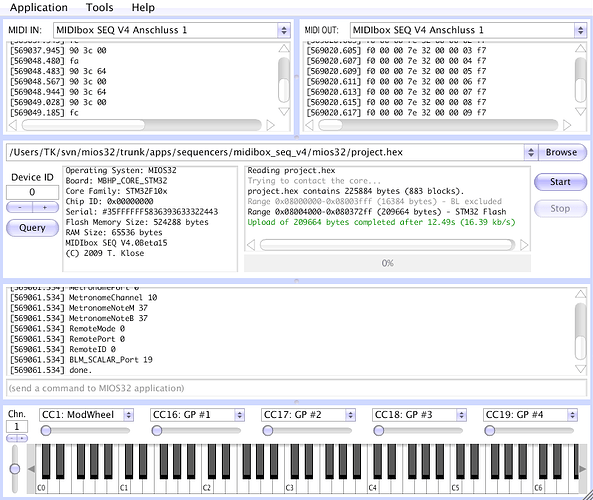

  • MIDI IN/OUT monitor translates the MIDI event into text format! :slight_smile:
  • Keyboard and upload panel not resized anymore. This has the advantage that the terminal and MIDI monitor panel can be enlarged quickly without re-adjusting the other panels (disadvantage: Upload and Keyboard window can’t be hidden anymore, but I can live with that - still searching for a better solution…)

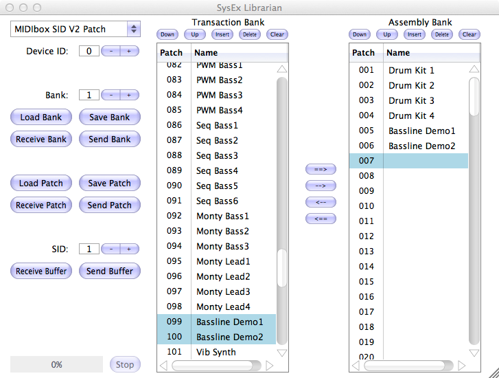

  • added SysEx Librarian for MIDIbox SID V2 (requires firmware v2.41!!), MIDIbox FM V1 (requires firmware v1.4e!), MIDIbox 808 (requires firmware v1.3!!) and Waldorf Blofeld.
    I can add more synths (also unrelated to MIDIbox projects) on request if they support a simple way to exchange patches
Screenshot of the new SysEx Librarian which is available under “Tools”:

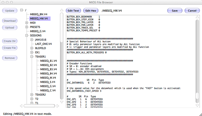

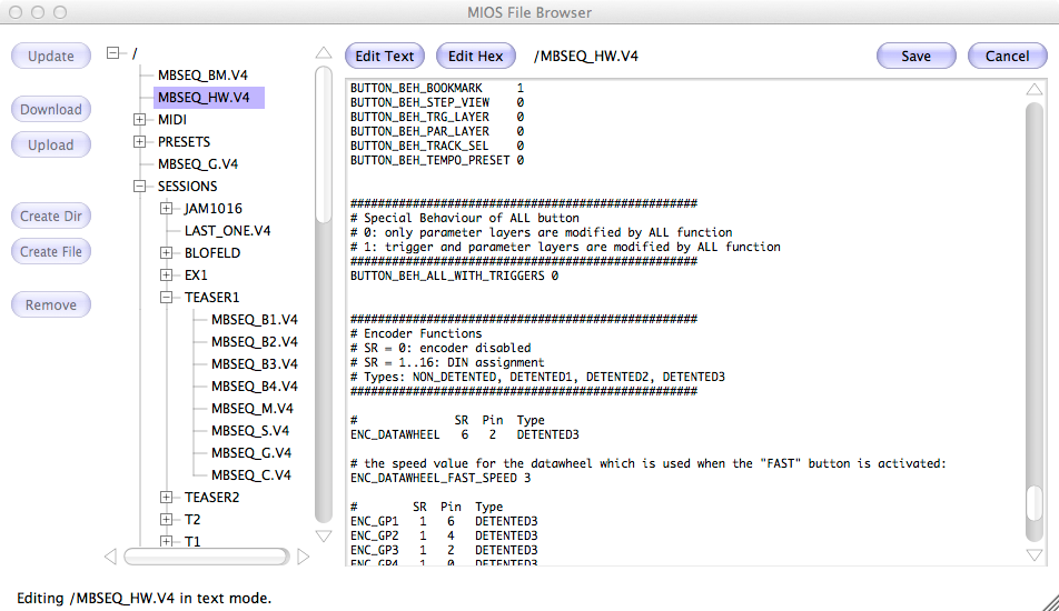

MIOS Studio 2.4.0 is available now
It now provides a very useful filebrowser, which is supported by the latest MIDIbox SEQ and MIDIO128 releases:
The “Update” button retrieves the directory structure. Once it has been read, files and directories can be selected in the directory tree.
Existing files can be downloaded to your computer at a speed of ca. 40..50 kb/s.
New files can be uploaded from your computer at a speed of ca. 10..20 kb/s.
The edit functions allow to modify files in text or binary (hex) format, which is really helpful for quick changes on application specific configuration files without disconnecting the SD Card from the core, or enabling the MSD driver (which would deactivate USB MIDI).
Have fun! :slight_smile:

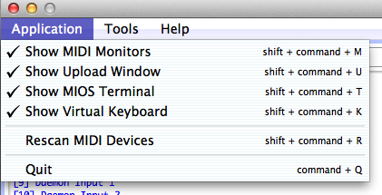

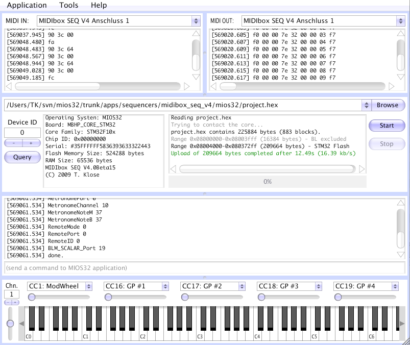

MIOS Studio 2.4.2 is available now
Again only cosmetic enhancements:
  1. the main panel components are resized correctly when the window is stretched
  2. it’s possible to select the components which should be displayed:
Best Regards, Thorsten.
