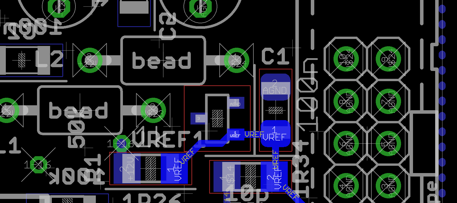

Hi all,
I’ve been having trouble with my eurorack modules build (couple of mails to Andy and Peter, thanks for the help).
The remaining problem was an incorrect VREF1 on the transmute8 pcb. Now I’ve botched the desoldering and lifted the trace.
Can someone tell me where I sould connect the VREF1 to?
Cheers,
Where is the trace lifted? Attached is a layout snippet that I hope could help.
Thanks but it’s the single side of the VREF1 (left on the picture).
