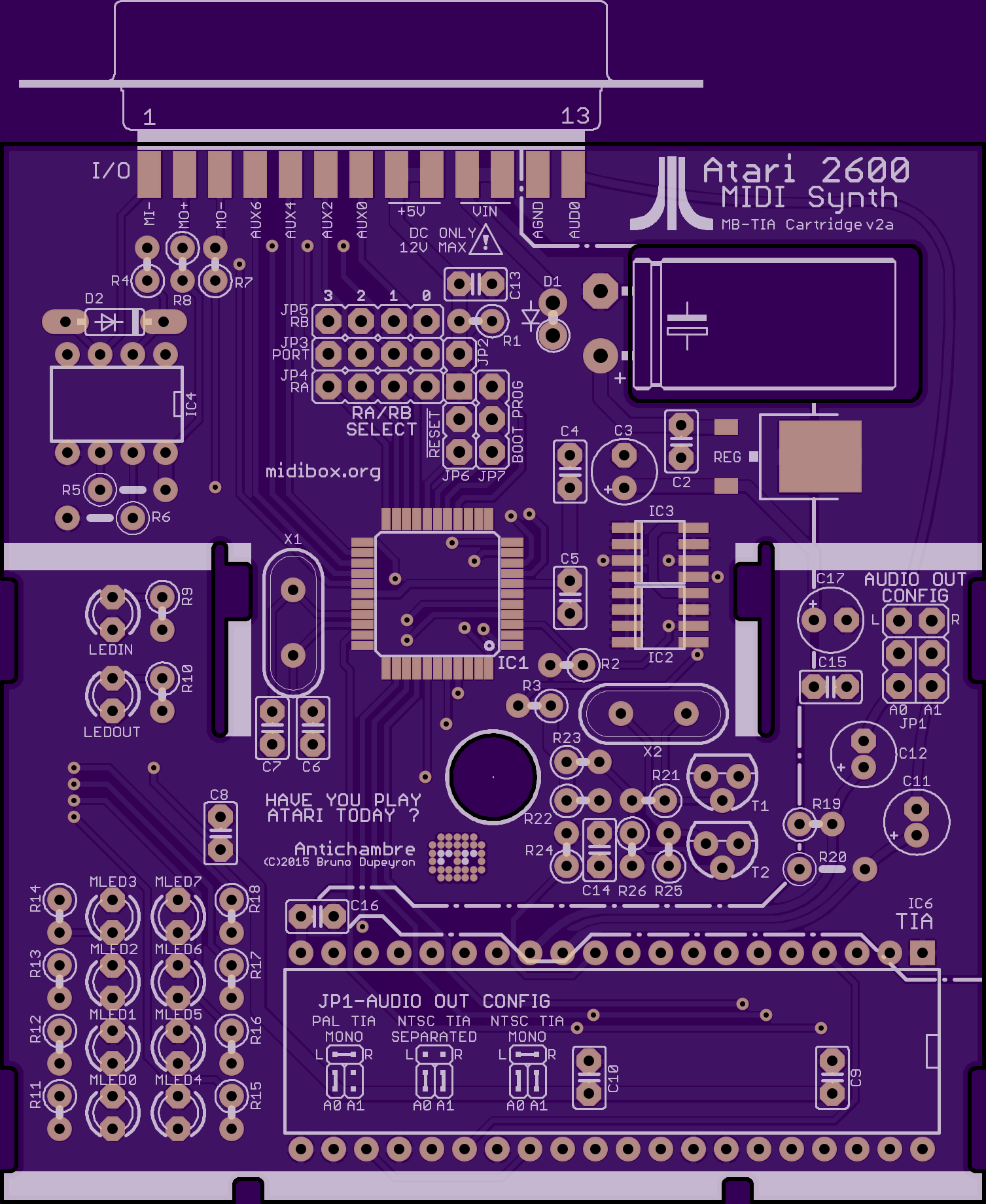

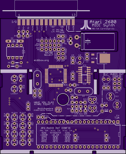

new PCB cartridge Version 2
I removed a cross-over between digital and audio part which was on the first version.

Hi Phatline,
For Gallery, I’ve got the same problem as you but i find that you can see it with right click on the picture and open in a new tab, strange behaviour…
Can not delete a picture too… Hummm.
No VCS needed, the PCB fits into a cartridge, there’s all I/O on a D-Sub 25… Power, MIDI I/O, Audio L/R and Aux for tuture purpose.
It’s a standalone synth, you just need to drive it in midi and/or with the manager I created under Max/Msp.
See wiki for more explanation and detail, you will find a video of cartridge in play :wink:

Hi Antichambre, looking over the schema and had a parts question. The serial EEPROMS are 256x8 devices, is there any advantage to using a larger device such as the ’ MB standard’ 32Kx8 or 64Kx8 mems.
Yogi
Hi Yogi,
Good to get someone who check my work, It’s a mistake. I think I only have got this one in my eagle library, I placed it without changing its value. And I exported the error in the BOM too.
Then YES!   there’s a big advantage to use the ‘MB Standard’
Will correct Now. Thank you…
Antichambre
The reference is fine in the Mouser BOM, checked. Will change it in the schematic… thx
