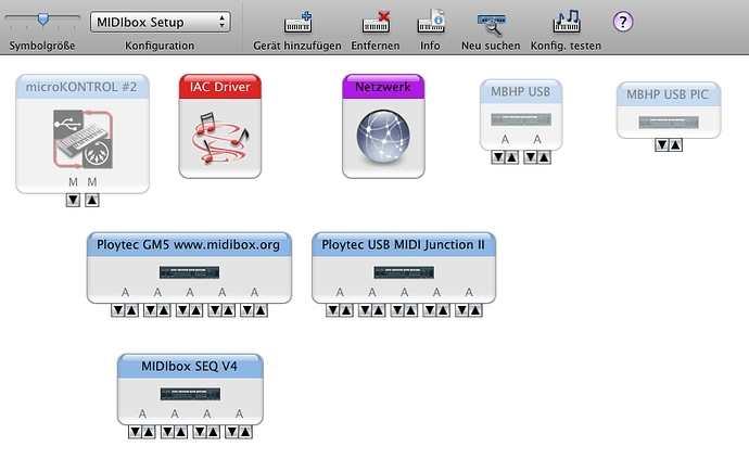

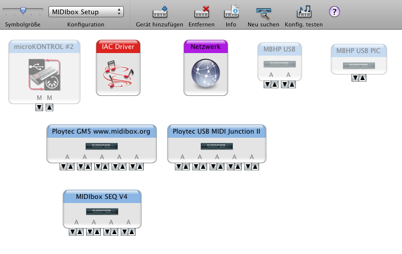

No, an additional installation isn’t required.
Do you see the device in the Audio-MIDI Setup Application?
(see Attachment)
Best Regards, Thorsten.

Nope. There’s only my MOTU FastLane (and IAC driver, and Network), as usual. Already tried Rescan several times before.
Then I’ve no idea. Maybe google helps you to find more informations about using a Standard USB MIDI device on a PowerPC based Mac.

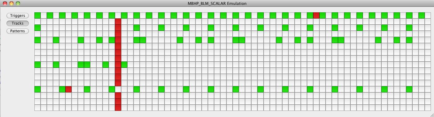

Btw.: is any Mac user interested on a BLM_SCALAR emulation?
I’m using it to test the protocol with matrix dimensions which I would never build myself :wink:
The application communicates with your MBSEQ via MIDI. Planned features: track editing, drum pattern editing, piano roll editor, pattern selection, mixer control, VU meters, etc.. all implemented in the MBSEQ firmware, the BLM_SCALAR application only acts as a stupid display/data entry device.

Link to BLM\_SCALAR emulation (Mac OS Leopard/Snow Leopard only)
[http://www.ucapps.de/mbhp/blm\_scalar\_emulation.zip](http://www.ucapps.de/mbhp/blm_scalar_emulation.zip)
Setup:
MIDIbox SEQ: select the MIDI port to which the BLM is linked in the Utility-\>Opt. page with GP Encoder #16
Emulation: select the same MIDI In/Out port
The matrix should be updated automatically.
Try different dimensions - 64x16 is a really useful configuration.
Currently we have display buttons for Triggers (e.g. Drum patterns), Tracks and Patterns.
One function that I'm planning to add next is the possibility to display Accents in the trigger page with the Red LEDs, and to activate accent by pressing "Triggers"+BLM button.
Gridracer: it would be interesting if your BLM configuration is still working, since I had to change a lot of code which is also used for common 16x4 BLMs directly connected to the core.
