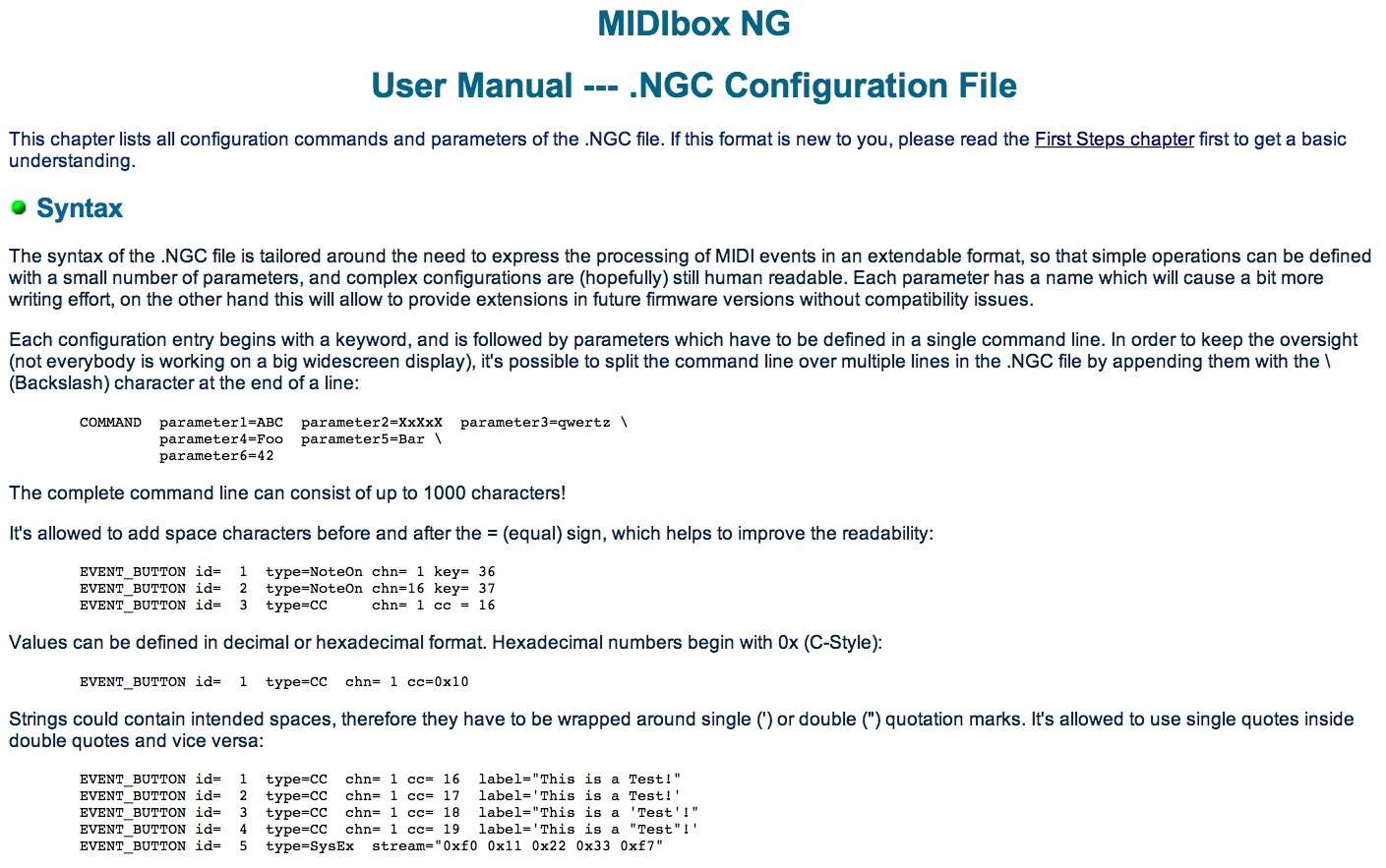

MB_NG setup don’t need any C knowledge if you stay with the implemented functions, which are already huge and powerful..

* MBNG: just as Zam said, it is completely customizable, just by editing text/script files and it is really very powerful! I’d also like to add, that if you want a “generic” MIDI controller, a lot of functions are necessary, from SysEx stream parsing, to supporting multiple hardware user-interface element types (encoders, potentiometers/sliders) and so on. The result necessarily is “complex” by definition - and if you want to master it, you have to dig deeper. But if you do that, the rewards are huge. If you like to experiment with never-heard-before synth sounds, nothing beats the experience of having a huge hardware controller attached to your good-sounding-but-limited-control-surface synth.

again.. I don’t get your point here, MB_NG is so easy, there is no C involved for setup…
You can’t ask for deep access in a system and in the mean time asking no work at your side to handle it.
MB_NG have mostly every things you can think about without any effort…  by the time you’ll use it and find limitation, you’ll be able to code in C

In addition to the MBNG, which makes the customization within the reach of my grandmother;) … the procedures and functions of MIOS are simple, TK has ensured. It’s like a car, you do not have to know how it works inside, you just have to know how to drive it.
