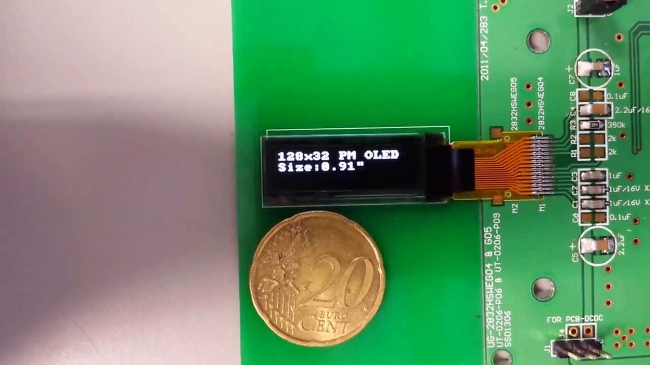

The diagonal screens are a little bit strange (for my tastes). What about 128x32 OLEDs instead?

We have lots of the 128x64 displays on order, so our Programmas will prolly use these, as they are not so cheap in larger numbers :smile:

With a new board revision, the LEDrings could be adapted to be a bit smaller in diameter, then the 128x64px displays could optionally fit horizontally. As the labels are just “dumb” graphics files loaded, every user can decide on his preferred display mounting style by just swapping the graphics files on the SD card.

Apart from the bling, I wonder why the LED rings should be necessary if you have these displays anyways? Leave the LED rings unsoldered and place the displays horizontally between four encoders, with each corner displaying a small bar representing the current encoder value.

Imho, the small OLEDs wont give the same overview as LEDrings, also missing bling is baaaad!! :smiley:
