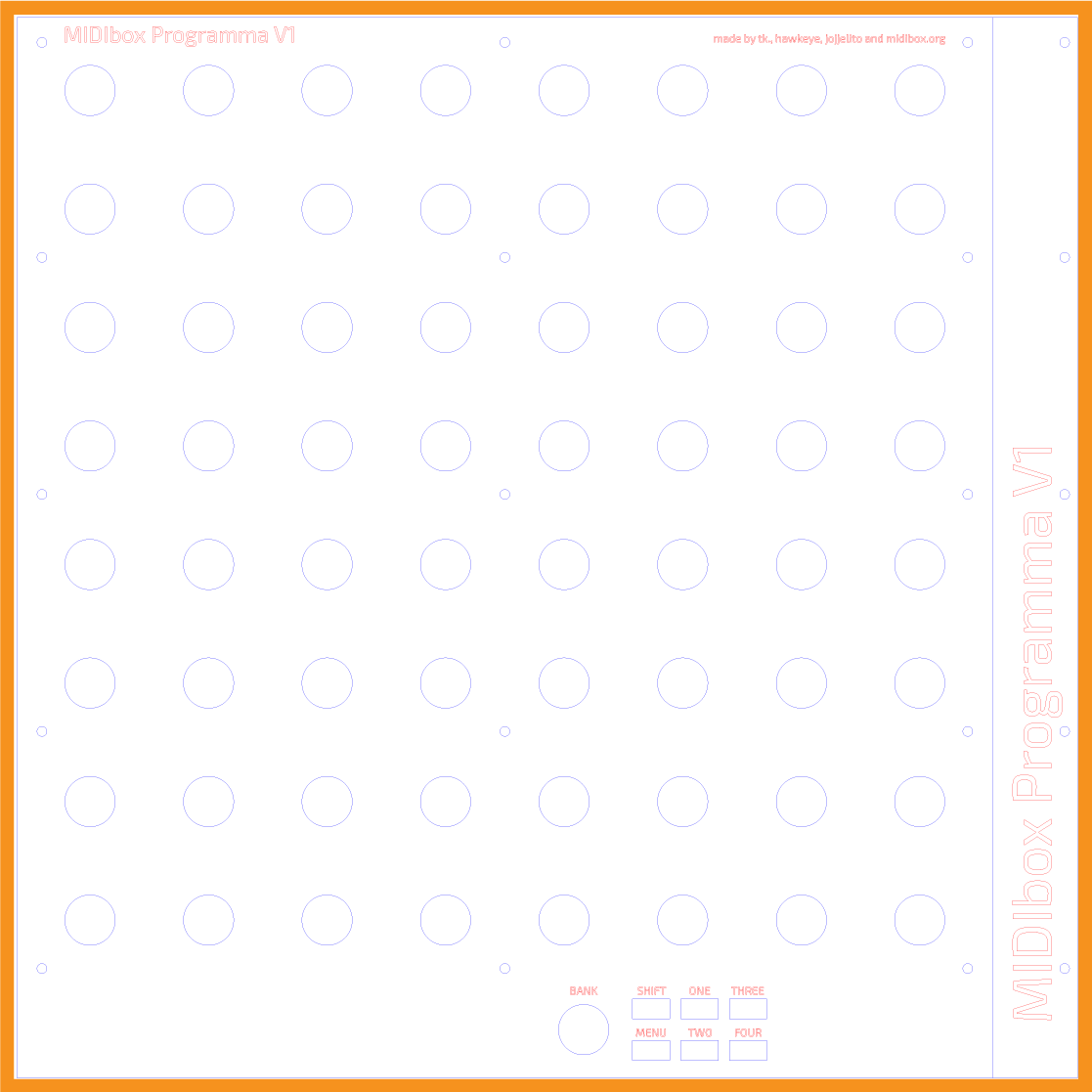

To anyone interested, i´ve attached the current formulor/ponoko frontpanel plans, the whole panel (with only one sidepiece) costs only around 40€, and it uses the maximum size (384x384mm) to the last millimeter :slight_smile: - It holds four 8x2 LRE boards and the menu system - you need to construct a (wooden) board carrier for yourself at the moment, but that is not soo difficult.
Many greets,
Peter
[mbProgrammaPonoko9.zip](< base_url >/applications/core/interface/file/attachment.php?id=11830)
