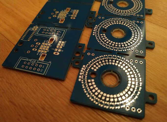

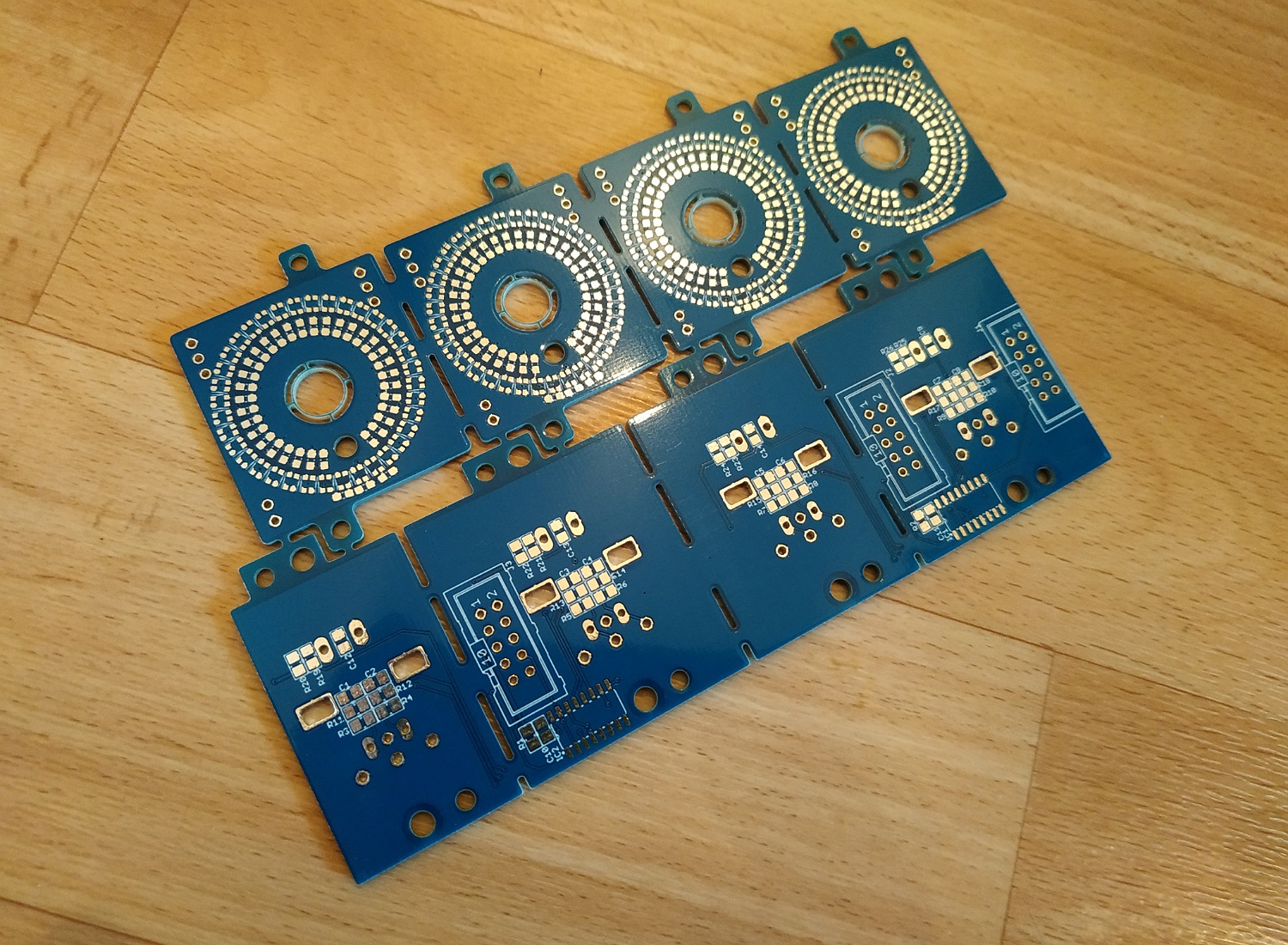

Prototypes ordered today. I’ll assemble those by myself. The batch-production we will do externally.

PCBs were shipped today. :slight_smile:

prototypes arrived today!
(just posting to try and create a little pressure on for the proto-assembly )
Yes… they look pretty :slight_smile:
