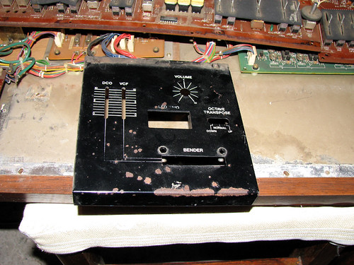

I was surprised that control surface boards looks much better. This picture I took after dusting.
As already mentioned this synth I bought from Gypsy, and Gypsies music has a lot of “bending”. This is the result of hard core usage. I conclude this Gypsy has very sweaty hands.  :stuck_out_tongue:

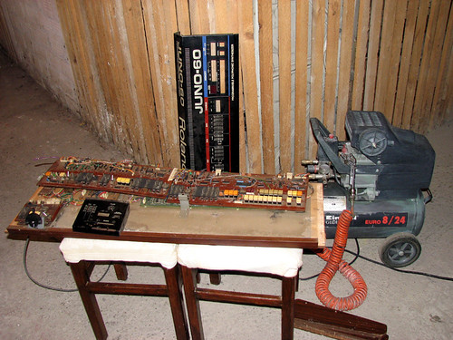

Before I dismantled it I tried it for a last time to make sure it still works.

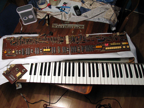

Juno-60 has 3 big boards. 2 CS PCBs and one main board. Main board is widest of all and it will direct me the width of the synth. I`m planing to mount the boards on the separate shelves one of top of other to make this synth as compact as possible.

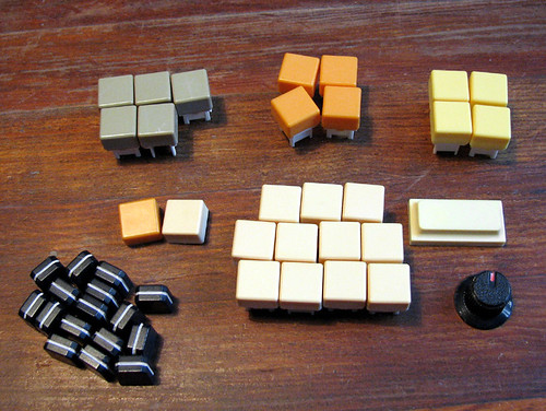

This is left control surface board. I decided it would be much cheaper to use roto pots instead of sliders. Sliders are also harder to get for me locally.
These old PCBs are really fragile. I didnt wanted to damage the traces trying to desolder the mechanical parts, so I cut the leads off. I left switches alone as they dont make any connection when depressed so I can just solder the wires in parallel to them.
This I/O board looks pretty dirty too, so I`ll probably make another one or mount the those jacks to back panel.
I don`t have any service manual nor schematic for Juno, so I needed to lable the connections so I can put it back again.

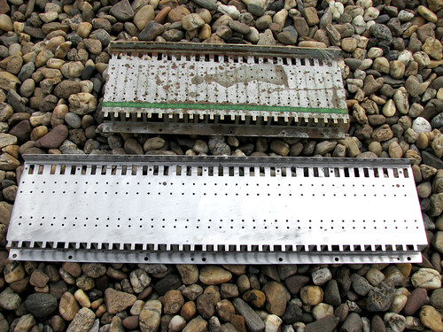

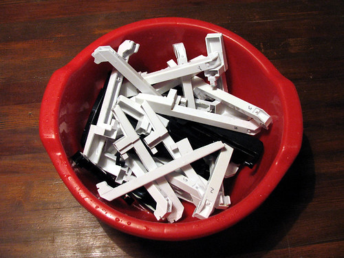

quoting myself from flikr
I asked my mother to recommend me something to clean some greasy and very dirty parts and she gave me this spray for cleaning oven. I sprayed it and came after some time. Maaan, It was magic! The dirt like is eaten alive. : ) I prepared myself for long scrubbing, but what I did… I just slightly washed it out with dish detergent and cold water. And that is how I discovered my favorite chemical (besides ferochloride)
I was so happy to see the result. I can say it is pretty aggressive to the fats so hands started to be very slippery in touch to it… like it is reacting on skin oils. It do take some cautious handling ,preferably with gloves. I guess it is designed especially for oils and fats. I tried it with different kind of metals and plastics and it don`t damage the material at all, just dirt which is very important!
I Highly recommend oven cleaner for vintage synth parts!

Oven cleaner is pretty dangerous stuff… My ex got the most nasty chemical burns on her arm from that stuff.
For cleaning keys , or mixer knobs, I throw them in a bucket of hot water with few splashes of ‘Spray and wipe’ and wait for half an hour.
I know, so that is why I cautious. I dont have to touch the keys anway. I just spray it, shake it and left still for some time and that wash it out using shower.

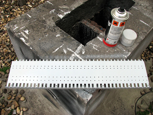

Yesterday weather let me to use my rooftop for some metal works.
I shorten this key holder by 2 octaves. It was 5 before. I wouldnt do it if gypsy player wasnt hard core smoker (he burned few keys badly).
This is the results of few minute work with grinder with sandpaper disk. Easy done, very satisfied. :slight_smile:
As this obviously isnt stainless steel I sprayed it with car primer. It will be left as is. There will be no other paint layers on top.
Good thing is that primer was fast drying as weather changed again… rain. :frowning:

Do be careful (everyone) with the oven cleaner. - That ‘slippery’ sensation is the result of a process called “hydrolysis”, and essentially, the oven cleaner is turning the oils in your skin (and by extension, your skin itself, since it is supported by the oils) into soap. Nasty.

I figured out slippery hands can mean just one thing… my hands are dissolving. I washed it right away so it didnt cose me any injury. Chemistry can be pretty dangerous if you dont know what you are doing and what dangers are, but experimentation is in my blood and I do take some risks from time to time. Just think… Albert Hofman didnt discovered LSD just by watching the lysergic acid.  He needed to lick it. And if he didnt his bike ride would never be so fun. :stuck_out_tongue:
LOL.  If you want to see if it gets you high, eat it… If you want to see if it washes your skin, rub it in… If you want to see if it cleans metal… Wear goggles, a mask, and gloves, and employ an extraction fan. Much harder to rinse the vapour out of your eyes or lungs.
And always follow the safety precautions (printed on the side of the can?). They’re not there because the company likes you, they’re there because they’re afraid someone will fuck themselves up and sue them. We don’t care about the law suit but we care about you getting fucked up.
