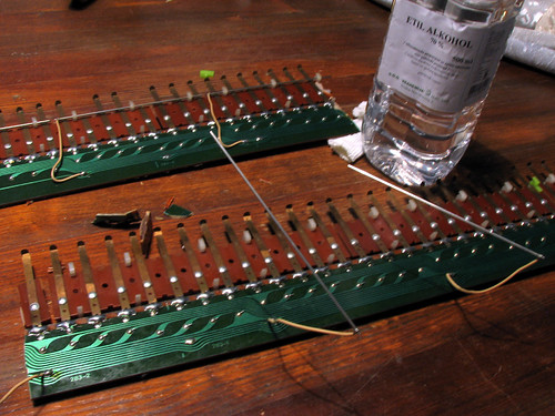

Stryd, just because I said how it reacted with skin on my hands doesnt mean I washed these keys with naked hands while sniffing the fumes in small non-ventilated room. I am experimenter, but Im certainly not stupid nor Im acting like a tough guy. I have no problem wearing pink gloves, but If Im using hands.

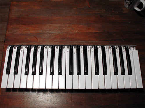

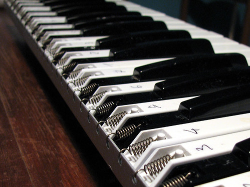

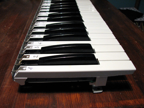

About the keys… even I shortened keyboard I was forced to use half damaged D key. As you might read, some keys were burned by the cigarette. Which one do you need? I might have it.

my broken keys are an E an F and a G, my juno took a tumble and landed right on them;  guttted  :frowning:

mrmeana, you are lucky. I have E, F and G keys in very good shape, and you can have it for free.  :wink:
Only thing is that keys must go to the local customs inspection, and I have to wright and sign 2 special declaration for it. Custom inspection is not free, so shipping of 3 keys can`t be less than 10EUR. Nothing is easy to send from Serbia.  >:( I could maybe send it in unsigned letter if post office workers  allow me, but than you might never received it which would be really pity as these are considered as a rare parts. So if it is fine for you send me an email. Thanks for this another link… Juno service manual will come in handy.

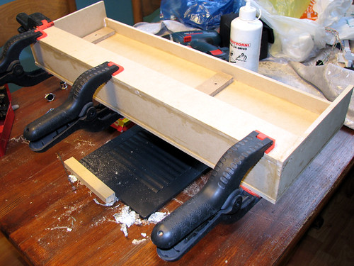

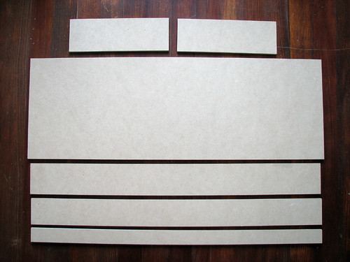

as always: superb work!  :slight_smile:
how did you get to cut such straight lines?
I always thought the lasercutter isn’t able to cut wood.
You’ve done it again man!
Thank you
circular saw did it
Laser cutter cuts woods just fine but it depends of laser power. The one I`m often using for my projects cuts woods 6-8mm thick very nice.

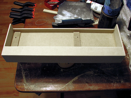

The material I used for this project is MDF. And as MDF contains a lot of glue in it, it is not suitable to be cut using lasers of any kind. It should be solid wood.

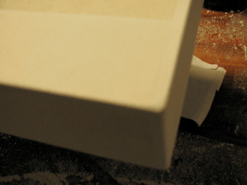

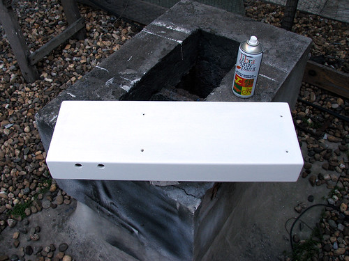

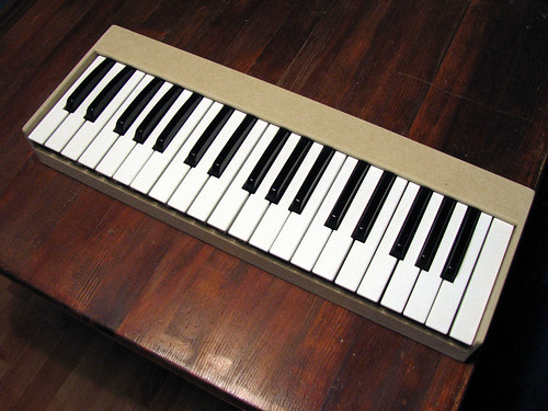

No, I didnt... yet. It needs more sanding on a daylight (during the weekend), maybe some body filling, primer painting, more fine sanding, another primer painting, more fine sanding, and 2 coats of final paint. So, a lot of work still to be done, but Im close.  :wink:
After 3 layers of acrylic primer, casing is ready for the final painting - mat black.
That’s looking really nice… Can’t wait to see it completed… I just installed the Dtronics MIDI/DCB kit in my Juno 60 on the weekend and it works fine with the quick test I did… I thought for the money it was not a bad deal…
Well, keyboard is completed long time ago, but I forgot to take picture of it. Sorry. Synth part is untouched due to the lack of money and motivation.
