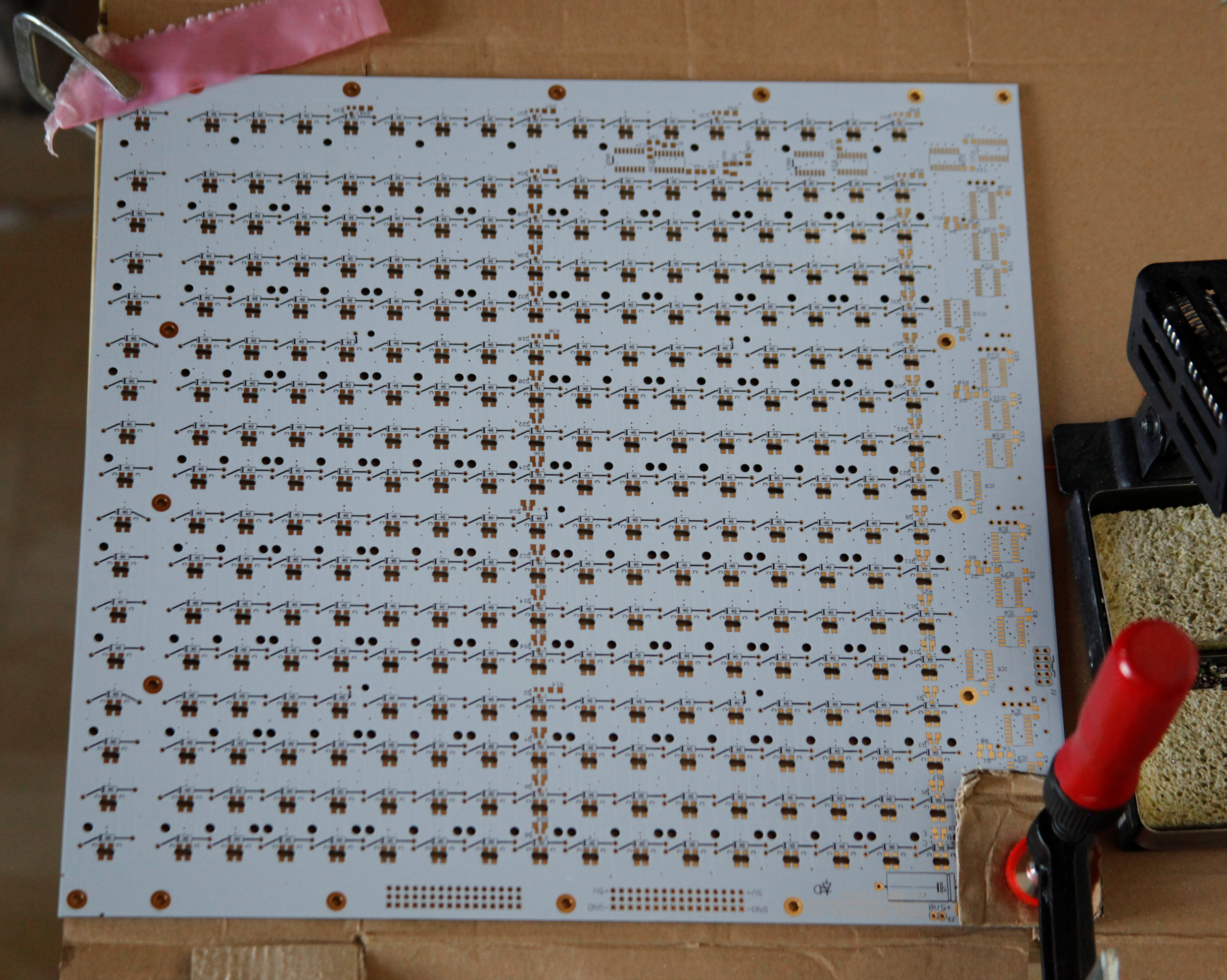

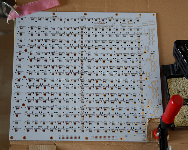

First up you should tin the pads on the rear side only. I recommend clamping the board at a right angle so you can easily go down a “row.” Tin at least the LED anodes (just the top pad!), but you could do one pad of every SMD component (over a few days it will get harder to “wet” the solder as it oxidises). It will be easier to “tack solder” if you choose a pad which isn’t part of the ground plane. Avoid pre-tinning pads with thermally isolated connections to ground.
(here the top side is actually at the bottom)

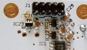

3*SOT23-5 Schmitt buffers (IC21-23)
Located near header J1. These are pretty tricky, so go slowly and use as little solder as possible. Clean up with braid if needed.

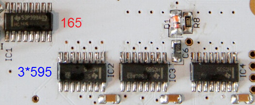

5*** 74HC165** (ICs 1, 5, 9, 13 and 17)
15*** 74HC595 **(remaining ICs)

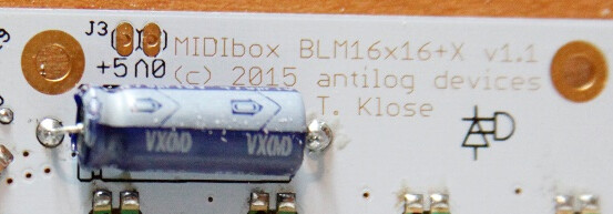

470uF electrolytic (C1)
The “minus” end is marked with an arrow, the “plus” end has an indent aligned with the silkscreen.

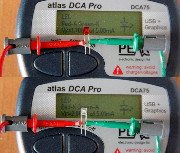

Current limiting resistors for the sliders’ LEDs (can wait to check the brightness)
You can swap the LEDs with common “2x3mm” sizes. Note the different pinouts:

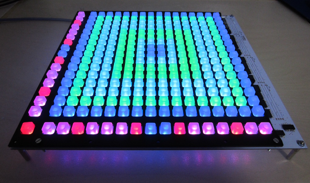

Then solder the 2x5 DIL headers. Now you can apply power to the board (either through J1 or J3) to check the LEDs and choose the through hole resistors that set the LED sliders’ brightness. 10k was good for me. Note: please don’t send clocks/serial data to the BLM with the board’s power disconnected, it might damage the CMOS.
If a Core/miniCore module is connected then without MIDI input the LEDs should light with each button press (just use a loose button pad) in sequence: LED1, LED2, LED1+2, and off again.

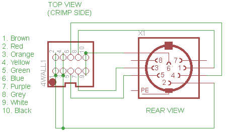

Cable wiring:
Crimp a 10 pin IDC connector on about 40 cm of ribbon. Then solder the following pins on the DIN8 socket in order. It should be possible to do this outside the case and thread the IDC through the mounting hole. Thereafter a DIN8 cable can connect to the corresponding SEQ BLM connector, but you may want to wait to install everything together in the case.

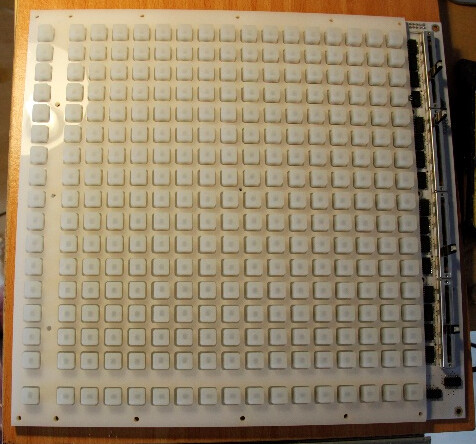

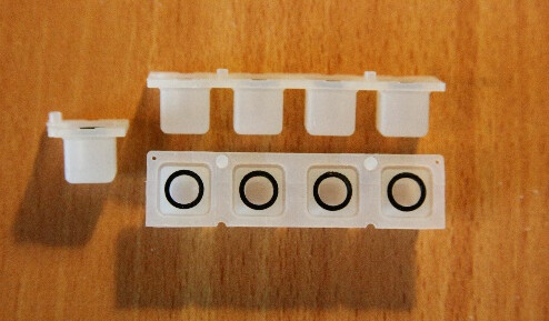

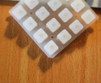

Carefully cut 16 pieces of 1x4 buttons ensuring each has the two guide nubs at the bottom. I recommend scissors instead of a knife to keep it tidier as the silicone tends to unhelpfully flex under a knife. Also cut the corners off pads where M2 grub screws will enter from the front. Now the button pads may be placed (oriented so the nubs fit in the correct PCB holes). It’s best to go from one side to the other to keep everything flat.

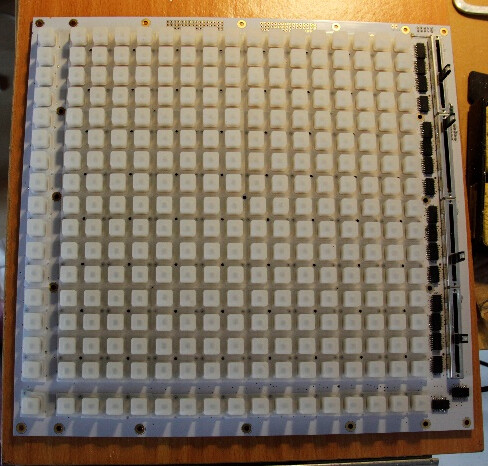

Spacer
Then place the acrylic spacer on top (mine is a bit different). There are extra rings of acrylic which can be used as “washers” to make up for the top and bottom right corners. You might want to add thinner metal washers as well to get the distance right.
When ordering the spacer (e.g. from Formulor or Ponoko) make sure to choose opaque acrylic in 3mm thickness, probably white or black is best. If you buy milky or clear plastic some LED bleed might occur.
[BLM_spacer_3mm_acrylic.eps](< base_url >/applications/core/interface/file/attachment.php?id=12208)
Apparently this one is better optimised into vector format, many thanks Phatline:
[BLM_spacer_3mm_Formulor.eps](< base_url >/applications/core/interface/file/attachment.php?id=12309)

Lift the PCB into the case from the bottom (so your 289 buttons don’t fall off) and loosely attach at least a few corners with M3 nuts. You need at least the centre M2 grub screw and can add the other four M2 screws if you feel more stability is needed. It’s probably best to thread them through the PCB from the rear; be careful as the thread pitch is quite fine (0.4 mm) and is cut into soft aluminium. I haven’t noticed any unscrewing, but you could add a drop of Loctite to be sure.
Two M3x12 MF spacers attach on the top left corner (viewed from the back), this is where the miniCore will go.
Next tighten the remaining nuts evenly; don’t overtighten as the PCB will flex! As long as the button pads were placed more or less in the right place they should sit evenly above the front panel. Or they may require reseating to get things even.

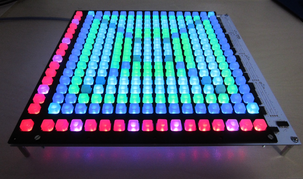

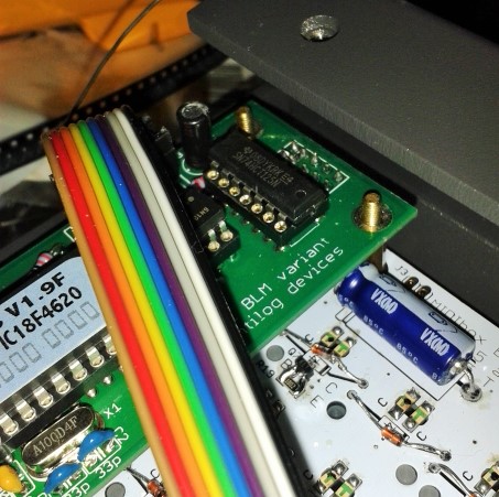

Attach the miniCore module and a ribbon connector to J1 and panel mount the DIN socket. You need to jumper 4 unused AINs on the miniCore’s J5B to ground which will prevent noise on these inputs.

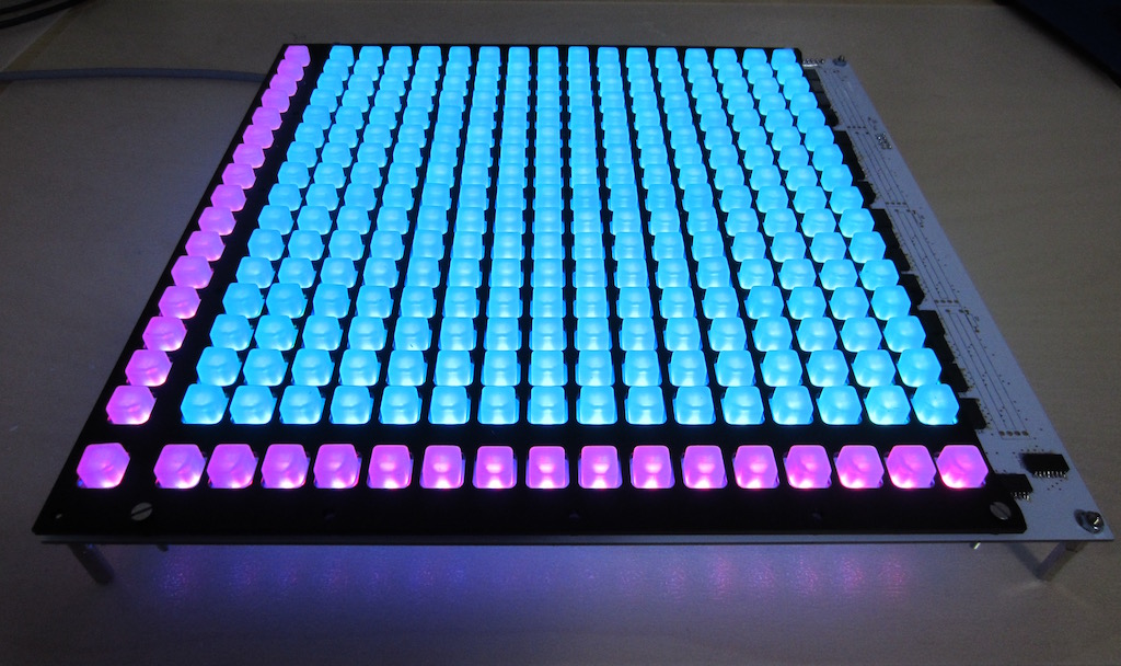

Then close up the case, attach the bottom feet and you’re done!
Congrats on finishing your BLM and I hope you enjoy using it!

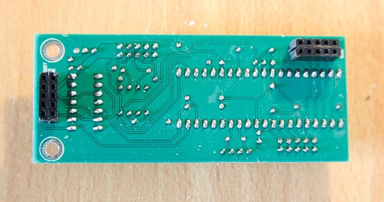

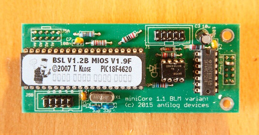

miniCore:
Nothing too special here, just remember to mount the resistors first (i.e. before the DIP40 socket). The BLM data lines are buffered on the main PCB so potentially the 74HC125 chip could be left out. Also keep in mind that the female DIL header sockets must mount on the rear of the board. You can see that I made do with SIL versions that I cut into rows of five.
Note: you can also use a PIC18F4685, currently stocked by SmashTV.

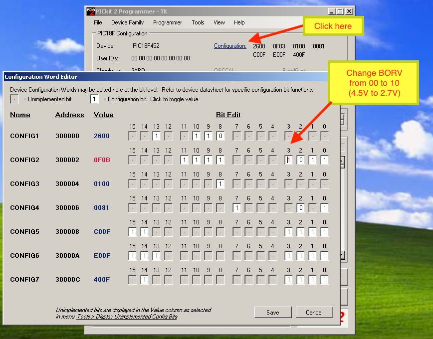

2) if you are using a PIC18F452, it’s required to change the PIC device configuration while flashing the bootloader: the brown out reset level has to be changed from 4.5V to 2.7V as shown in this picture:
Otherwise PIC could be reset sporadically (depending on the number of enabled LEDs) because the voltage level could fall below 4.5V!
This change is only required for PIC18F452, other pics (such as PIC18F4620 and PIC18F4685 will work w/o this change).
Unfortunately this change can only be done with a PIC programmer. Please contact TK. if you don’t own a PIC programmer. He could send you a replacement PIC18F452. Alternatively use a PIC18F4620 or PIC18F4685 if you own one.

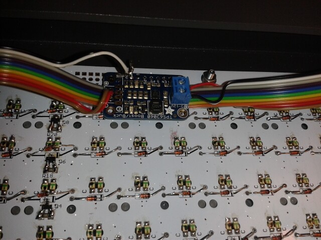

It seems like some form of local power regulation is needed to ensure stable operation. As noted above, some PICs have brown-out detection built into the bootloader, so when many LEDs are lit, the PIC resets and won’t work until the voltage rail stabilises over +4.5V. The simplest way I found was to interrupt the 5V line after the DIN socket (inside the BLM case) and add an adafruit Verter Buck Boost regulator. Mounting is stable using a SIL header on one row of the  blank  muck space, this can be connected to the unused functions on the small PCB.
Power consumption
  • Using the Verter, standby voltage and current is 5.2V and about 30-60mA.
  • With all LEDs lit (both colours) the draw goes up to 647mA, although this would never be done in normal operation.
  • In track mode with all 16x16 blue LEDs lit the draw is 467mA and the voltage drops to 4.72V. I don’t really perceive a difference in brightness, but it could only be a good thing! As long as the ADC inputs are scanned relative to the supply voltage you shouldn’t lose control at the top end.
A new BLM has been born
Very nice to build, no big troubleshooting required if you are careful enough and don’t forget a solder joint or create an unintended short.
Andy deserves great respect for his sophisticated design, this is really professional work and sets a new DIY standard!
Although the BLM16x16+X project is 5 years old meanwhile, you still can’t buy a device with 290 buttons and duo-colour LEDs - you can only build it by yourself - and it has never been easier!
Best Regards, Thorsten.

It took me around two days (ca. 15 hours) - at the first day I soldered 1N4148 diodes and LEDs, and at the second day the remaining parts. Over time I became faster with SMD soldering, but still ensured that parts are correctly aligned - especially for the LEDs it’s important that they sit flat on the PCB, otherwise later they could illuminate in different directions so that you won’t see a combined colour through the affected silicon pads later.
Therefore the important hint: always solder only 1 pin (tacking), align the part, then solder the remaining pin(s), otherwise you can’t fix the position anymore without desoldering the part! This way I tacked one row of LEDs, fixed the positions (when necessary), and then soldered the second pin. The same for any other part - it brings a little bit variety in the boring soldering process :wink:
To the colours: In difference to Andys proposal I took blue as “colour 2” (right side of the bottom PCB) and green as “colour 1” for the left side, but this was my personal preference. Don’t worry, the firmware allows to swap colors if you are unhappy with your initial decision! :slight_smile:
For the extra row/column and shift button I took red as “colour 1”, and blue as “colour 2” again.
Therefore (and I only write this as an important reminder for the case that somebody wants to do the same) I had to swap the resistor networks: 220 Ohm for the green/red LEDs (RN3, 7, 11, 15, 19) and 56 Ohm for the blue LEDs (RN4, 8, 12, 16, 20)
