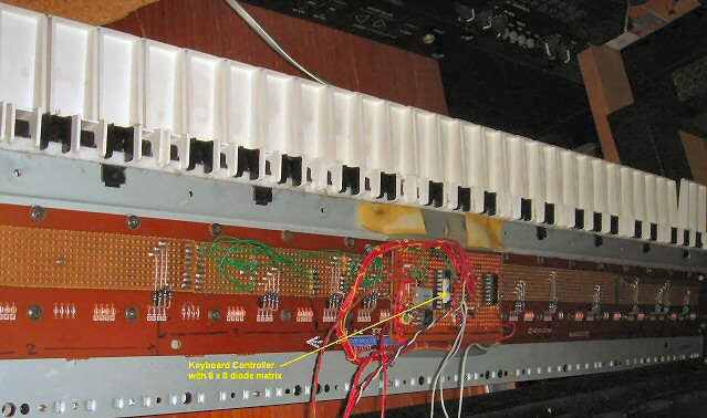

After much thought and for flexibility, I have decided to use the midibox64 and configure it as a controller the B4 organ simulator. Not all the control functions on the B4 are implemented. My midibox64 consists of a Core with AIN x 3 module, DIN x 4 and  DOUT x 4 modules. The AIN module caters for 24 pots, 17 are allocated for the drawbars (9 for the upper manual and 8 for the lower manual) and the rest are assigned to control of other variable functions. The DIN and the DOUT modules are used as toggle switches for voice preset selection, rotary speaker on/off, fast/slow selection and so on.
Two midi keyboards are used as the upper and lower manuals which when integrated with the midibox64, in my opinion,  makes a  good playable organ system. I did not use the pedal board of the B4 as it does not have the sustain function. Instead I am using an external pedal board with a sound module to provide for the bass. The project has finally been completed and the system works well. Here are some pictures showing one of the midi keyboard, the electronics of the controller, the finished controller and the completed system.
