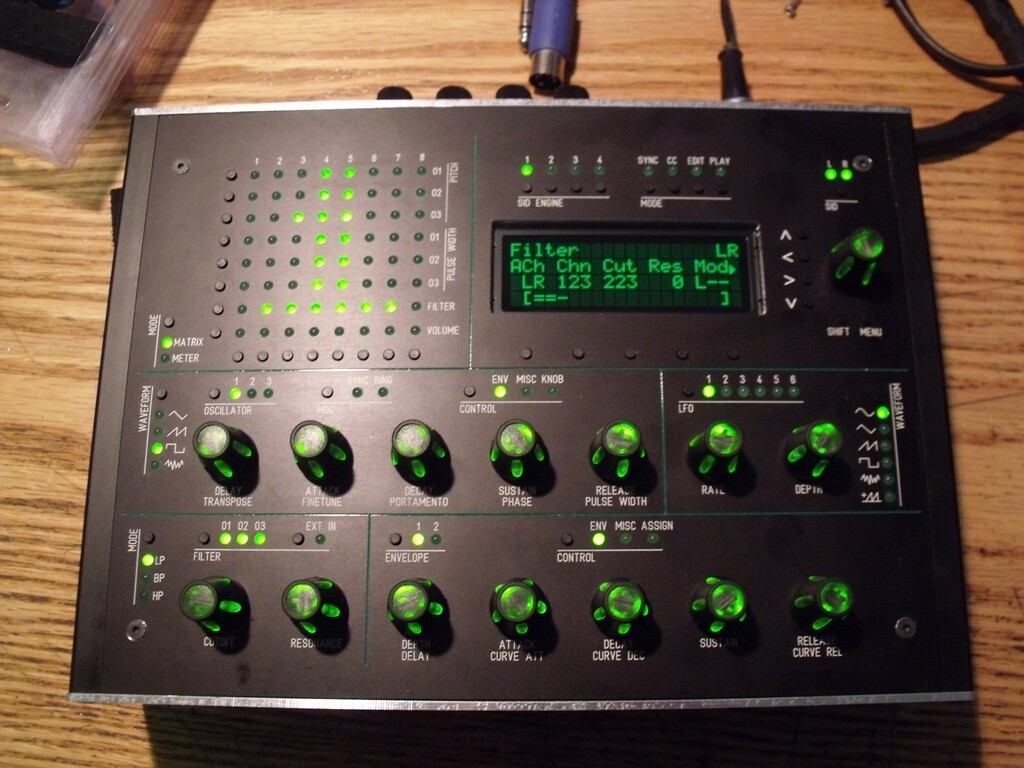

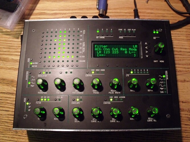

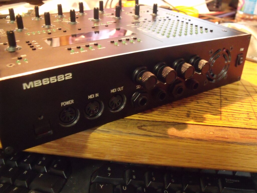

So I’ve been meaning to do this for a while but the costs were pretty ridiculous at front panel express but I now use CAM expert where the prices are much more reasonable,  This is the type 2 profile, you lose some real estate on the back panel so the D connector and mix out have been removed

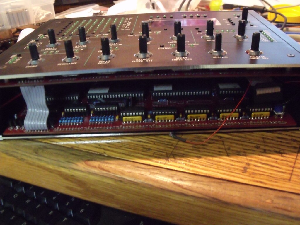

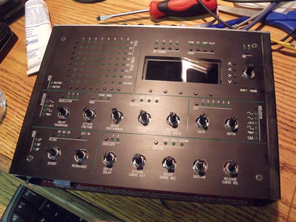

I’ll post the files once I have finished mine and checked everything out.  There are some differences in assembly and parts (9mm standoffs instead of 10mm since the front panel is 2.5mm thick).  It still was an expensive case ($225) but when you figure the panel and back from front panel express will run you ~$150 plus the pactec case and shipping will be another $50, it doesnt really end up being that much more.
