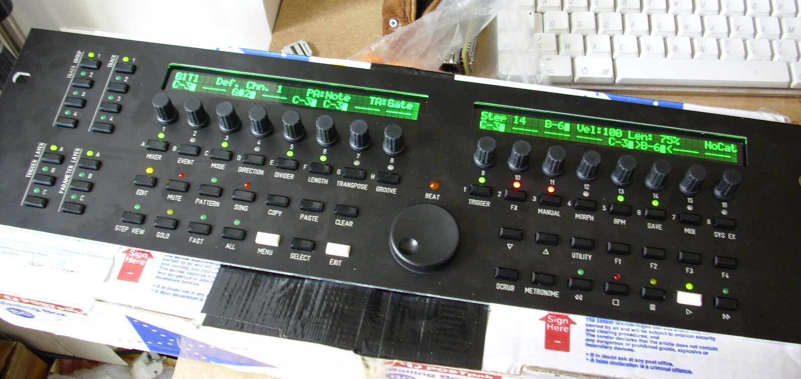

i just finished the assembly of this so perfect wilba control surface (very pleasant to tweak, more than the majority of my others machines) and noticed that the step view led has a 4 leads footprint ; why ?
i plan to put the core32, the CV/Gate jacks, the midi sockets, the ethernet on a 2 U rack and use a DB25 cable to connect this “tower” to the LCD + J8/9 , control surface sitting on my desk, so that all the cables stay in the backyard of the studio. What’s your opinion ?

The PCB allows the use of two single-colour LEDs above the Step View , in case you wanted two LEDs to indicate “Step 1-16” and “Step 17-32”. But that is optional, you can use just one LED like all the other LEDs. At the time of prototyping, TK preferred a single LED, and I made my panel the same, so it just got ignored and forgotten and maybe no one has ever made a panel with two holes there.
Gunars may be confusing Step View with the Beat LED, which on mine and TKs (and a few others I assume) is a 5mm round red LED, but someone sufficiently motivated could use a bicolor LED (common cathode) and connect it to J3… and then maybe beg TK to make the other colour do something (eg. red on every 4th step, green on other steps). You might ask why I didn’t just put a 3-pin footprint at the Beat LED position - refer to my original prototype and how it was split into halves right through this LED, as well as the difficulty of combining a 3-pin and 2-pin LED footprint… i.e. too hard. But I left J3 in there anyway. My PCBs tend to have a lot of easter eggs :smiley:
