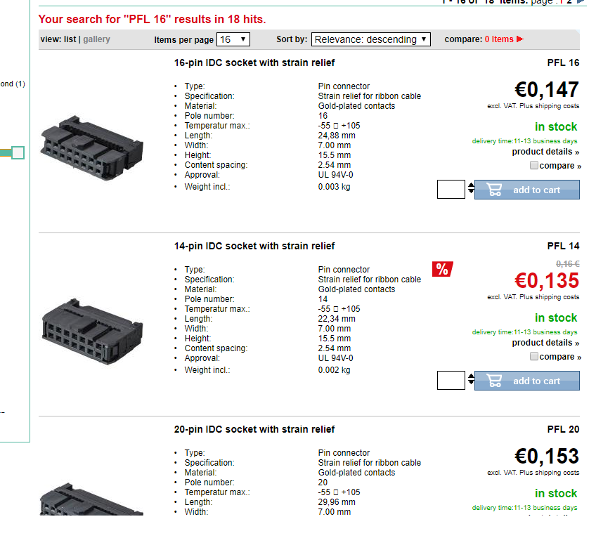

The part numbers for Reichelt are PFL 10 and PFL 16. I tried to post a link, but it didn’t work.
