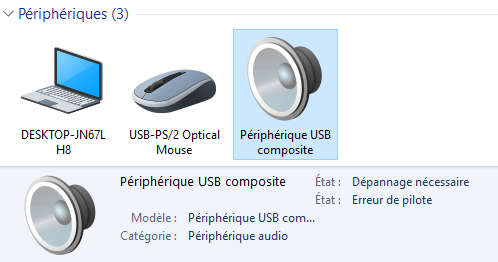

But there is also clearly a Win10 issue. If I go to configuration panel when app_skeleton is running, here is what Win10 tells me
(Ok, it’s in French sorry)
The MBHP does not appear as a MIDI interface but as a composite device (so, there is an enumeration issue. The MBHP is composite : MIDI + Audio, both should appear here)
And the status reported below is “driver error” (while everything works fine on Win7…)

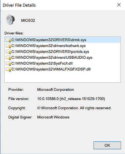

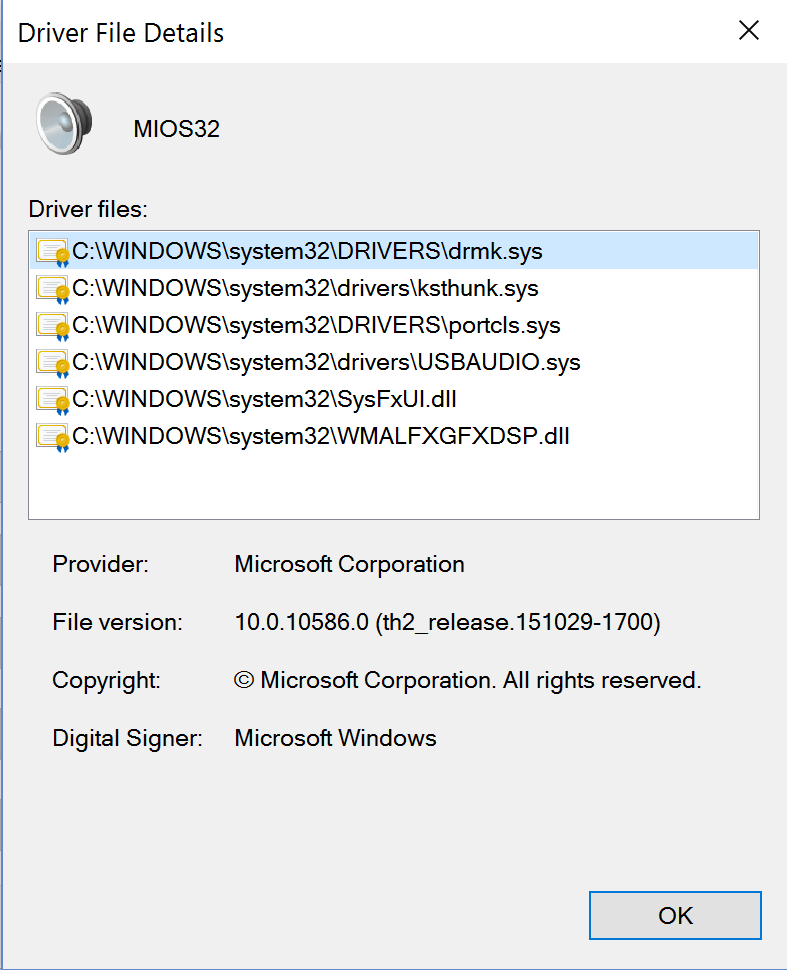

Mine’s listed as MIOS32 with the following drivers:
