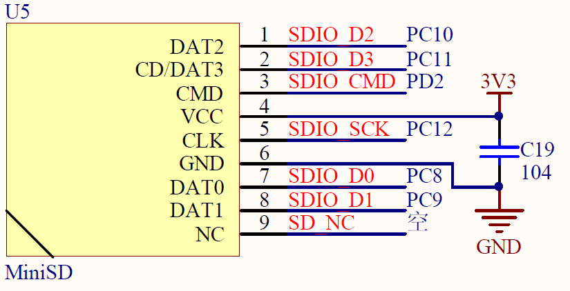

I try to modify the pin definition mapping between MIOS and hardware because I use a STM32F4VGT alternative board with a sd card directly implemented and the pins are differents for the midibox standard pins.
I need to swap this standart Midibox Ports to this new ones :

All pin of the STM32F4 are General purpose I/O(GPIO) but they have limited alternative functions.
The pins for this SD Card are used for other ports/peripherals.
PC10 is used for the onboard DAC(Disco)
PC11 is the LCD Read/Write
PD2 is the UART5 RX(MIDI)
PC12 is the UART5 TX(MIDI)
Etc…
So you will have to remap more than this pins, cause the functions you remove has to move on an other pins, to get all MIOS32 ports available and avoid conflict.

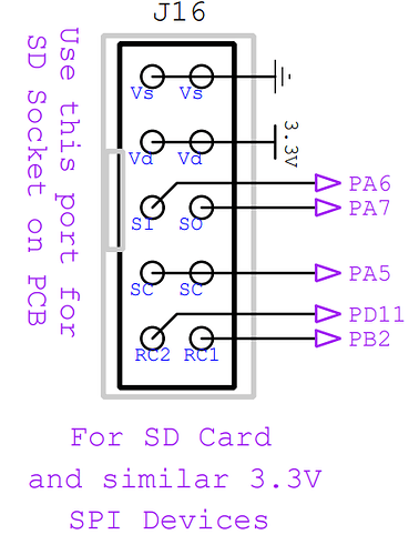

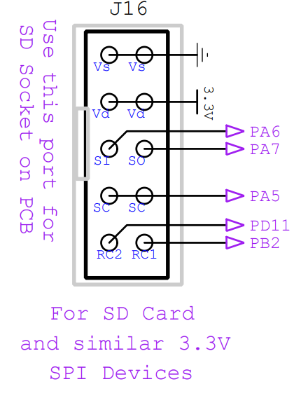

SD Card can be shifted to any predefined SPI port J16(default) J8/9(SRIO) and J19. They are unfortunately not defined over your requested pins.

Okay, And for shifting SD card to J16, J8/9 or J19, how can I do that ?
Put it on J16 which is 3V3, J8/9 is 5V and reserved for SRIO, J19 is 5V too.
http://www.ucapps.de/index.html?page=mbhp_sdcard.html
