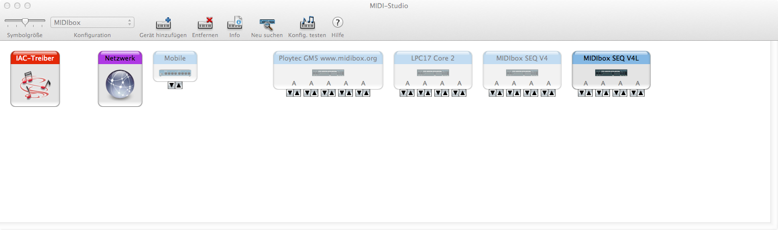

If you only see a single USB MIDI Port: Did you already update the USB Interface definitions in the Audio/MIDI Setup of MacOS?

After the update, you have to:
  • enter the Audio-MIDI-Setup of MacOS
  • disconnect the core module from USB
  • delete the interface in the Audio-MIDI-Setup
  • connect the core module to USB again
Thereafter you should see an interface with 4 USB MIDI Ports:
Best Regards, Thorsten.
