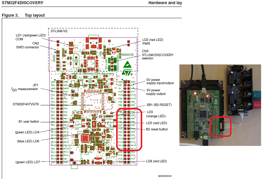

thank you, the CORE_STM32F4 sounds interesting. I see I can order the STM-board from many places, like e.g. this one: http://shop.mymcu.de/index.php?sp=article.sp.php&artID=200072 .
About the lower board shown (see after "Soldering guide in http://www.ucapps.de/mbhp_core_stm32f4.html ) … do you know if it’s available as a finished product (Couldn’t find it; perhaps I don’t need it for my application?) ? Where to buy the MIDI-connector board http://www.ucapps.de/mbhp_midi_io.html ?

Ok, I understand I have to install, upload, bootload some thingies to make the STM32F4-Discovery-board run .
One thing I couldn’t find out: if I want to attach just one MIDI-OUT connector (supplied from my USB-keyboard attached to the STM32F4-Discovery-board), where to connect it to the board? I.e. what are the relevant  pins from the Discovery board?

Thank you latigie on,
yes, I saw those and was hoping for a shortcut. Example, just guessing: “connect port PD4 to pin 4 of MIDI out, and ground MIDI out pin 5, both via series res. 220 ohms”. Sth. like that. Else, it’s prone to errors (and I’m good in making those :wink:

Just wondering, why nobody was willing to reply to these questions, yet.
For the port-to-MIDI wiring the problem comes from the grey cable connecting both modules: which pin wires to which pin? That’s not 100 % clear from looking at the board schematics. I can guess it, but I prefer to know it.

For your wiring question: you have all the info you need in the schematics. As you choose to use a non-standard method (would be very simple with the carrier PCBs) you will have to join the dots yourself.
Hi latigid on,
I was contemplating about your answer for a while, which I percieved, without trying to be offensive, as questionable.
However, luckily the information I was looking for in fact can be found in the schematics. For the quick reader:
  • connect port PA2 to connector MIDI OUTA
  • connect port PD8 to connector MIDI OUTB
  • include the 2 resistors of 220 ohms, each, as indicated in the MIDI_IO schematics.
For details please check:
So non-standard wiring, as you called it, is pretty straight forward. See, simple question, simple answer, especially when the hardware is  available (which I don’t have) for an ohmmeter or so. As I assumed the support board, the grey connector cable and the MIDI_IO board just form a long wire with some complicated geometry .. but it remains just a wire-connection. (The LEDs and their buffers parallel to J1/J2 may or may not be used.)
