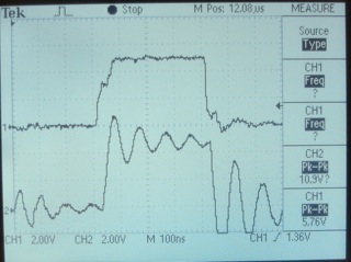

Here an extreme example (it’s not a MIDI signal, but I just want to illustrate what could happen):
As you can see, the signal can get negative transients below 0V, and positive transients above Vcc
Now let’s have a look into the Datasheet. It lists a maximum reverse input voltage of 5V, means: if the signal spikes below -5V, the internal emitter diode could be destroyed.
I’m unsure if the emitter is in real danger (and I don’t want to try this out), but if you compare with the reverse voltage of a 1N4148 diode (75V), you can see the difference - safety first! :wink:
