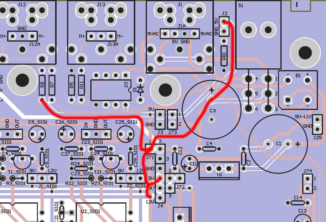

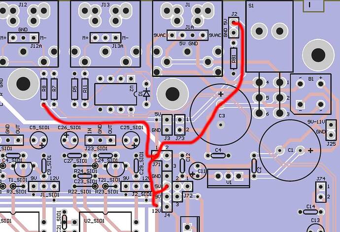

Try adding wires like this picture… that should bypass any problems with J73 being totally stuffed.
You may not need to do all these connections.

Yes, you say J73 has damaged pads/tracks and is probably the cause of no 5V after this point, i.e. at J4.
J71 and J72 seem to be good if you are getting 9V at J4. So leave J71 and J72 alone. They are not the problem. Missing 5V at J4 is the problem, and is probably only because of a problem at J73.
Solder wires as shown to connect up the 5V tracks which are not being connected due to J73 being damaged.
The red wires also show what SHOULD be connected by J73 being bridged correctly… i.e. points which should be 5V for PSU option A.
I have just rewired it according to the image but I don’t still don’t have the 5V. Maybe I should try PSU option B?
Basically you should have 5V at C3 “+” pin. Right? TEST IT!
Connect this to the other places shown. Maybe you forgot to connect it to C3 “+” pin.
Again I’m assuming the track between the power switch and C3 “+” pin is good. TEST IT!
You need to actually do some troubleshooting for yourself now. If I say “connect a pin with 5V on it to J4” then that means you need to actually solder a wire and test that it is connected, not just report back “no it doesn’t work”.
Use the continuity tester on your multimeter (or resistance tester) and test which points indicated by the red wires on my diagram are connected (i.e. ~0 ohms) and which are not. Including C3 “+” pin.
Ok, thanks that was really helpful. Now I know how to test continuity with my multimeter, which lead to the problem at C3 + pin. On of the patches came of so i had to scrape of the track (5V rails) and connect it to the eloctrolyte + leg on the sunny side of the PCB with a bit of wire. Also my ground pin for the capacitor at C3 was ****ed so I connected it with a wire to J25. Can I connect it to the neighbouring vacant C13 gnd pin?
The rewiring you suggested earlier solved my problem (or perhaps and more likely the break in connection between the patches at C3) as a result we have 5.05 V reading at J4.
