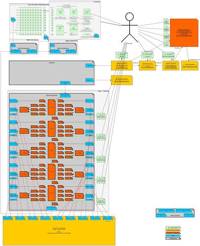

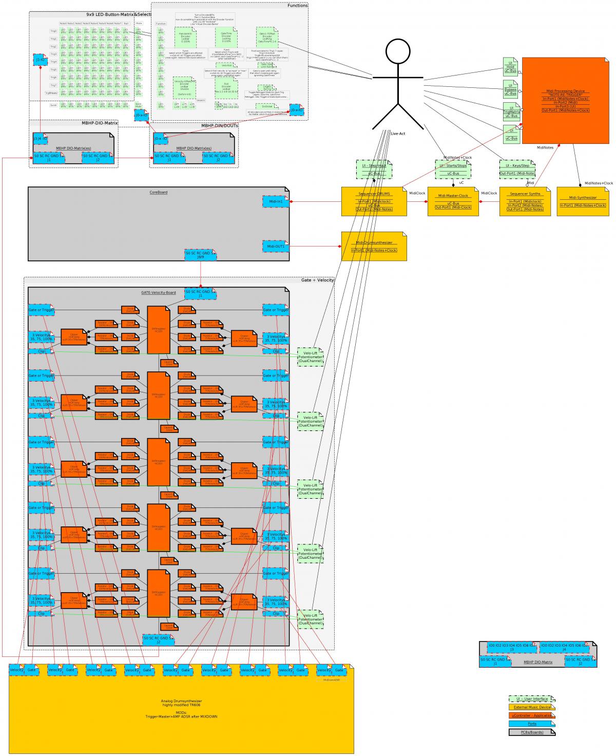

Growing Details > TriggerMatrix for Drummachines
Triggermatrix built in a analog 70s E-Home organ “CRUMAR 198”:
https://player.vimeo.com/video/137671745
or as Drum-Trigger-Matrix built in a 80s Analog Drumexpander “Tama Techstar 306”
https://player.vimeo.com/video/115565118
