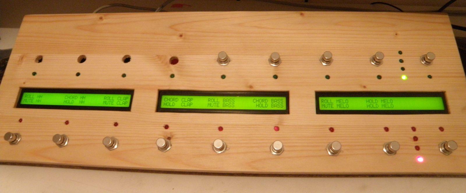

Footboard Controller with 8 Hardware buttons and more Virtual Buttons accessable via 3x 2x40 LCDs…
built for my guitar-syntharist - cri derntl

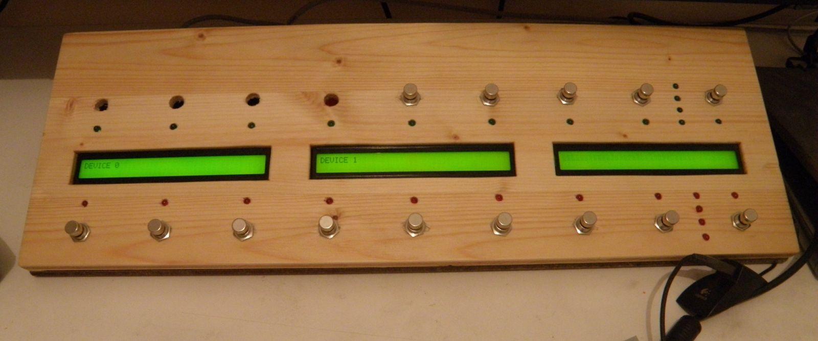

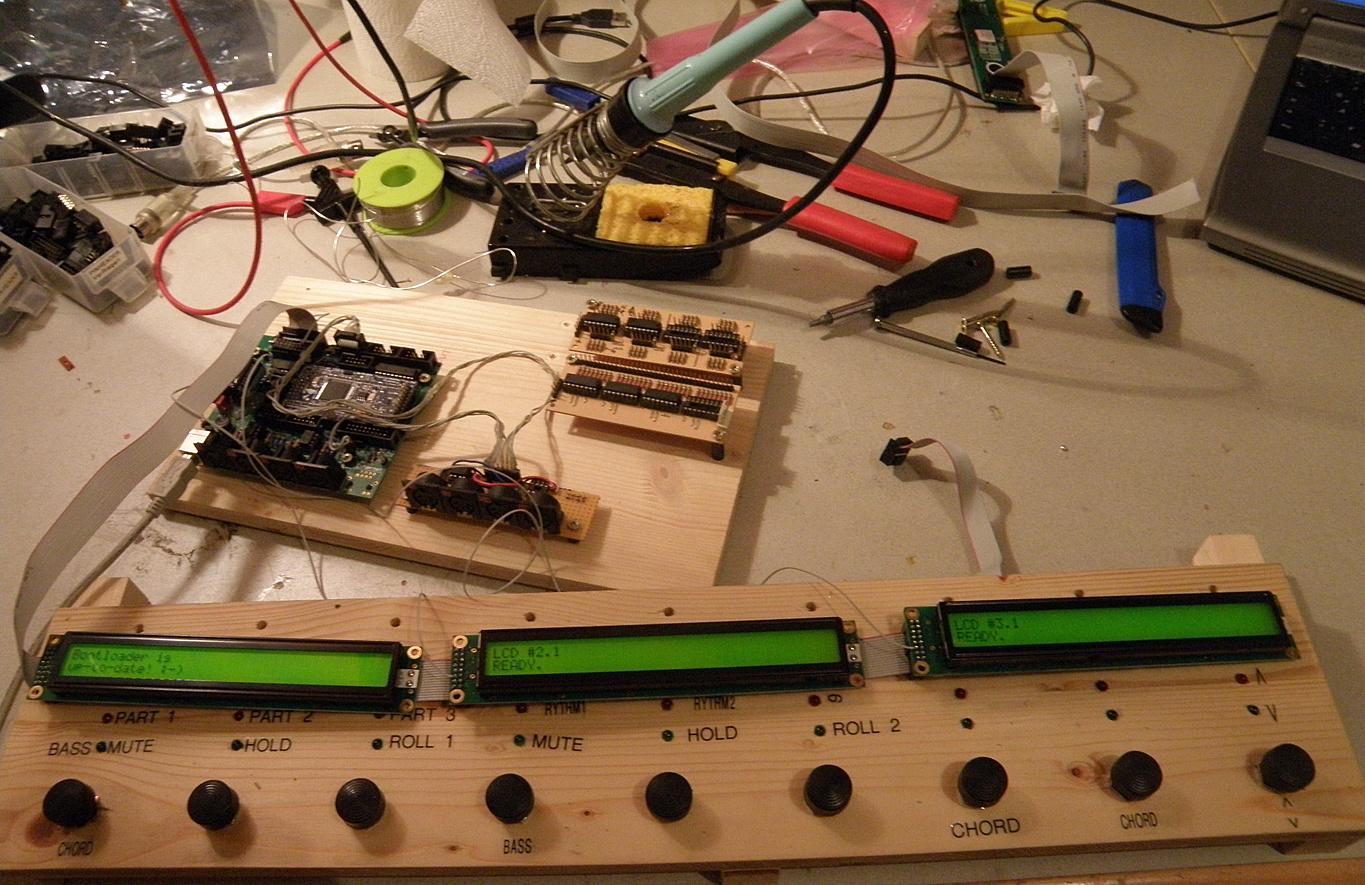

TM-Footboard-3x2x40 LCDs running
3x huge LCDs? no problem with mios…

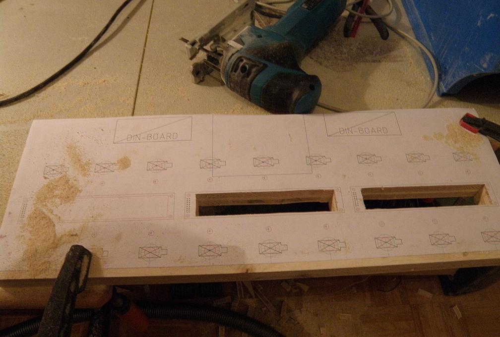

FB OSC 01 Draft
clue the Plot on 2 equal sized Wood-Plates - 2 to avoid that bunk offs… (das ned ausfraunst)

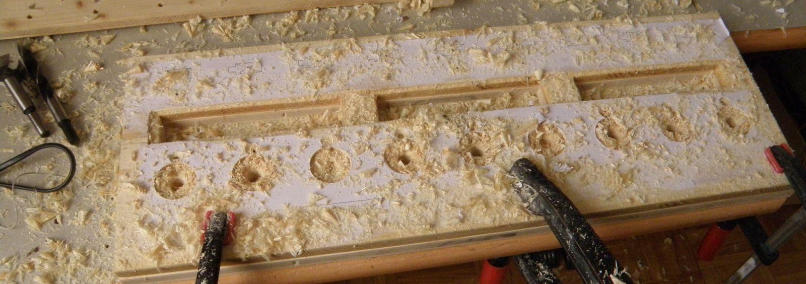

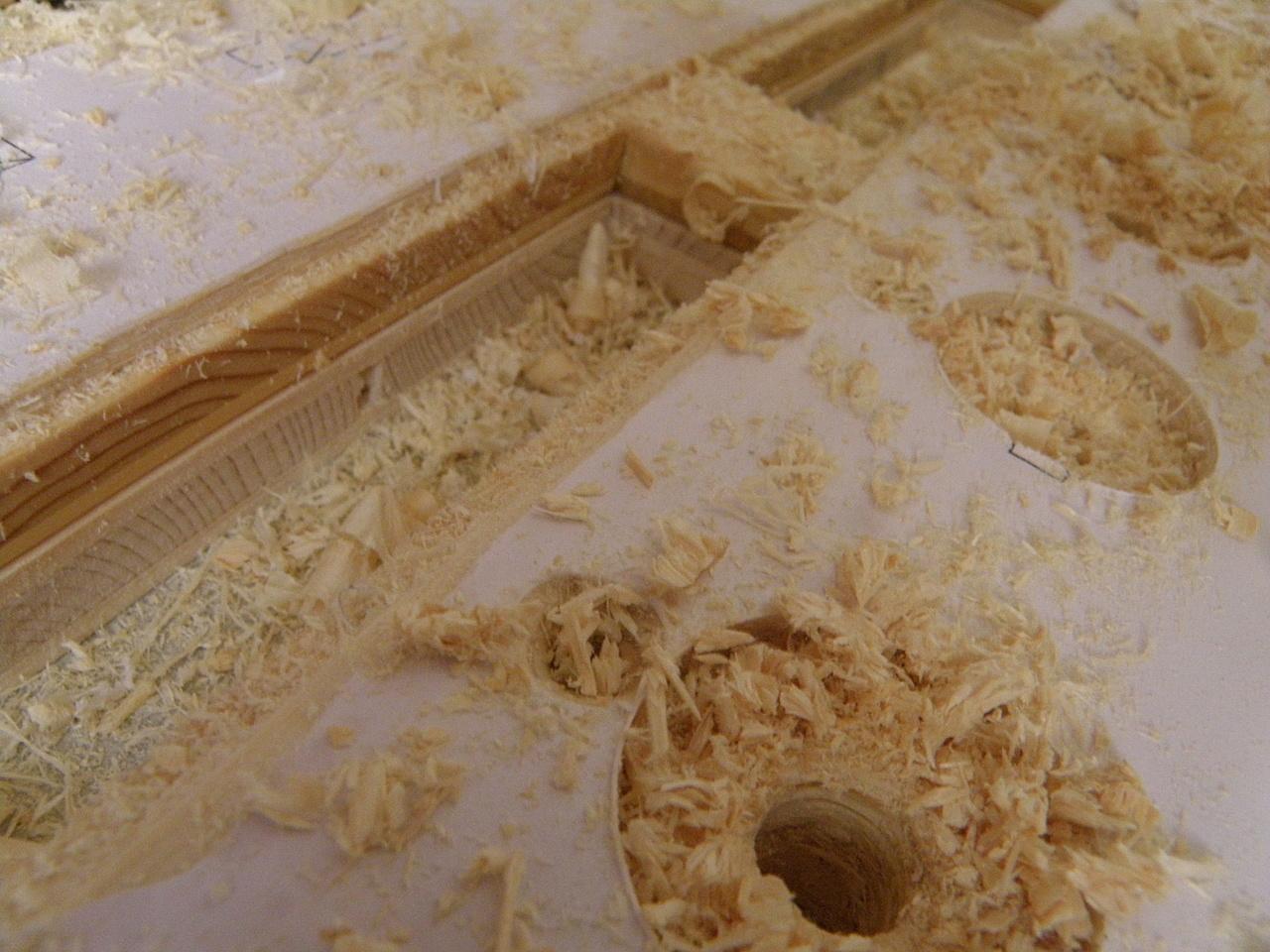

FB OSC 02 Cut
TRI-Layer -Wood Plates… easy to remove one layer…with a chisel aka “Stemmeisen”
FB OSC 03 Drilled
like it

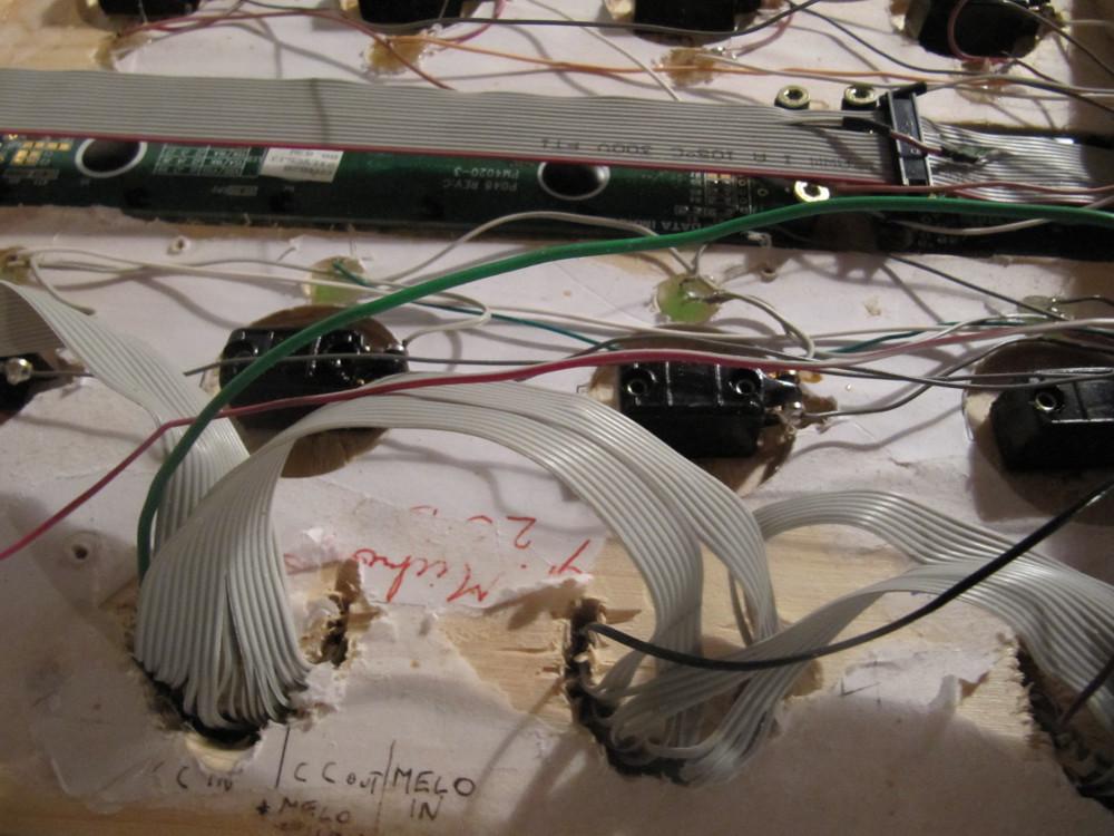

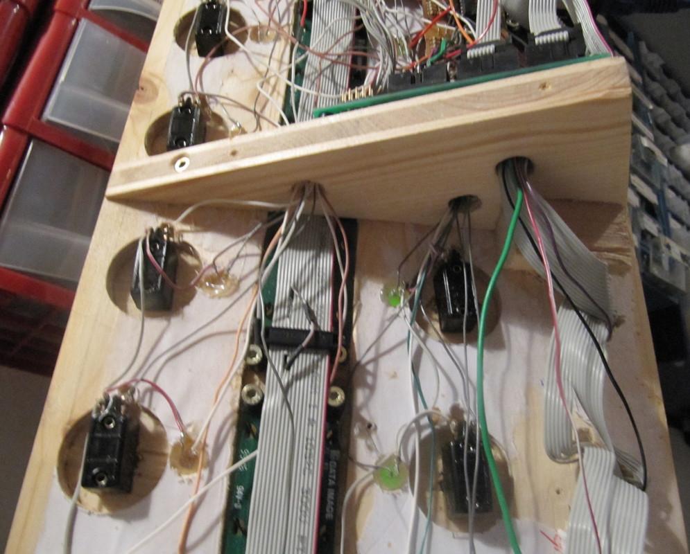

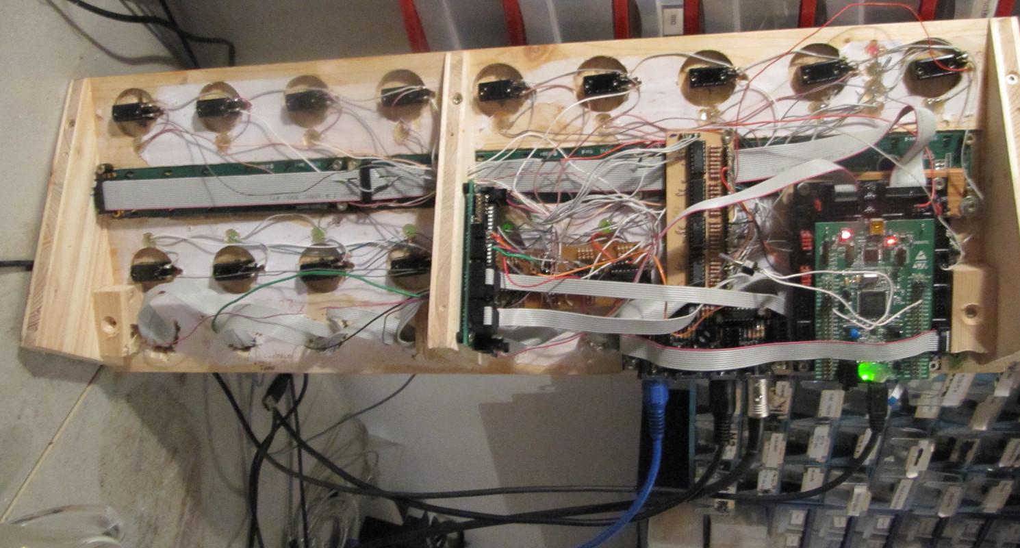

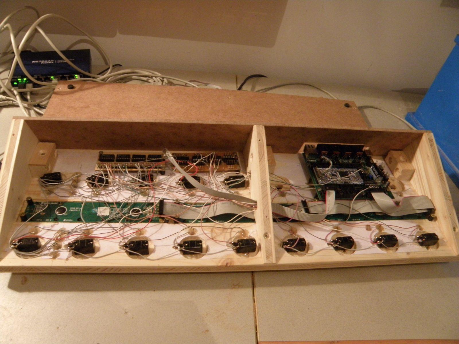

FB OSC 04 InnerLive
MIOS32 inside @ the back youl see the router…this will be a OSC-Footboard

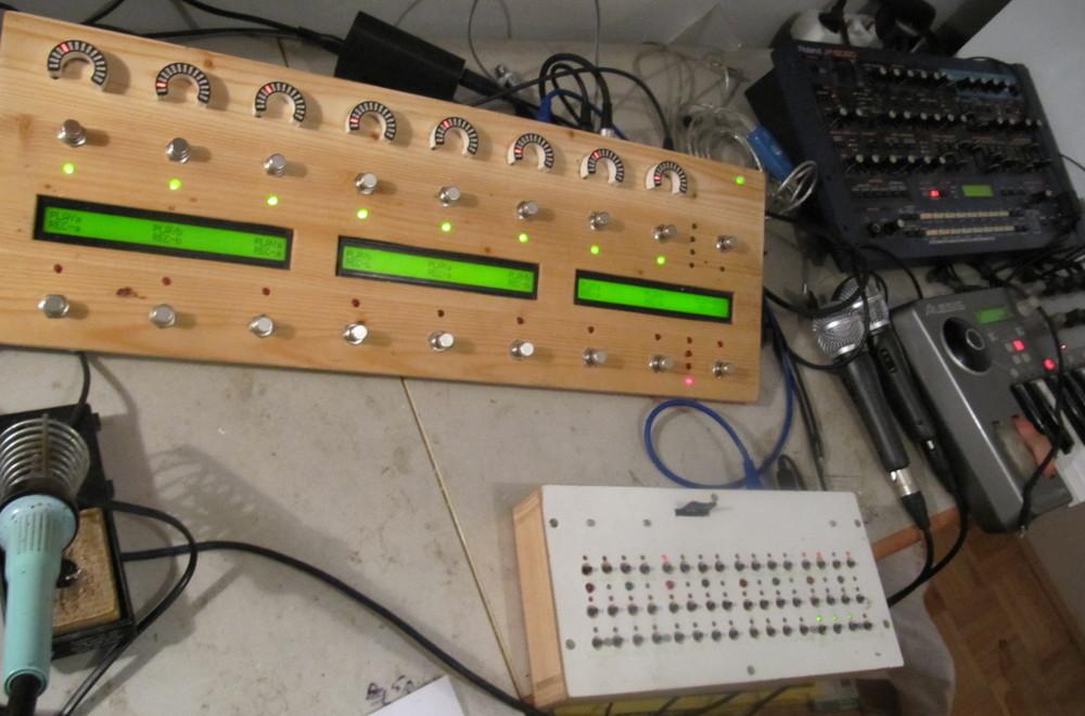

FB OSC 05 NearlyFinished
I dont have enough switches… and i haveing problems to activate the 3rd Display in may application

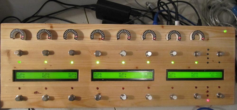

FB OSC 06 3rdDisplayWorking
3rd Display is working: had software/hardwareside- problems, but solved:
