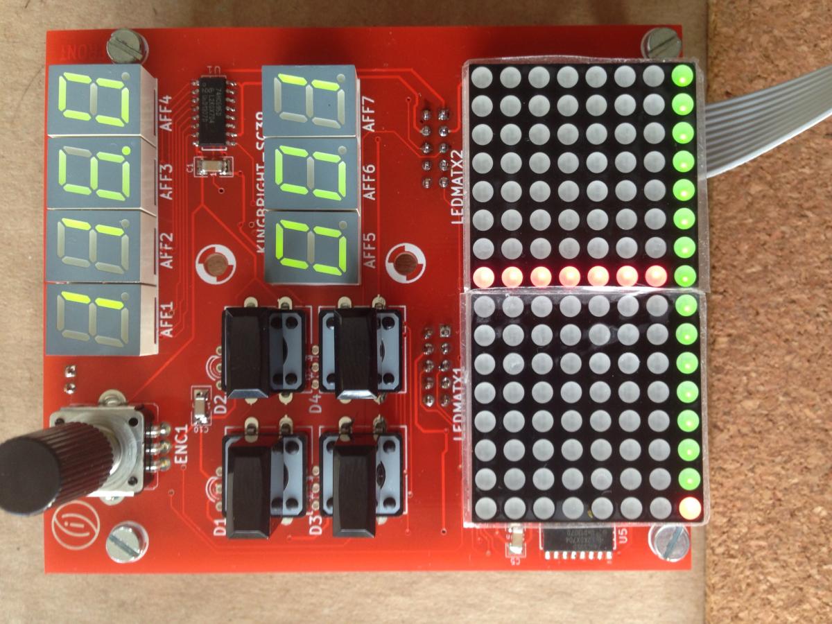

I’ve just built a TPD for my MBSEQ and have a problem with one of the Red LED columns.
The first colum of Red LEDs on the the righthand LED matrix are always on, apart from the bottom one. Strangle, when I power on the device and the text scrolls across the matrix the problem isn’t there.
I’m guess the problem is caused by a short/open connection somewhere but I really don’t want to remove he LED matrix unless I have to.
Has anyone got a idea as to where the fault could be?

Thanks for the suggestions. A & B: I’m pretty sure the the anode/cathode are correct as all the other LEDs in the matrix work correctly. C: I’m using MBSEQ 4.088 that I compiled myself, I might roll back to the offical 4.087 release and see if that makes a difference.
I’ve rolled the firmware back to 4.087 and the problem persists so I guess it must be a hardware problem.
Now I need to decide if I can live with the problem or remove the LED matrix and risk destroying the unit.

I spent some time on this tonight and I’ve fixed the problem.
Though I’m not 100% sure, I think the actual LED matrix itself was faulty. I removed the matrix and tested all the joints with a meter and everything was fine. I inserted the matrix back into the PCB without soldering it in to see what would happen and some of the LEDs in the column in question came on. As I had another LED matrix at hand i put that in the PCB and the fault didn’t occour, so I’m putting the problem down to the matrix.
I’ve now replaced both LED matrices with new/better quality units and it’s working perfectly.
