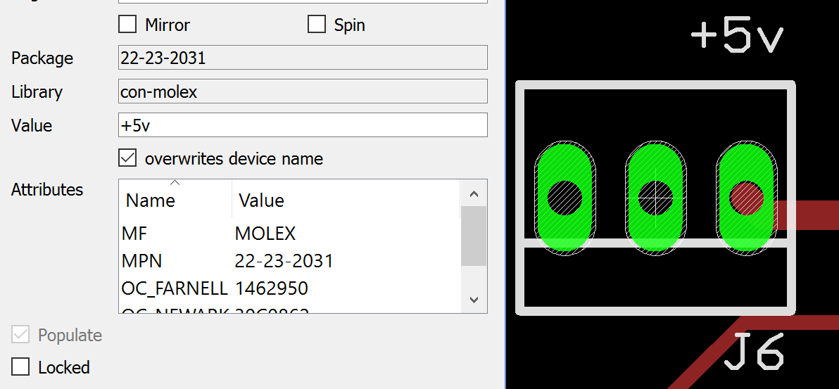

For my latest work, I include a 3-pin 100mil/2.54mm Molex header with the centre pin 0V/ground and +5V on the right when the polarity tab is at the bottom of the connector. The left pin is NC. Could we consider a standard perhaps?

All good, here is the part:
http://www.mouser.de/ProductDetail/Molex/22-23-2031/
Also available for next to nothing at Tayda:
http://www.taydaelectronics.com/connectors-sockets/wafer-housing-crimp-terminal/serie-2500-2-54mm.html
Pin 3 NC
Pin 2 0V/ground
Pin 1 +5V
Lots of edits today: it’s of course possible to use an ordinary 100mil breakaway header in place of the Molex part.

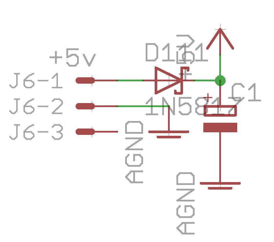

Are you sure you got the numbering right? All my Kicad libraries (also for Molex parts, though I don’t have this exact part number) start counting pin numbers from the left when the tab is at the bottom, so your pin 3 would be my pin 1!?
The EAGLE library part has pin 1 on the right as referenced to the schematic:
I can’t say how this would relate to KiCAD, but it would be great to standardise the power connector on the right relative to the polarity tab on the bottom edge.
