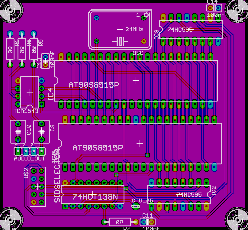

[me=nILS Podewski]fires up eagle[/me]
Quick preview of a first sketch of a possible mbSwinsid PCB:
We want a BulkOrder TDA1543 :slight_smile:
Then go organize one  :).
Best regards, ilmenator
Thanks for the PCB. I haven’t mentioned on my site that this schematic is for C64 version. It uses 74HCT138 for address decoding of each AVR from C64 bus. With MB we can remove this chip and connect CS signal directly to the MB core module as with MBSid - master CS goes to MBHP_SID:J2:SO and the second one to MBHP_CORE:J14.
Nils, right below the audio out there’s a 5x2 header labeled U$2.  Is that where the money goes in?
I would use a PCM1725 instead of TDA1543 - availablility and quality are significantly better
Hahaha, yeah, that’s the donation deposit header ;D
Will look into that, thanks.
PCM1725: TI says Not Recomended for New Designs and suggests using the PCM1754 instead (which is only available in SSOP package :-/)
Farnell also doesn’t stock them anymore. findchips.com lists several sources for the US but with a quick search I found no supplier in Germany.
well at voti.nl they still sell the desired TDA1543 for 2,50 Euro … so where is the problem?
This DAC is also used in some external CD Player DAC Projects for it’s good Sound also look on Ebay the sell DAC-Kits with this Chip for xxxx Euro Prices very heavy…
So I bougth some pieces from voti with no problem at all, fast shipping too…
And also very easy to connect, with other DA you need extra clock and parts and so on…
