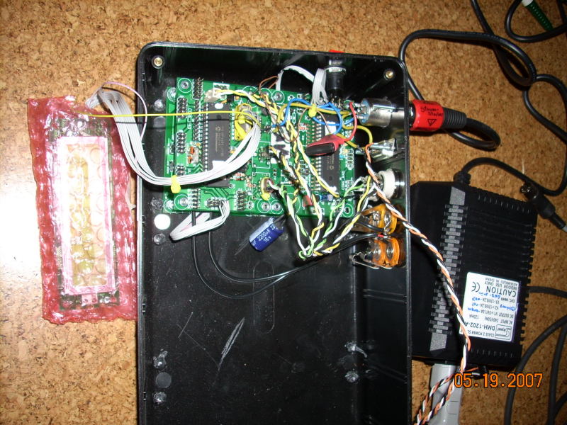

I’ve finished one SID and one Core of my dual-SID, I’ve loaded the SID testtone-app on my master-Core, switched it on and after 2 seconds of a (nearly) pure triangle-wave, I heard another strange sound.
As it’s very difficult to describe this kind of question, I’ve attached 2 pics and an audio-file.

3 either the releasing of the power switch or the Relais which switches the 12V-line. (black box on the                                  picture)

I’m using the black powersupply you can see at the picture.

it’s a “Skynet DMH-1202-A” “class 2 power supply”.
I’ve bought it at pollin.de.
it offers
+5V (1A)
+12V (0,2A)
-12V (0,2A)
and 2 other lines. I don’t know how you call them in english.
there is a normal “minus” (Vs) wire and another wire that is connected directly to ground (earth, green/yellow cable).
I think that the powersupply is just the reason for the 50Hz-buzz and the usual (white? pink?) noise.

I tried something different (see attachment).
result: No noise  :smiley:
