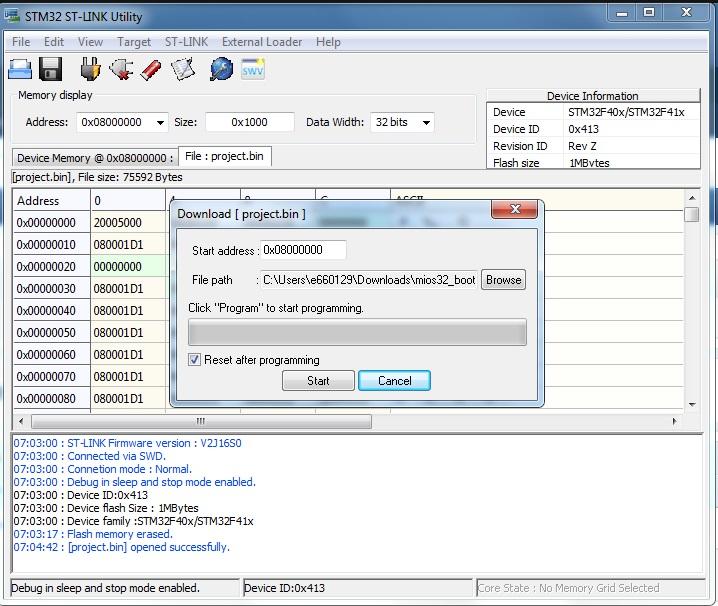

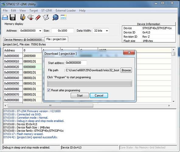

I used the precompiled bootloader from the post above and flashed it using CoFlash (using Windows and did not find any other software to flash the binary).
I am powering the board from PC using the STM link USB interface and then connect the board to the PC using the micro USB connector on the board.
I get  a USB device not recognized message and MIO studio does not see the board.
I am probably missing something obvious but did not figured out yet!!!

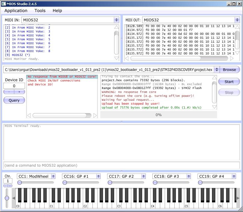

I was able to flash the bootloader with Coocox on my STM32F4, but I am having problems with mios studio.
I am able to get MIOS32 MIDI : IN and OUT. But i get this:
No response from MIOS8 or MIOS32 core!  next to device ID. I was wondering if you stumbled upon this problem, and how you fixed it.

Same problem as Nhile:
MIOS studio sees MIOS32 IN/OUT but does not connect.

I just flashed the .bin that TK posted using the st-flash utility from the stlink package, and then uploaded the firmware with MIOS studio as normal. This is all on Linux. I don’t use any IDEs so I don’t know how it’s done, but with st-flash it’s just
$ st-flash write project.bin 0x08000000
(where 0x08000000 is the memory offset where the internal flash starts, as per the STM32F4 datasheet)
After that, I reboot the board and it shows up as a MIDI device (make sure you connect both USB ports to your computer).
Thanks for your support
I used the STM32 ST-LINK utility which provides a GUI but does the same as the line command.
This is weird since everything else seems to work.
I have ordered a new board just in case it is a HW problem.
Already posted by nihle in another threat… HW problem with STM32 board.
Everything works like a charm with new board.
Now back to implementing the 3 keyboard MIDI/USB interface with MIOS32 :slight_smile:
You are spreading your questions to too many (unrelated) postings - I’m sure that this will confuse other users in future.
USB MIDI is currently only tested under MacOS, where it’s working stable. I haven’t checked this under Windows yet, this could be the reason why it doesn’t work (the new USB driver provided by ST is very different compared to the one used for STM32F1xx)
One reason for the failure under Windows could be, that you’ve to re-plugin the USB MIDI cable, and thereafter restart MIOS Studio, after the bootloader has been installed.
