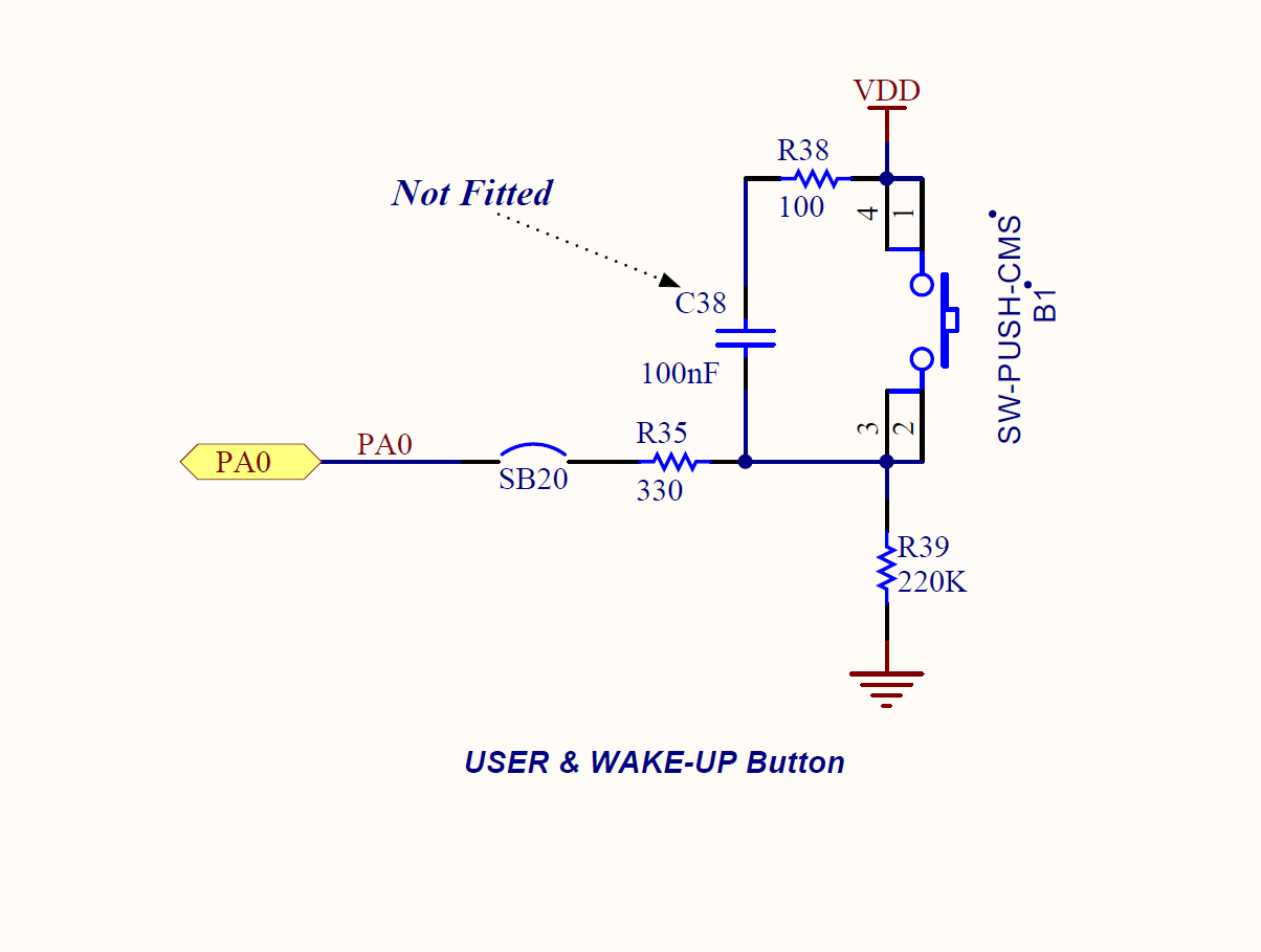

hi i cant find in the documentation/remember/no-search-results: which pin on the discovery board i have to solder a cable and a switch, to get into boatloader mode with a switch from the outside of without opening the midibox…

PA0, or you can buy a Core from me, there you get the pins on a separate header ![]()
to gnd or to 3.3v?

Just replicate this functionality:

so pa0 to 3.3v then -thnx
