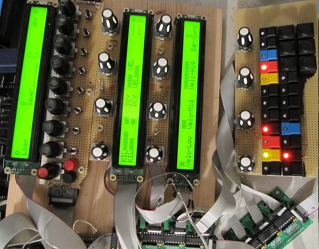

but now to the SEQ-ONLY - UI, 2x 2x40LCDs 8 Encoders 20BTNs, 20 LEDs 4 BTN States

because i have to mount the Button-PCB anykind, the best solution is to solder the Encoders on this board, and screw the encoder on the frontpanel…
so i will use one Display, when i then move a encoder, the labeling and value will go to ENCODER MODE, when i press a button the the labeling goes to BUTTON-VIEW:

update
| Drum-Step-Sequencer UI |
|   | ENCODER-PAGE 0 |   |
| ENC Value | ||| | ||| | ||| | ||| | ||| | ||| | ||| | ||| |   |   | ||| | ||| | ||| | ||| |   |   |   |   |   |   | ||| | ||| | ||| | ||| | ||| | ||| | ||| | ||| |   |   |   |   |   |   |   | 2 | B | A | R |   | 2x40LCD |
| ENC Label | V | E | L | O | - | L | O | W |   |   | V | E | L | O | - | M | I | D |   |   |   |   | V | E | L | O | - | H | I |   |   |   | B | A | R | - | S | Y | N | C |
|   | ENCODER-PAGE 1 |   |
| ENC Value |   |   | 0 |   |   |   |   |   |   |   |   |   |   | 2 | 0 |   |   |   |   |   |   |   |   |   | 9 | 6 |   |   |   |   |   |   |   |   |   |   | 9 | 6 |   |   | 2x40LCD |
| ENC Label | M | a | i | n | D | e | l | a | y |   | S | w | i | n | g | 1 | 6 | T | H |   |   | S | w | i | n | g | 8 | T | H |   |   | S | w | i | n | g | N | o | r | m |
| CharPosi | 0 | 1 | 2 | 3 | 4 | 5 | 6 | 7 | 8 | 9 | 10 | 11 | 12 | 13 | 14 | 15 | 16 | 17 | 18 | 19 | 20 | 21 | 22 | 23 | 24 | 25 | 26 | 27 | 28 | 29 | 30 | 31 | 32 | 33 | 34 | 35 | 36 | 37 | 38 | 39 |   |
| ENC |   |   |   |   |   | P | A | G | E | 0 |   |   |   |   |   |   |   |   |   |   |   |   |   |   |   |   |   |   |   |   |   |   |   | 2 | 0 |   |   |   |   |   | ENC are mount with screw-nuts |
|   |   |   |   |   | C | C | 1 | 7 |   |   |   |   |   |   |   | 1 | 8 |   |   |   |   |   |   |   |   |   | 1 | 9 |   |   |   |   | 2 | 0 |   |   |   |   |   |
|   |   |   |   |   | P | A | G | E | 1 |   |   |   |   |   |   |   |   |   |   |   |   |   |   |   |   |   |   |   |   |   |   |   |   |   |   |   |   |   |   |
|   |   |   |   |   | 2 | 1 |   |   |   |   |   |   |   |   |   | 2 | 2 |   |   |   |   |   |   |   |   |   | 2 | 3 |   |   |   |   | 2 | 4 |   |   |   |   |   |
|   |   |   | Stop | Play | REC | STEP | SWING | TM-rout | TM-CC |   | 1 |   |   | 2 |   |   | 3 |   | Bar/Main | Shrt/Lon |   |   |   |
|   |   |   | TRANSPORT | MATRIX MODES | STEP VELOCITY | Sync | Loop |   |   |   |
| BTN + LED |   |   |   |   |   |   |   |   |   |   |   |   |   |   |   |   |   |   |   |   |   |   |   |   |   |   |   |   |   |   |   |   |   |   |   |   |   |   |   |   | BTN are on same PCB as ENC |
|   |   |   |   |   |   | 0 |   |   |   |   |   |   |   |   |   |   |   |   |   |   |   |   |   |   |   |   |   |   |   | 1 |   |   |   |   |   |   |   |   |   |
| BTN + LED |   |   |   |   |   |   |   |   |   |   |   |   |   |   |   |   |   |   |   |   |   |   |   |   |   |   |   |   |   |   |   |   |   |   |   |   |   |   |   |   |   |
|   |   |   |   |   |   |   |   |   |   |   |   |   |   |   |   |   |   |   |   |   |   |   |   |   |   |   |   |   |   |   |   |   |   |   |   |   |   |   |   | Page |
|   |   |   | Direction | Enc | —SPARE— |   |   |   |   |   |   |   |   |   |   |   |   |   |   | Focus |
|   |   |   | < | > | <> | Page |   |   |   |   |   |   |   |   |   |   |   |   |   |   |   |   |   |   |   |   |   |   |   |   |   |   |   |
|   |   |   |   |   |   |   |   |   |   |   |   |   |   |   |   |   |   |   |   |   |   |   |   |   |   |   |   | Cpy |   | Past |   | Clr |   |   |   |   |   |   |
|   | Copy, Paste, Clear and other Execution Buttons have no LEDs and are placed seperately |
