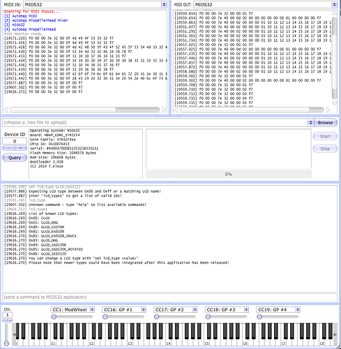

In order to select the display in MIOS32, upload the Bootloader Update Application and enter:
set lcd\_type GLCD\_SSD1322 set lcd\_num\_x 1 set lcd\_num\_y 1 set lcd\_width 256 set lcd\_height 64 store
Thereafter upload the MIDIbox NG application again -> display should show some meaningful messages

 i can’t fide GLCD_SSD1322
Ok, I’ve to admit that I haven’t checked the current state of the driver before my reply
Unfortunately it isn’t available - last posting about this activity was more than 10 years ago:
< base_url >/topic/16692-ssd1322-driver/?do=embed&comment=146873&embedComment=146873&embedDo=findComment#comment-146873
I fear that nobody can help you to get it running :frowning:
