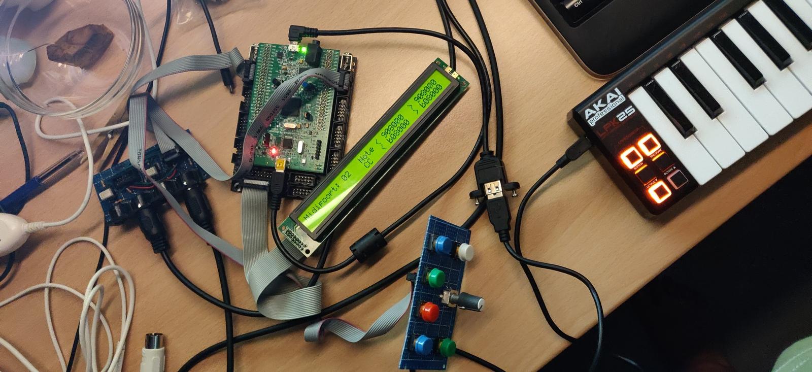

Hi all, my first NG-project is alive :wink: I build a switchable USB to 4 DIN midi port router. Al from parts I have laying around. After a evening digging this forum and trying, it just works. Now I can control my Volca’s with a single USB midi keyboard (hurray).

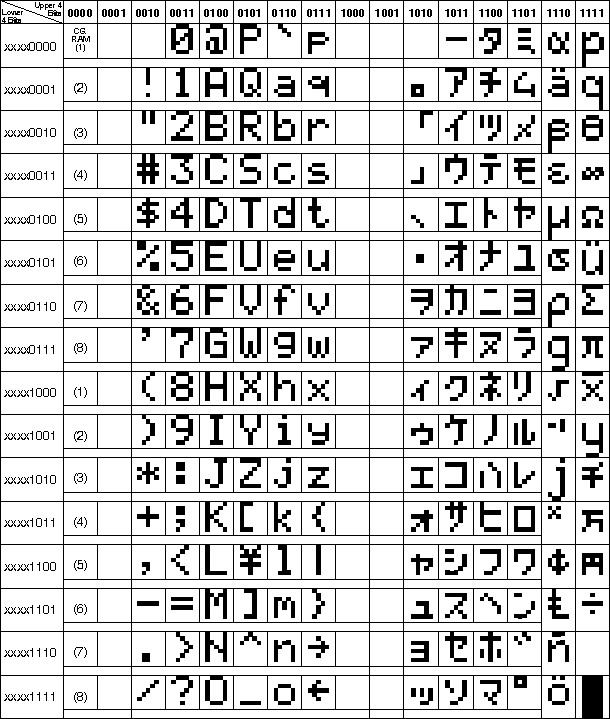

I don’t get one thing: How do I get special characters on the display??
For example in the next line I like to have a arrow instead off the >-sign (or the solid >)
EVENT\_SENDER  id=1   if\_equal=Button:1:1  fwd\_to\_lcd=1  type=NoteOn chn=1   key=any  lcd\_pos=1:32:1  label="\> %e"  ports=00001000000000000000 [17:36]
Is this possible with NG?

What he wants is to print arrow for example, from the built-in char set.
With MIOS function it’s very easy, using Char Print and code number.

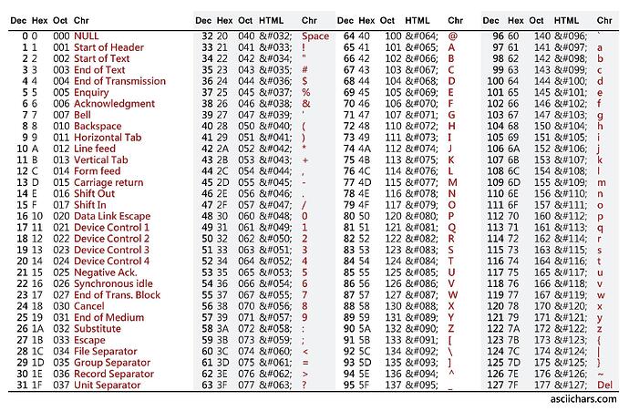

With NG it seems only string are possible. But according to the C ascii table.
the ‘left arrow’ code 0x7e is “~”, so using:
label="~ %e"
works. But for the ‘right arrow’ the ascii code 0x7f correspond to DEL, which is not usable in a string.
Is there a way to print a label using ascii code instead of string in NG?
