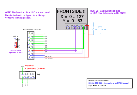

I wired up my 7pin SPI 1306 according to this diagram using 1k res and 10u cap.

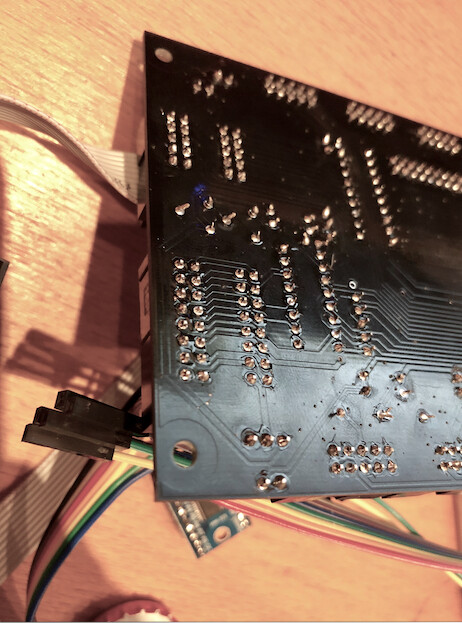

i tried doing some measurements. core board soldering seems ok. power/ground voltages are also where i think they’re supposed to be everywhere.

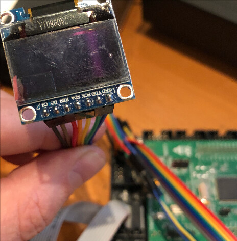

more pictures of my “circuit”

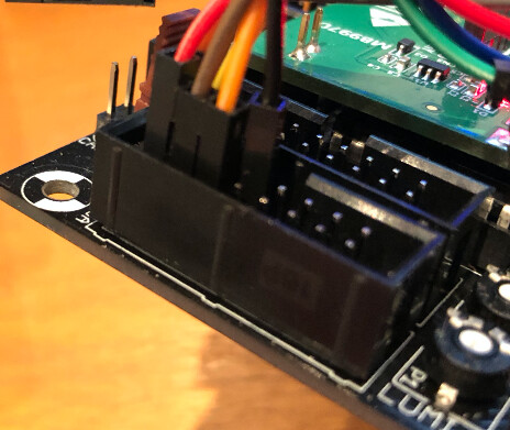

i realized in the above picture the SDA cable was in p4 instead of p6, that was not the issue though.
OLED supposed to work on 2.8-5.5v, i tried both 3.3 and 5v jumper settings.

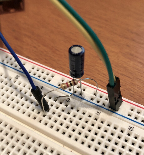

GND and VCC from both j15 and the OLED going to the power strip on the breadboard, and the blue wire to the reset pin.

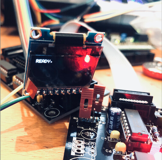

well after a million tests and power cycles yesterday i just turned on my main system power supply this morning and got this
so consider this case closed.
