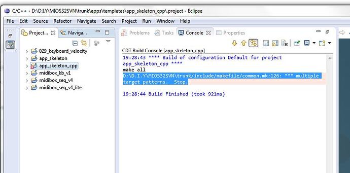

I followed the Mois32 toolchain without problems
and now i want to built the app_skeleton_cpp project but Eclipse gives me this error
D:\D.I.Y\MIOS32SVN\trunk/include/makefile/common.mk:126: *** multiple target patterns. Stop.
what coudt be the reason?
Thanks for any advice.
Best regards Marxon

But i have version 3.81.
Hi again,
the multiple target problem is fixed :slight_smile:
I changed my Eclipse´s build enviroment variables to
MIOS32_PATH
/D/D.I.Y/MIOS32SVN/trunk
MIOS32_BIN_PATH
${MIOS32_PATH}/bin
In my case i stored the content from the svnmios.midibox.org/svn.mios32 folder
in D:\D.I.Y\MIOS32SVN
Thanks for your advice TK!
Best regards
Marxon
