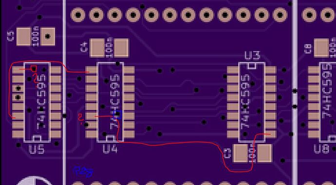

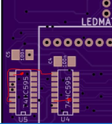

So my midibox is mostly happy, led issues sorted out, aout perfectly calibrated, BLM and TPD doing what they should, but the TPD has a problem I think may be setup related.
First up, the 4 buttons only light up at startup, and most importantly the Doutx4 after do nothing. So hardware wise that would indicate the serial chain not passing through somehow. Ive checked U5 and U9, the led matrix works as far as I can tell (two colours, counting up, and showing note on on channel) so the serial must pass through it, and U9 has been very carefully checked and changed for certainty, but neither leds light up, nor does Doutx4 work. It should not be a parts or soldering error, so pointing at setup/software. Wire might be a bit long internally, but it seems to stop at U9 anyhow.
Anyone encountered something similar? Is there any setting in the v4 itself I should check? For channel or main setup/options?
I first used my own HW file, then changed to beautyofdecays file as I basically stole his setup and I thought that might fix it.
His inserted below:
