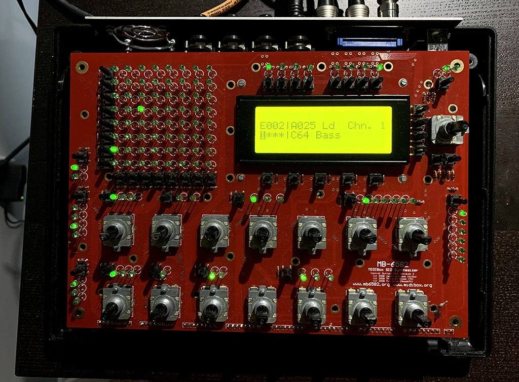

Step 4: Once you’re done with Core 1, you can test your control surface navigation, listen to the default patch sound, etc…

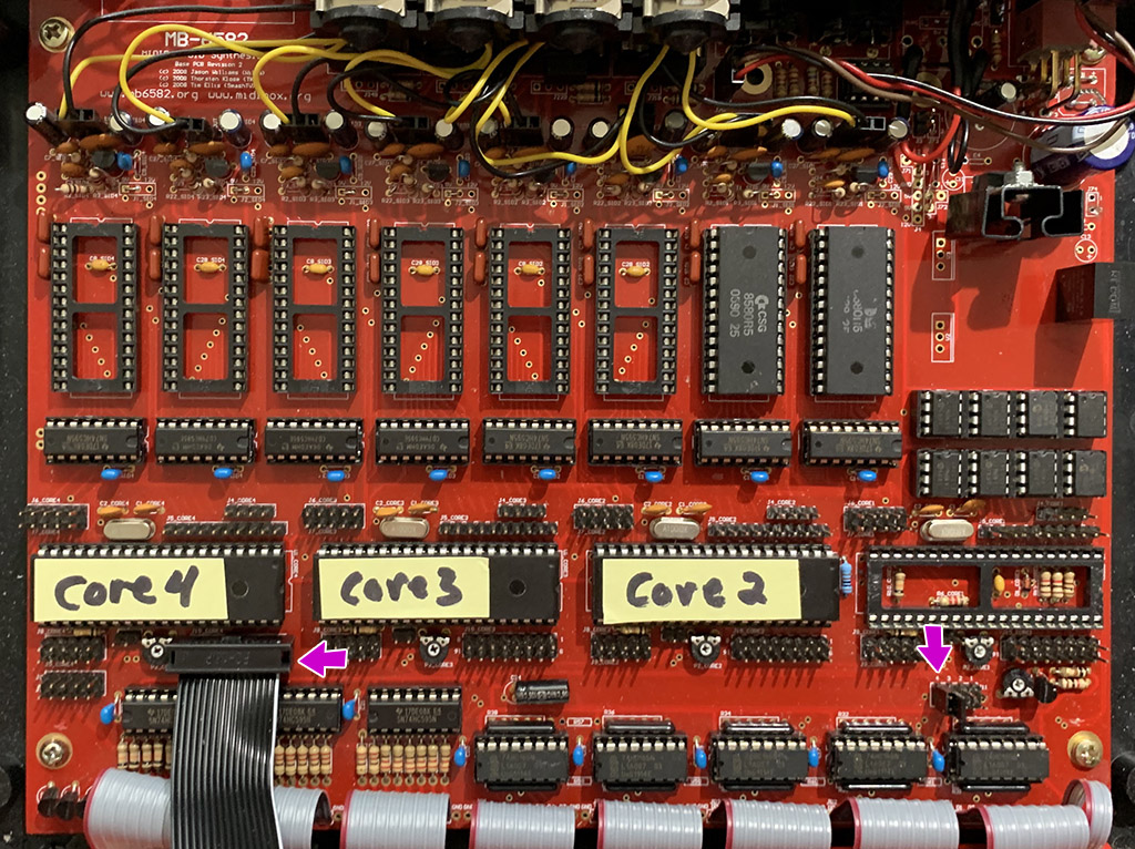

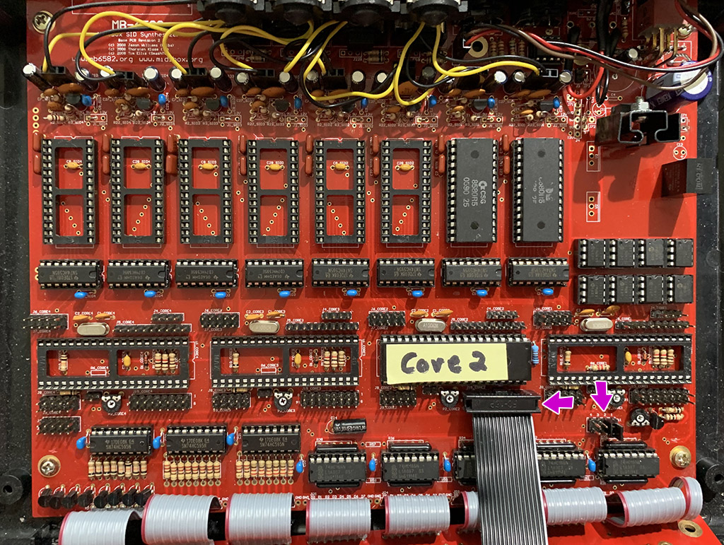

Step 6: Place the first Slave, Core 2, into its proper destination socket. You’ll need to move the J11 jumper to position 2 to enable MIDI out to come from Core 2. You’ll also need to move the LCD cable to J15_CORE2 so you can watch the screen through each update phase

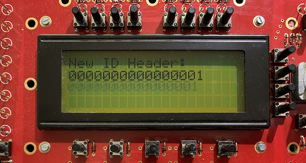

Step 7: Power up your MB-6582, MIOS should see Core 2 as Device ID 0 now. You’ll change Core 2 to become Device ID 1 by using MIOS to write the ‘device_id_01.hex’ file that comes bundled with ‘change_id_v1_9g.zip’ (available in the troubleshooting section http://www.ucapps.de/mios_download.html)
Step 8: Your device should reboot after you’ve written the device_id_01.hex. When it comes back online your LCD should show " New ID Header: 0000000000000001" - you’ve done it! MIOS should see Core 2 as Device ID 1 now

Step 10: Power down your MB-6582 and add Core 3 into its proper destination socket. Move J11 to position 3 and the LCD cable to J15_CORE3

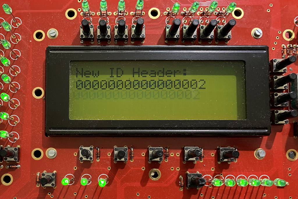

Step 11: Power up and do the same as Step 6, using MIOS with Device ID 0, you’re ready to change Core 3 to become Device ID 2. Write the ‘device_id_02.hex’ file you downloaded with the change_id package
Step 12: When your device finishes rebooting, your LCD should show " New ID Header: 0000000000000002" and MIOS should see Core 3 as Device ID 2

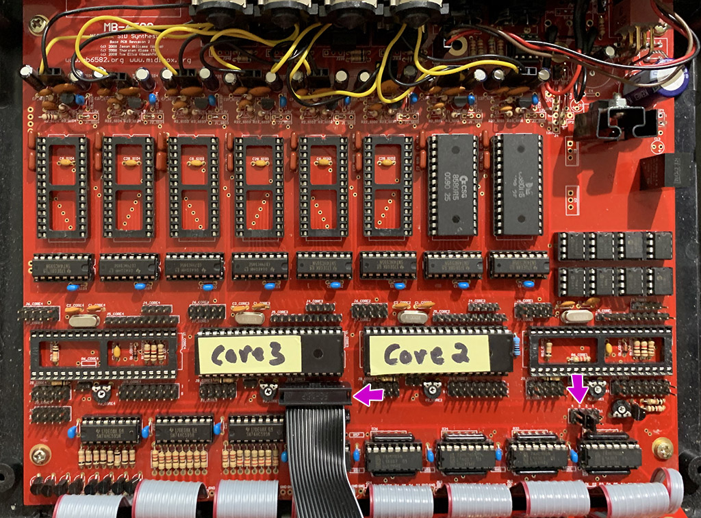

Step 14: Power down your MB-6582 again, add Core 4 into the proper destination socket, move J11 to position 4 and the LCD cable to J15_CORE4
Step 15: Power up and do the same as Step 6, using MIOS with Device ID 0, you’re ready to change Core 4 to Device ID 3. Write the ‘device_id_03.hex’ file you downloaded with the change_id package

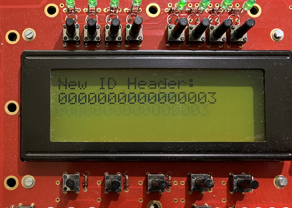

Step 16: When your device finishes rebooting, your LCD should show " New ID Header: 0000000000000003" and MIOS should see Core 4 as Device ID 3

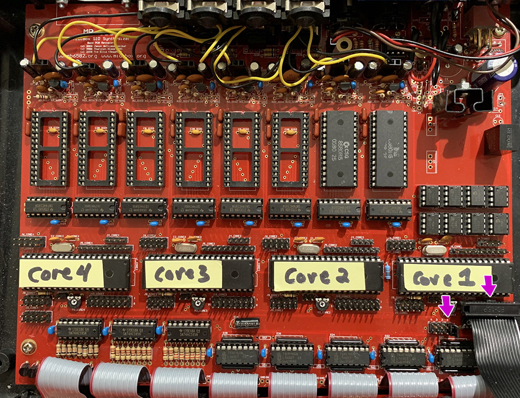

Step 18: Power down your MB-6582, add Core 1 back into its lonely socket, move J11 to position 1 and the LCD cable to it’s permanent home on J15_CORE1

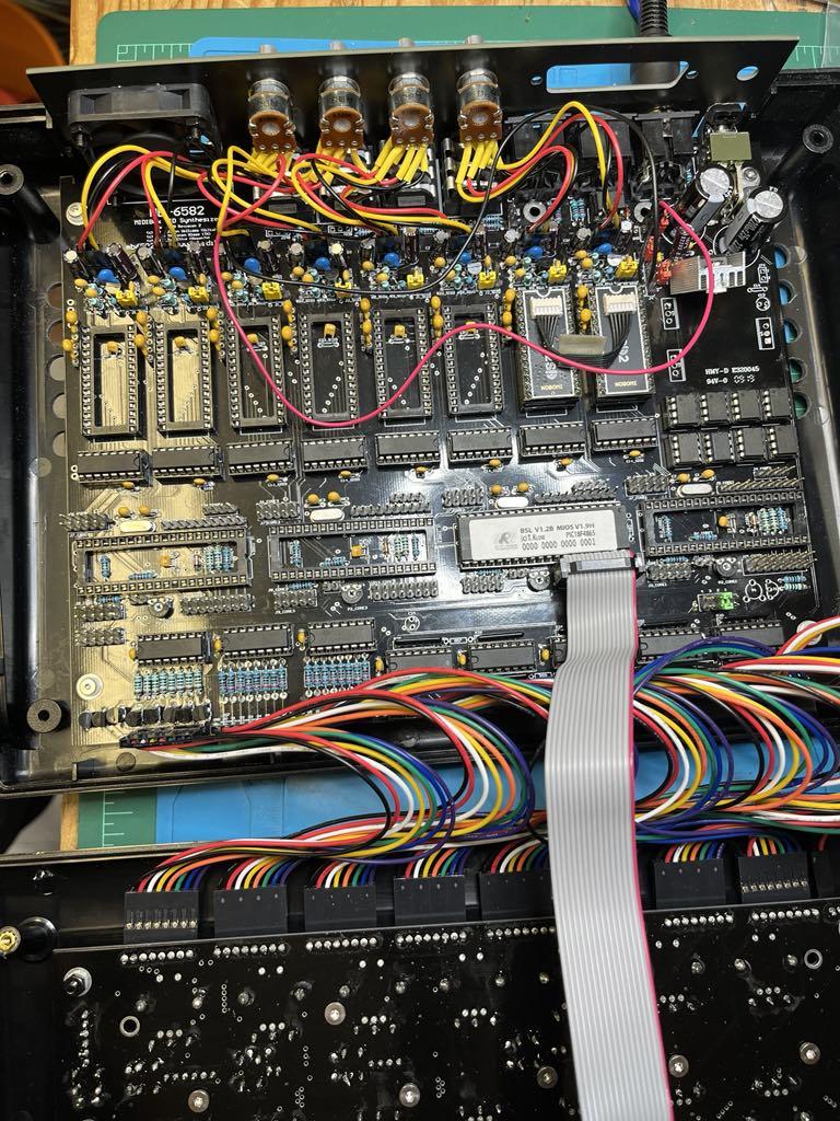

I’ve identified the issues. Initially, I forgot to install a resistor, potentiometer, and capacitor.  I was too hasty after checking the voltage to bother verifying if anything was missing.
However, even after installing the missing components, I still encountered the same error: “SID(x) not available (CAN disabled)”. I then tried using a different LCD screen, which resolved the issue. I was previously using an Adafruit 499 LCD screen, which I believe operates in 8-bit mode. https://www.adafruit.com/product/499
