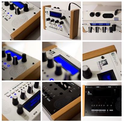

@jojolito, do you know who makes the official metal shruthi cases?
@Shuriken: Hope that’s OK with the powers that be. They’re made in Estonia by a mr Adrian Hallik. I’m unsure of the exact relationship, but I think he’s employed at a metal shop with a screen printer. I suggest you register over at Mutable and give a shout out to Adrian.
